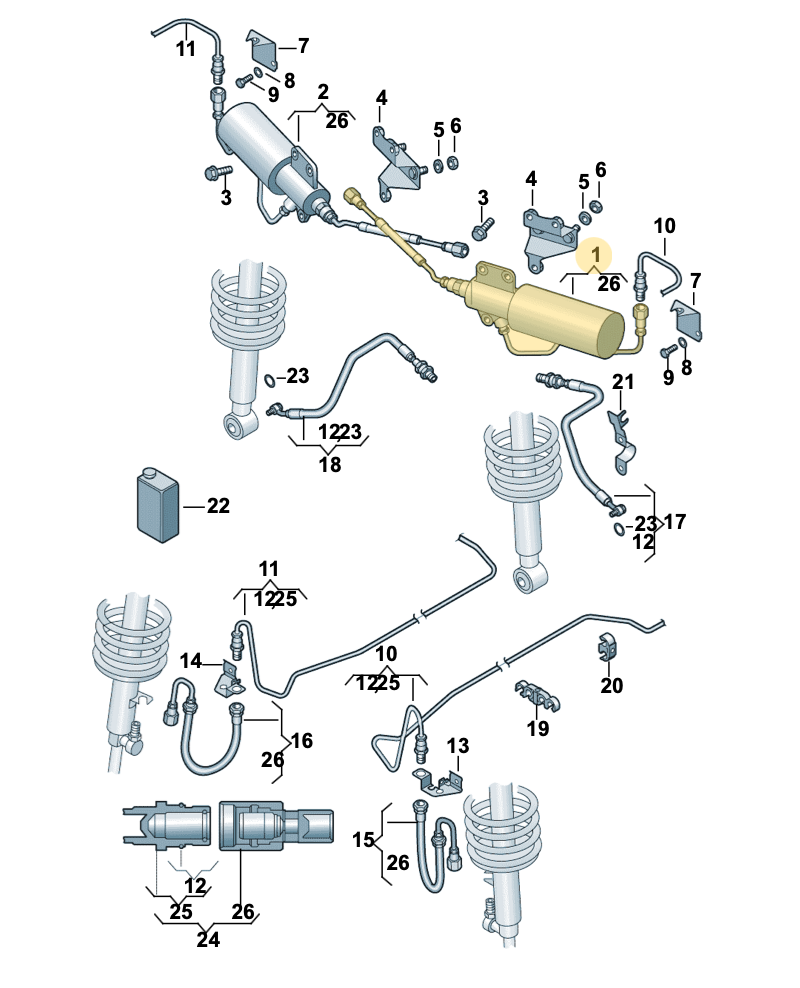

A couple of days ago I noticed a few drops of oil on the garage floor. It seems to drip from the spare wheel well. I noticed som pipes up there but was not able to locate the source.
Thanks for the drawing, that will help me identify the diferent parts and hopefully the leak.

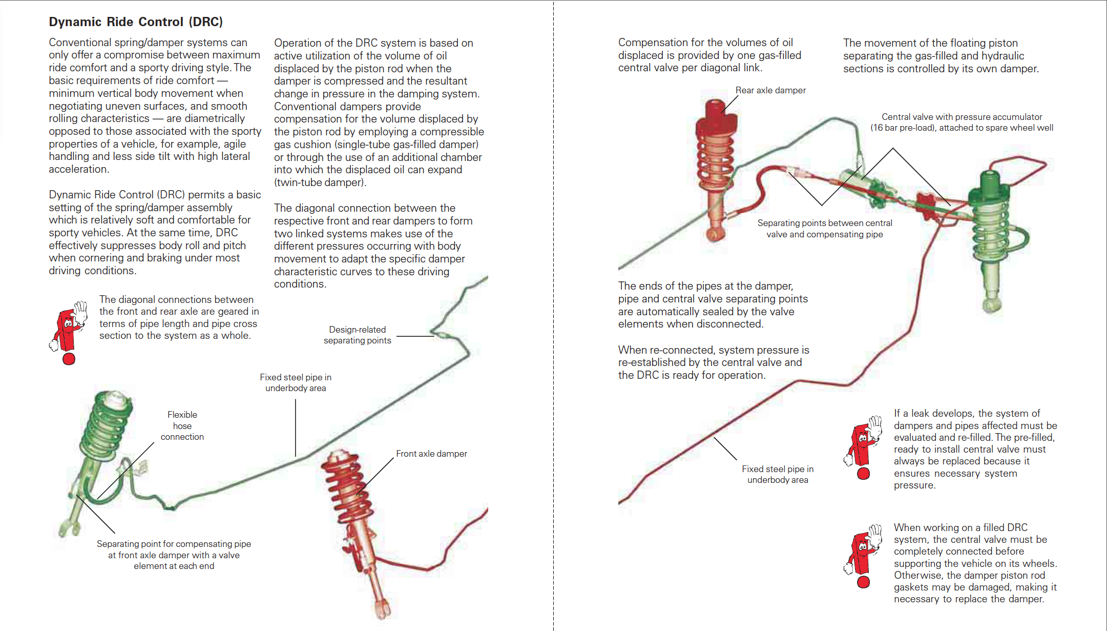

Hi RS6+RS6+ wrote: ↑Sun Feb 23, 2025 9:42 pmA couple of days ago I noticed a few drops of oil on the garage floor. It seems to drip from the spare wheel well. I noticed som pipes up there but was not able to locate the source.
I've just been waiting for the DRC to fail on my car also, and was mentally prepared to change to coilovers.
However, as my car is also completely stock I would prefer to keep the DRC if possible.
You are welcome to those diagrams
The good news for you is that all the critical components are still available new! There is a company in the UK selling 4 new shocks for £260 (crazy cheap price) and all the pipes and valves are available from Audi Tradition. It shows that you are located in Norway, so you should be able to purchase from Tradition, but if you a problem I can help and located in Finland.

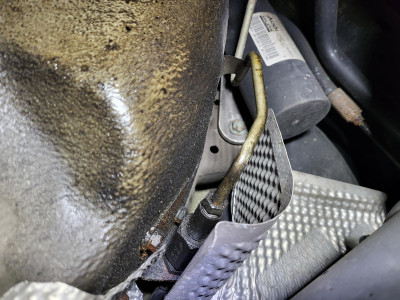

The leak is somewhere at the coupling between the pipe from the accumulator and the pipe to the front left damper (10 in the drawing). It is hard to see where the leak is. The pipe (10) is oily where it enter the coupling so it could be the pipe itself or the fittings. Hard to get access. Have to remove the LH side of the exhaust and heatshield to get access to further investigate.
I've attached a picture showing the coupling. Anyone who knows the purpose of the coupling between theese two pipes?
Measured the pipe and it is aproximately 6.5mm, which make me belive it is a 1/4" pipe. If that is correct and the fittings is of a standard type then it should be manageable to fix this.
