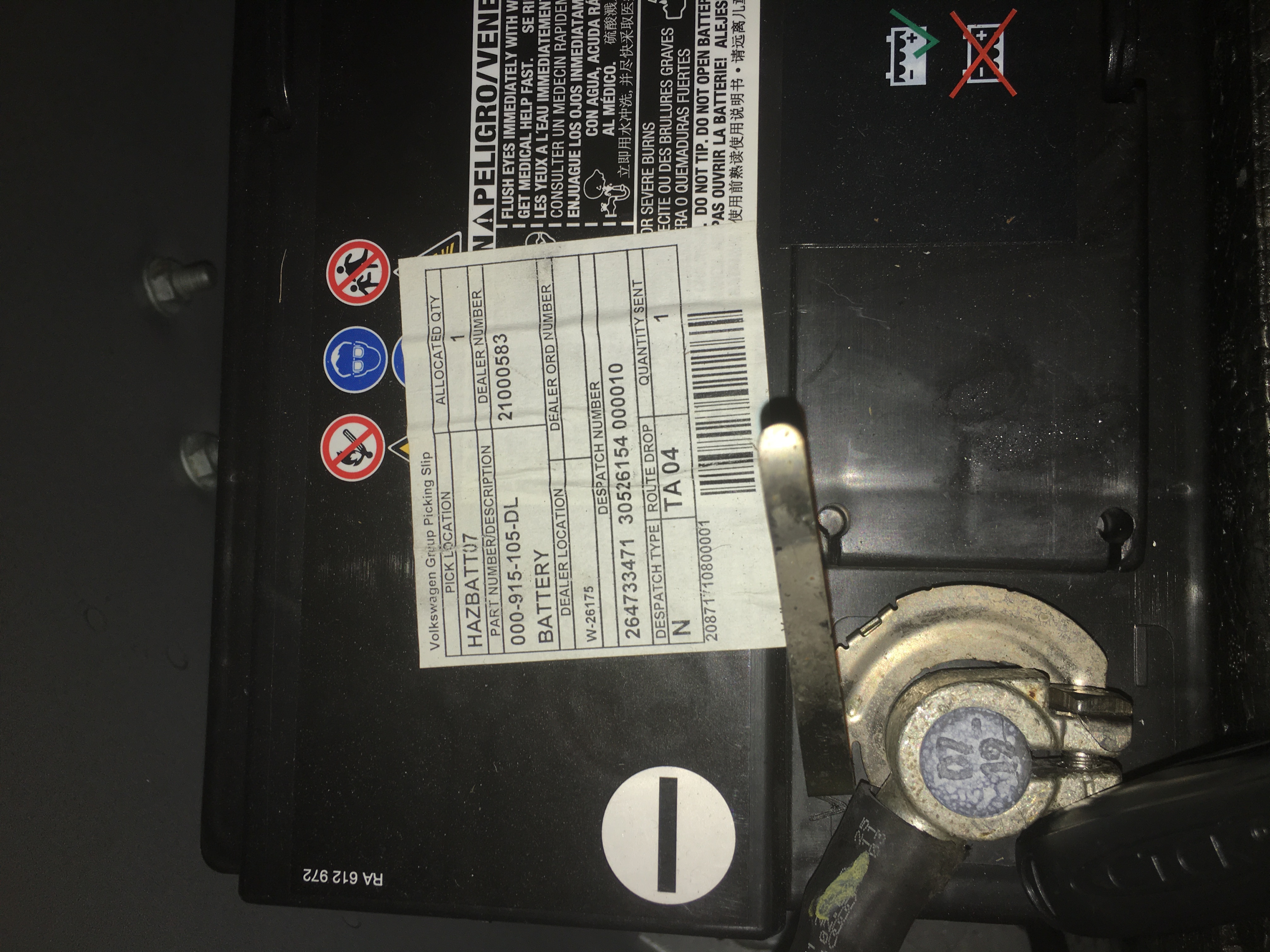

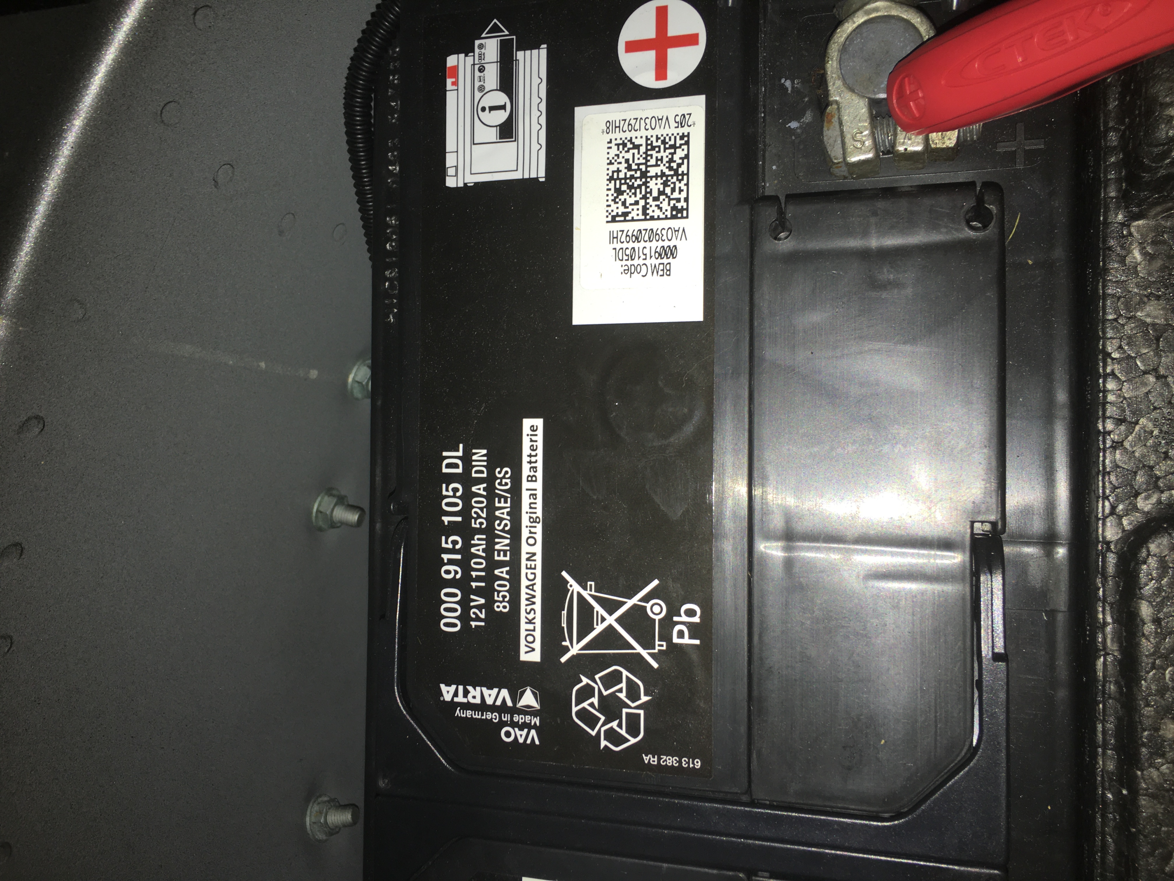

Hi all appreciate the feedback so far. I cannot confirm the original battery fitted in 2004 being Varta but certainly the last one from Audi was from this brand Craig. Pictures attached of the battery currently in position.
I have ordered a Varta battery so await delivery. As it is the RNS-D I have I suspect i will loose the radio code. The previous owner provided the code but knowing my luck that's why I was considering a memory saver as an option.
