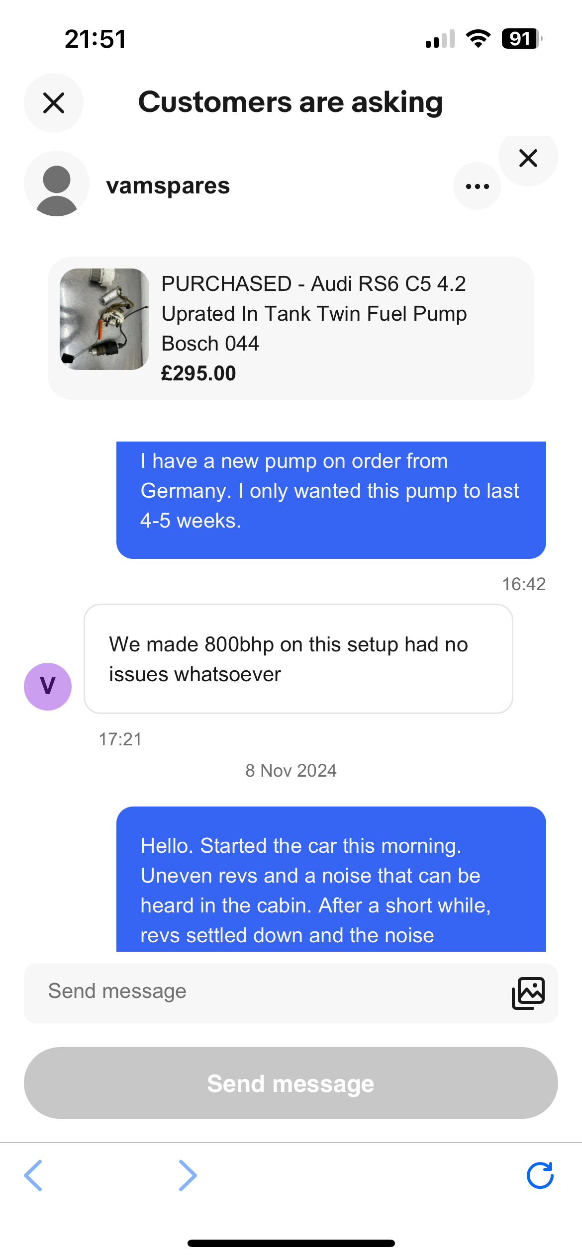

This is the second hand uprated in tank fuel pump. I only wanted the external pump but the seller wouldn’t split them. So I had to buy both.
As it turned out I am pleased I bought both. As I needed both of them.
Apparently they made 800 BHP with this setup. I was surprised that bare electrical connections are immersed in fuel.
