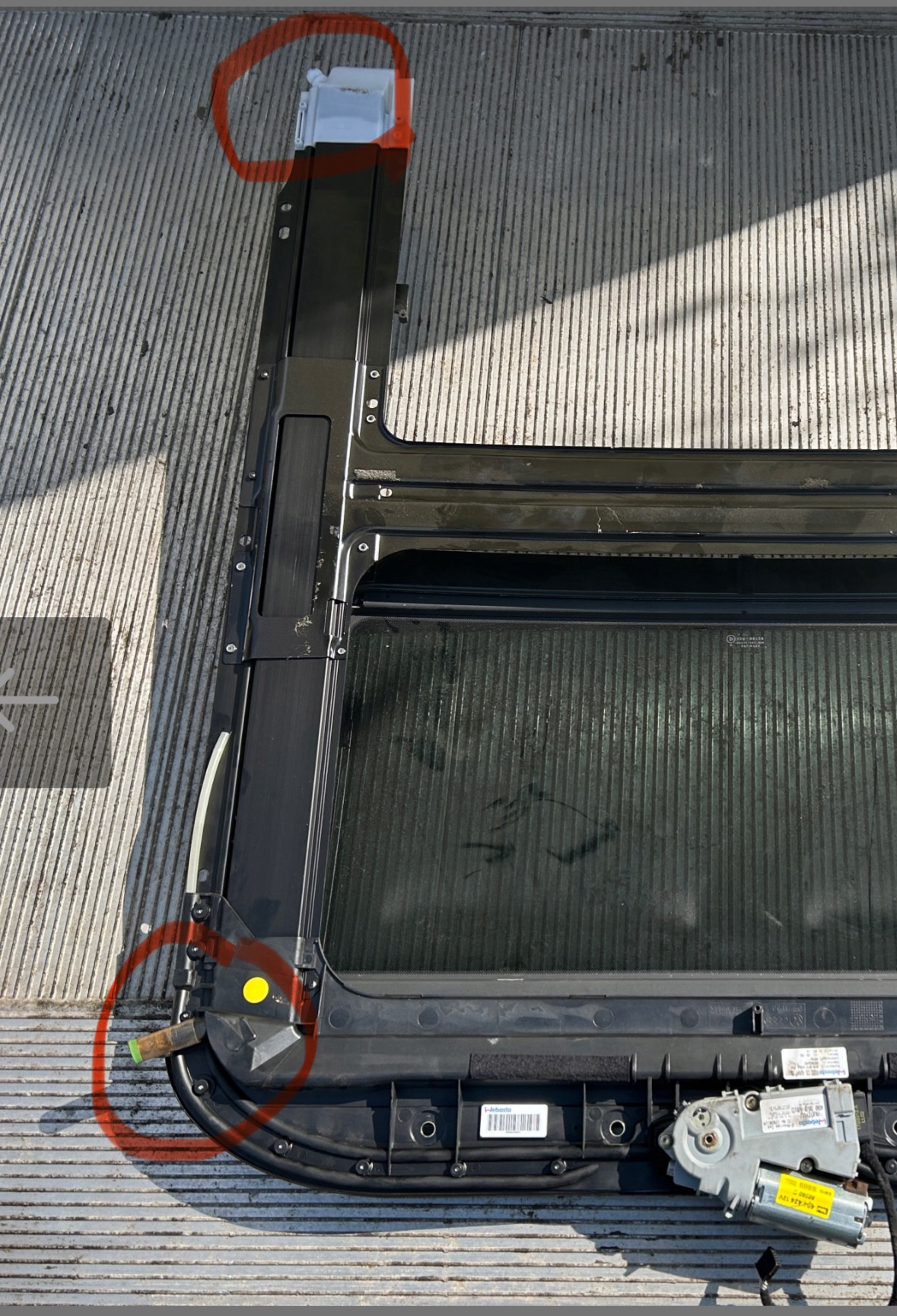

Here’s a quick photo of the sunroof from an A6 C5. Min should be the same but is a solar one (ooo errr get me
I’ve circled both the drains. Back one probably isn’t visible when looking into the sunroof. It’s got a white section with a small white tube in each corner.

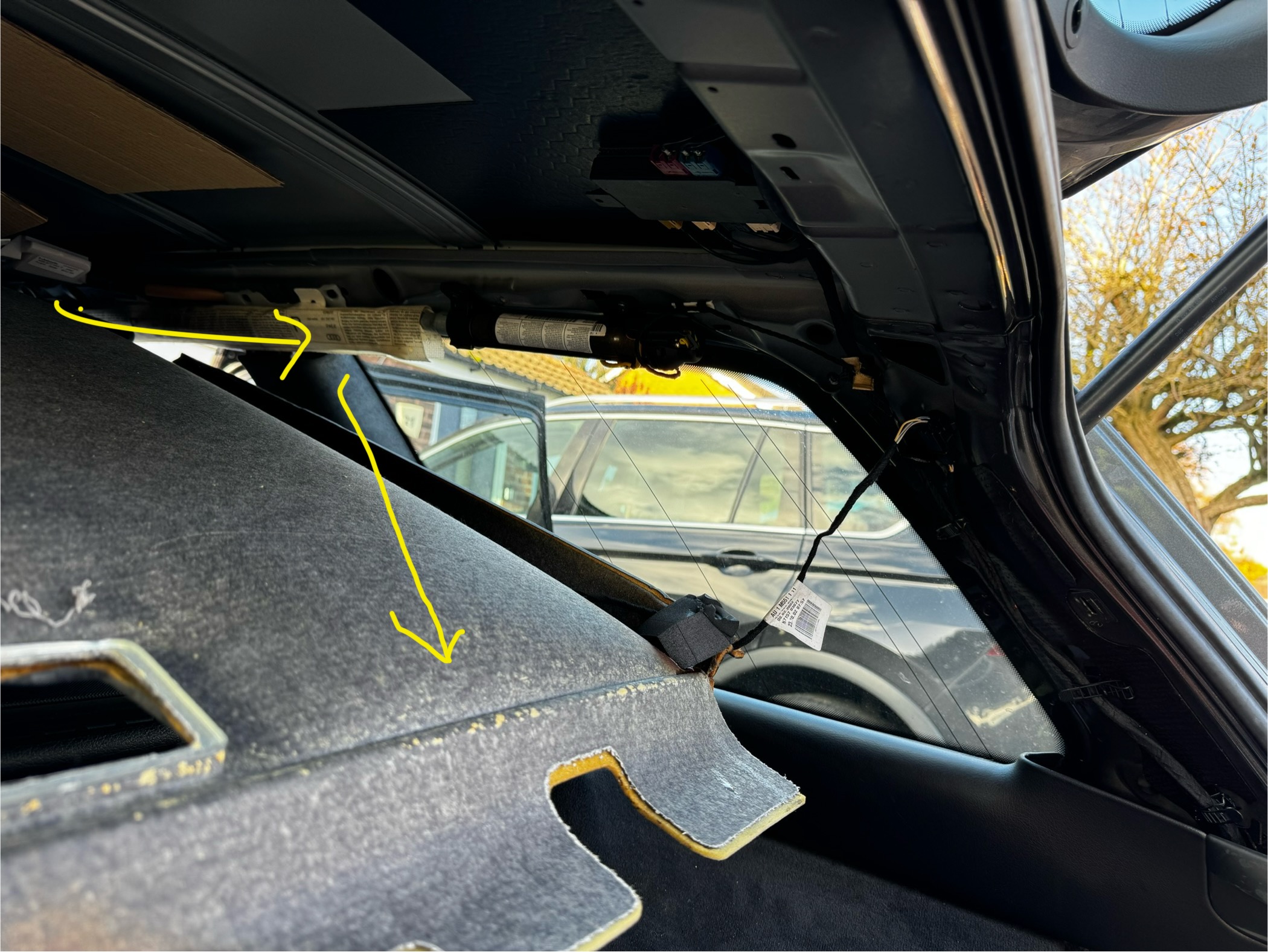

Thinking that my drains might have popped off I decided to lower the rear half of the headliner to get a cleared view.
To do this you need to remove 5 bits of interior trim. Both D pillars first. Then the rearmost trim above the boot. Then the two bits of trim over the back doors. These are all kept in with a combination of screws and clips - some pretty well hidden. They are plastic though so don’t bend them too much.
With all the removed you can pull out the boot light too and pull the headliner down slightly. This is what you’ll see.
The circled bits are the two rear drains.
As you can see the pipes disappear behind the airbags and down the C pillar. I decided to disconnect them here and run a pipe cleaner down them. After doing that water came gushing out the wheel well (from all over the place) so I must have got rid of the blockage. I tried it a few times and also ran some compressed air down. I still couldn’t locate exactly where the exit was though and the pipe cleaner had an abrupt stop about two foot down the pipe. One the joins at the drain had a teenie tiny drip so I sealed both of them with some heat shrink too.

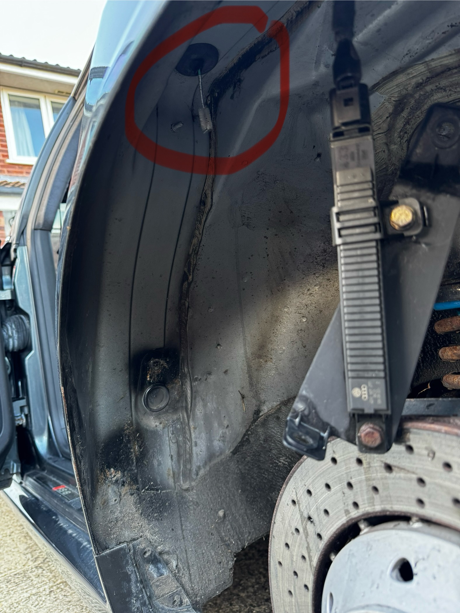

Now to find the exit. With the wheel removed I then got rid of the wheel arch liner. Still not 100% obvious (like the front ones which exit in a nice green pipe down the a pillar). Removed this bracket and the grommet is behind it. Think this is the TPMS receiver so there’s one on each side.
With this removed this is what you see.
So there you have it. Seems to drain really nice now. Ready for a storm tonight so will check tomorrow if it can cope with the rain.
