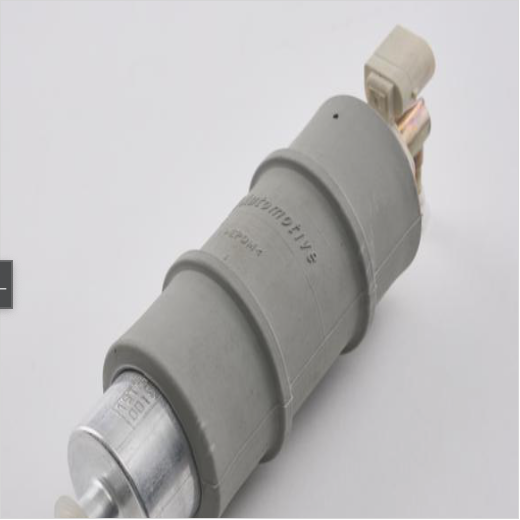

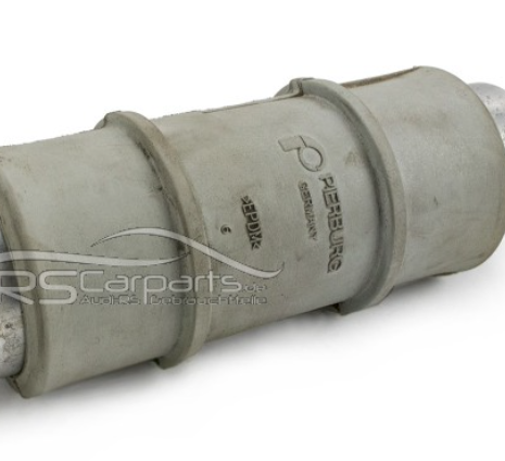

Yeah, I also was unable to find any useful info / products when looking at the TI Automotive route. I have a feeling I have seen Pierburg OE pumps, too. Maybe there was a supplier change during production.
Re: Breakdown
Yep both pump brands look very similar. I think, as Ti Automotive and Walbro merged around 2014, it's not unconceivable to think that Walbro handles the smaller pumps these days.

Yeah, agree, but you don't want to get one that's too weak (running lean at WOT) or too strong (overwhelming the regulator). So the trick is to identify the pump that rscarparts are selling.
Or maybe Steve's pump will have some interesting info on it.

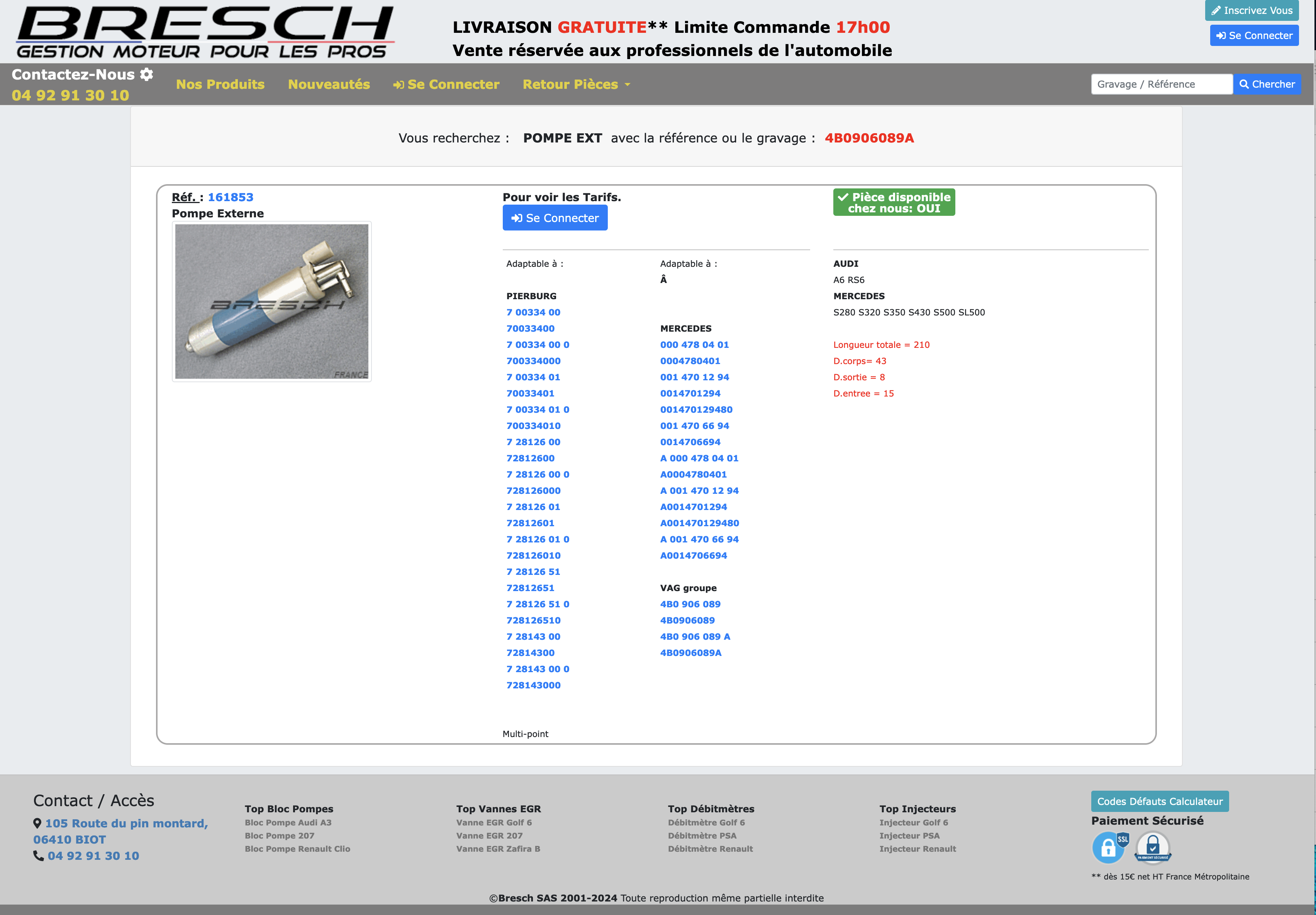

Interestingly this page has some other models that might use the same pump. Fat engined mercs.
https://www.bresch.com/POMPEEXT/AUDI/ref-4B0906089A

I once heard that the pumps on the same era AMG's (E55 etc) were the same pump. Never looked into it further though...srichards wrote: ↑Fri Oct 11, 2024 11:54 amInterestingly this page has some other models that might use the same pump. Fat engined mercs.
