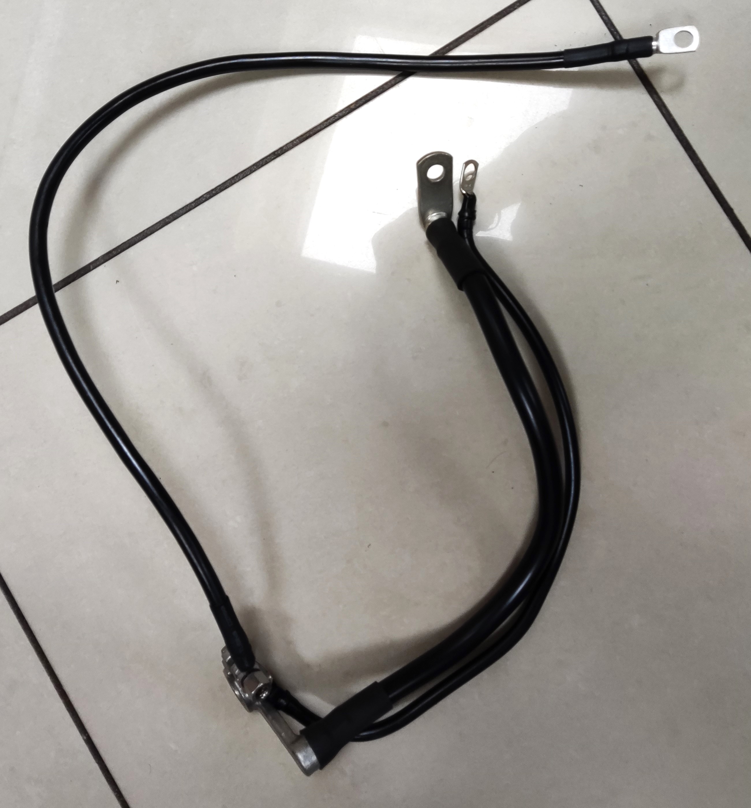

Hello,

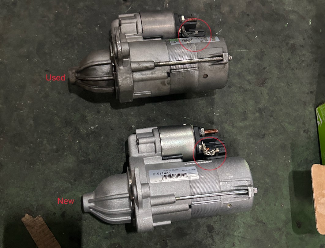

Recently, I replaced the starter motor. Previously, I had replaced the starter relay and battery for this issue, but after every 3-4 days, the vehicle still couldn't start smoothly, and the problem persisted.
This time, I handed it over to a professional technician for handling. Initially, the technician noticed this issue. He tested it by holding down the start switch button for 15 seconds before it could start smoothly. This situation seems like it needs to be preheated before starting?!
After removing the starter motor and comparing it with the new one, as shown in the figure below:
At the joint circled in red, the aging of the joint increased the resistance. The technician believed it resembled a preheating process. It seems like a resistor problem where the voltage couldn't reach the required power supply, resulting in a failure to start smoothly. There might be a problem with the starter motor or the power supply circuit to the starter motor, including the possibility of internal coil aging, etc. In any case, some components, due to long-term use, cannot operate normally, the resistance increases, and finally, it requires a process similar to preheating the circuit before activating the power supply to trigger the starter motor to operate.
Although the removed starter motor was not disassembled for inspection, the current testing after 7 days showed satisfactory starting conditions. It started smoothly with a single press of the starter motor button.
The above information is provided based on my personal vehicle condition for sharing experiences. There may also be other reasons. Each person's vehicle condition may vary. It is for reference only. I will continue to test it every week to see if there are any other problems that the technician and I may have overlooked.
Thank you.

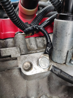

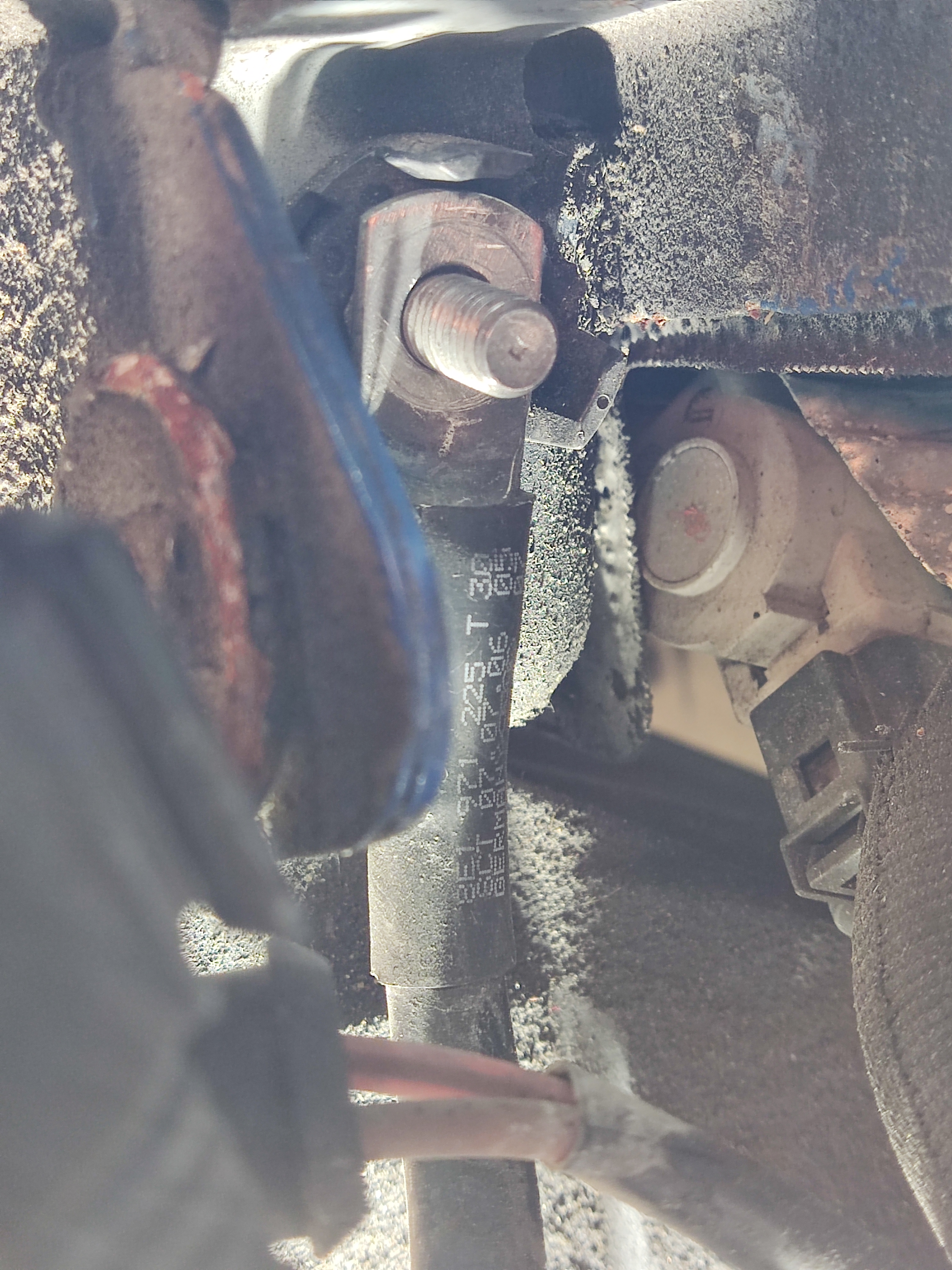

just checked the ground strap from starter to chassis, unbolted, wire-brushed, cleaned and re-tightened to ensure not loose, good contact / no resistance.

Run some additional Ground-Straps from Chassis Ground Point to either Bank / Engine Block.
Also, made up some additional Ground-Straps from Battery to Chassis.
Original Ground-Strap specced for slightly smaller batteries of the day - so these additional cables should serve to ease the current-flow / bottle-necks in the older Ground cables.
