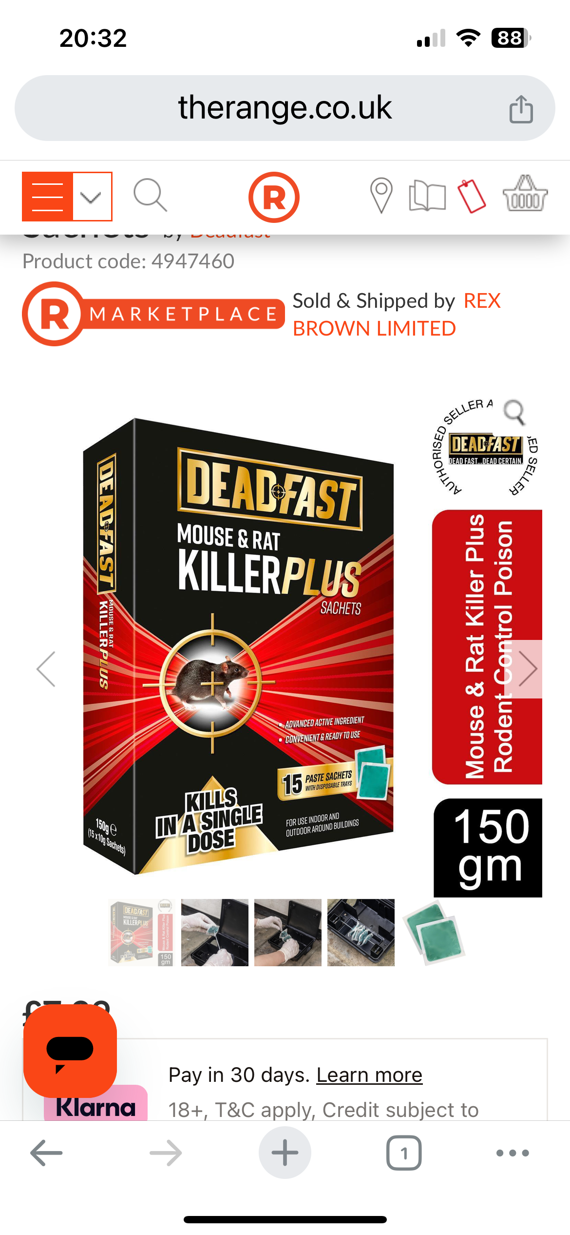

This is the stuff I use in my garage.
They seem to like it.
I use it but as you know I don’t garage my car.
