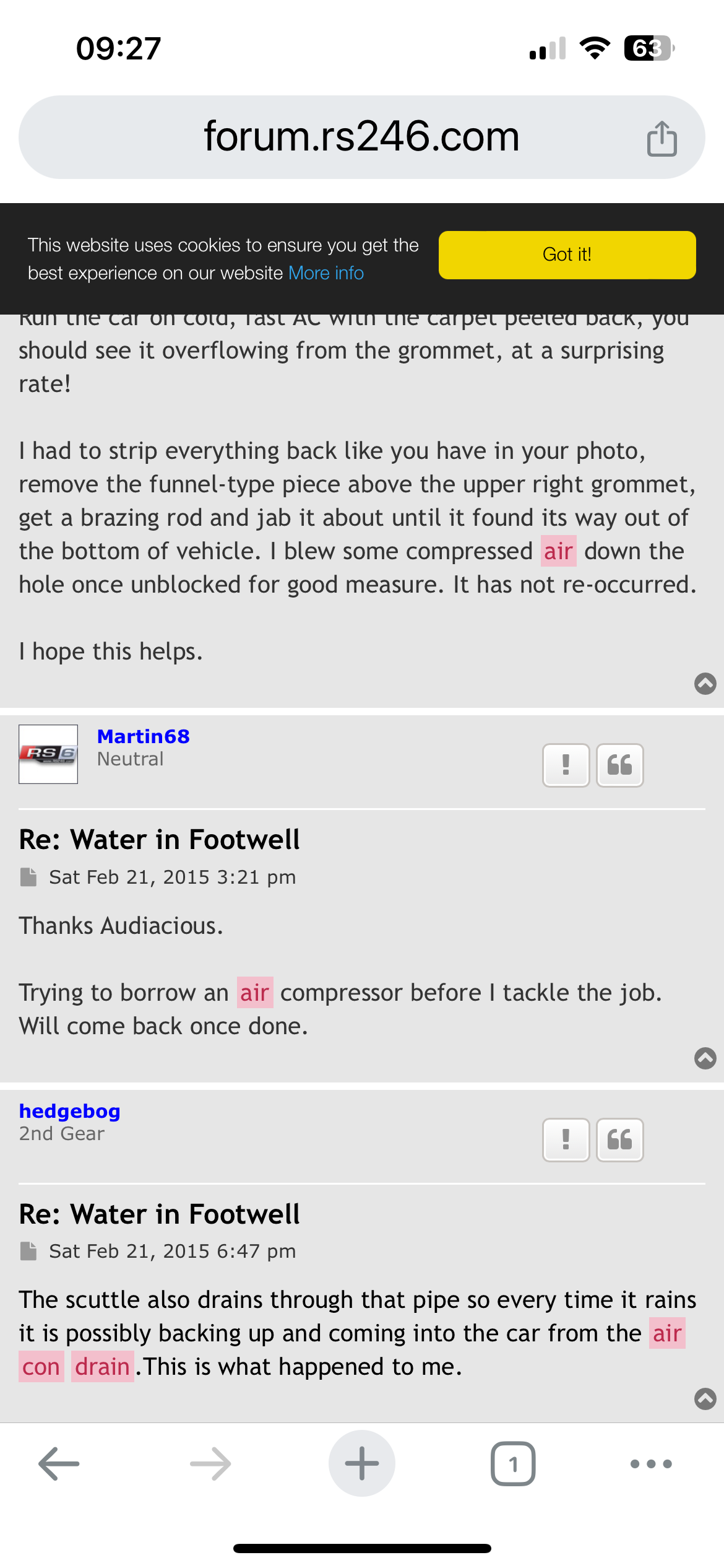

Found this old thread. It answers a question I was going to ask.
The Scuttle shares the same drain pipe as the air con.
So if I clear the air con drain that will also allow the scuttle to drain.
Can anyone confirm (or otherwise) that the a/c drain is in the passenger footwell on a right hand drive car.

Re: Carpet soaked.
Many thanks for that Ben
I thought I had two leaks. Air con drain plus pollen filter housing wet.
I still don’t get it. How water gets into the pollen filter housing.
But apparently they both share the same drain ? So with a bit of luck sorting the a/c drain will sort it out.
It will also give me the opportunity to switch the CCM. I still get lots of central locking errors.
Even more so with a wet footwell.
Although I cannot feel the wet in the front footwell. I am guessing that it is soaking further down.
So come Monday morning , hopefully will be able to get stuck into it.

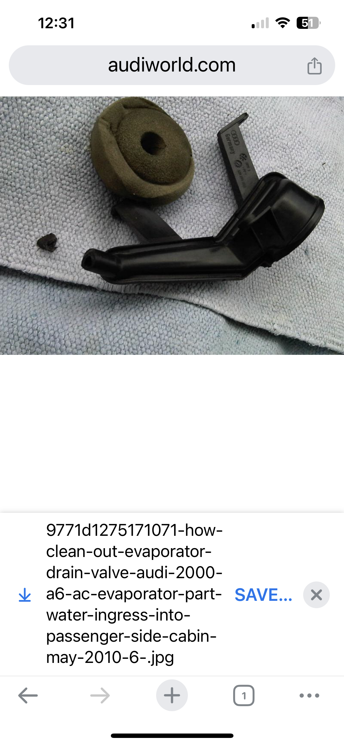

Stripped out the front carpet to get to the a/c drain pipe.
Although the front passenger carpet was dry on top. It was soaking wet underneath.
Removed the drain pipe to get at the rubber drain.
Blew it all out with compressed air.
Tested it with water that tested ok.

Just found another example of what can happen.

Air con drain pipe. Removed and checked. Rigorously blown out with air.
Poured water into the drain valve. Water ran out under the car.
Note to self. Do the water test BEFORE you blow it out with air. Otherwise you won’t know if it was blocked or not.
Mechanic believes it was a blocked drain valve as the soaking interior was confined to the passenger side of the car. I would go with this, if it wasn’t for the pollen filter housing being soaking wet.
