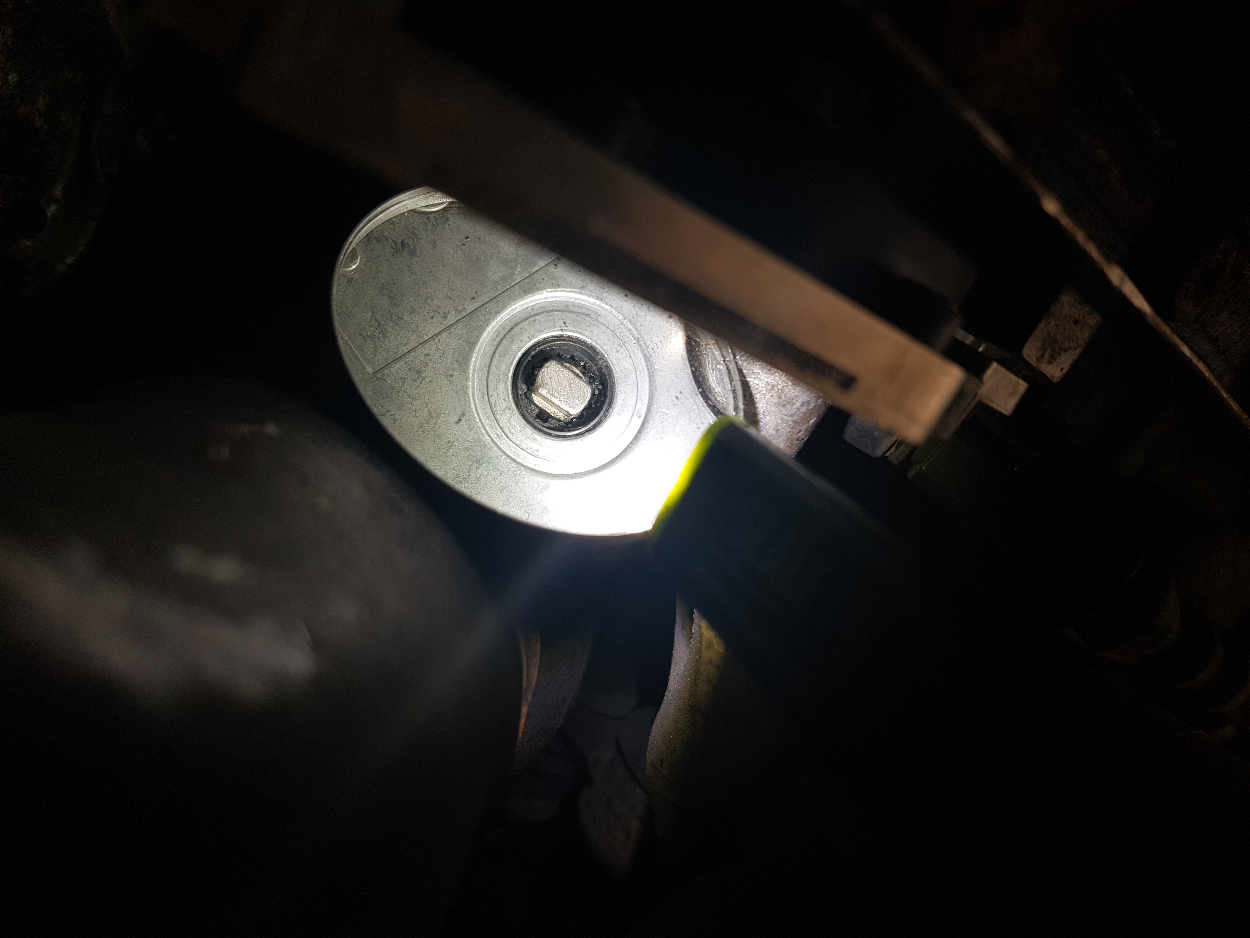

Failed the mot on a few bits, sorted them all over the weekend. Main job was to replace the F125 sensor.
I'd read a few guides and decided to take the path of least resistance as I'd already spent way too much time and effort on this car.
Had a look at the wing off the side of the gearbox mount, recip saw and a while later enough of it was off to allow the sensor to be winkled off. I also cut what was protruding past the outside of the sensor off the splined shaft. To make it shorter. Helped to get the sensor off easier. The 2 torx screws holding it on were impossible to get out with a torx bit and holder, so luckily big pair of knipex got them undone. All of it is such a crap design.
Replaced the screws with normal hex heads which means I can now use a ring spanner. Should be a 10 minute job to swap the sensor over.
I bought 2 off Aliexpress. Miscompare code has gone after fitting the new one, all seems to be working fine. Normally I'm not a fan of buying cheap components, but from reading other peoples experiences of genuine ones not lasting that long, I couldn't justify spending over 300 for one, when I could buy 2 including shipping for 60£.

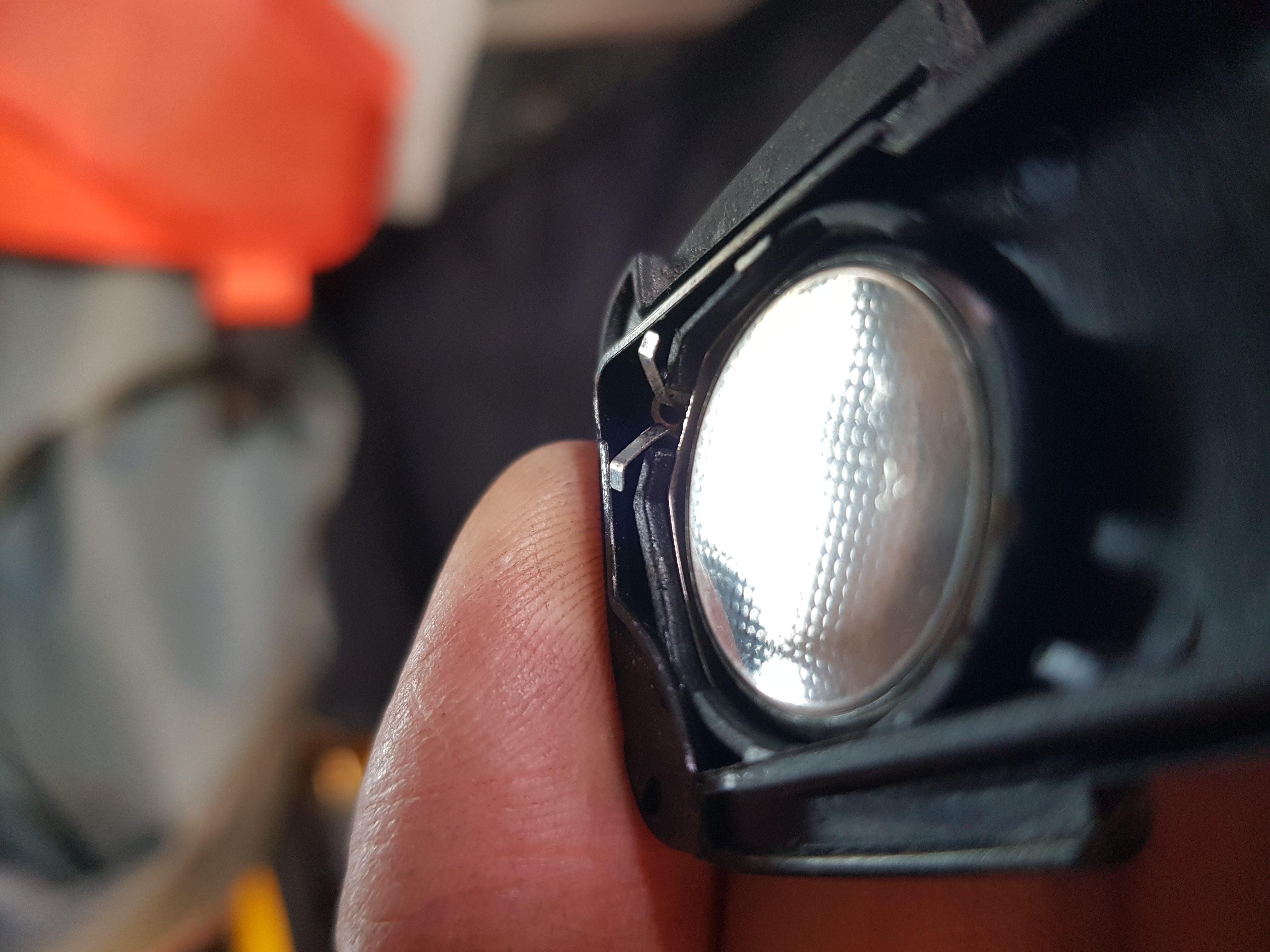

Also, I advise replacing the battery in the fob with a new, reputable-brand one (usually Energizer for me). I don't touch cheapo, no-brand ones any more. Sometimes they will give 3+ volts but no current, even when new, so your device doesn't function properly but you don't know why.
Re: Project, they all are...
Battery in the fob is new.

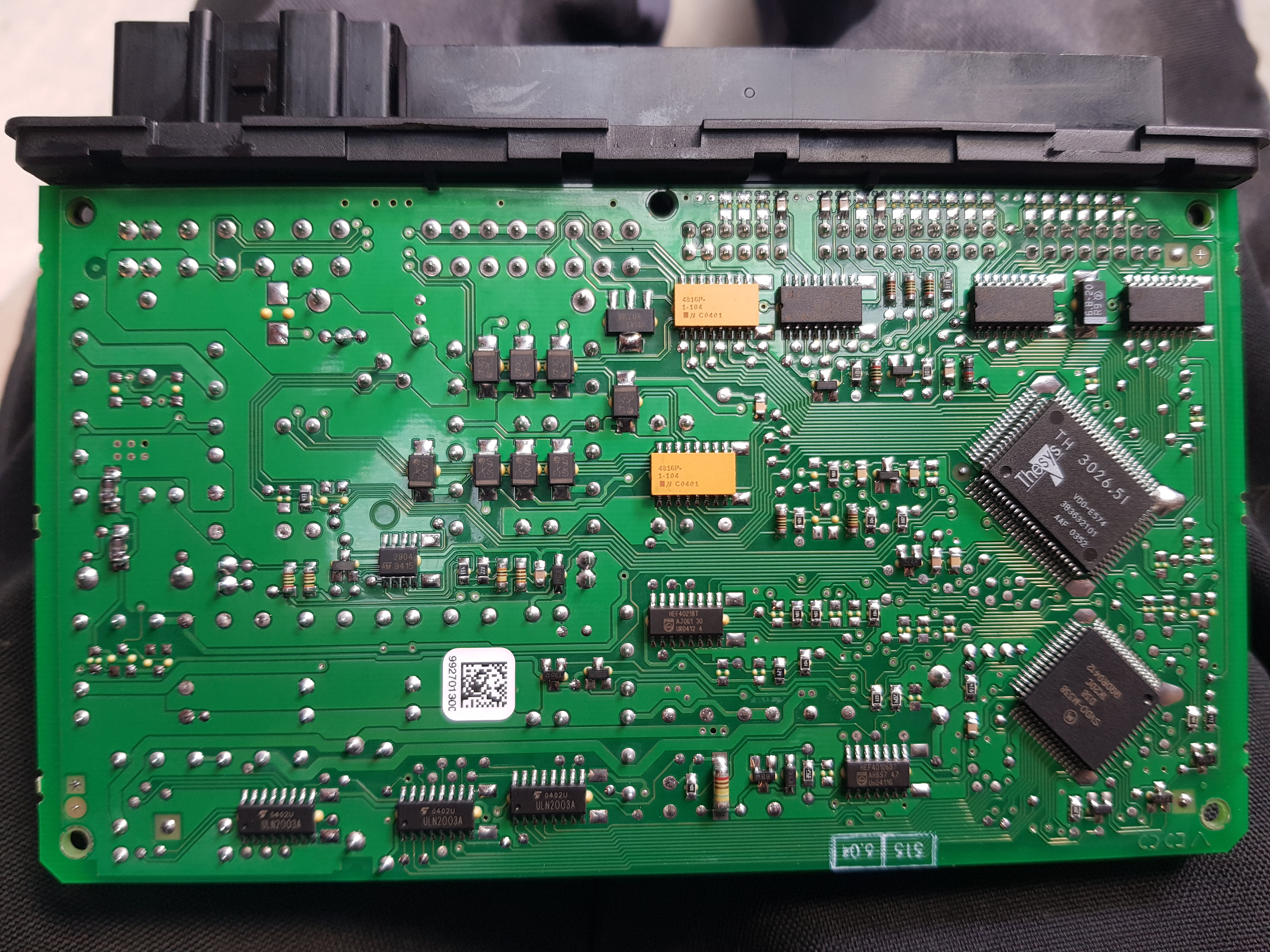

Was able to get it to work after playing with the legs on the battery holder. But after swapping the battery to the other fob I cant get it to work agian
At least it's not the module, I took it out. There is no sign of water damage to the board.

Key fob decided it was now going to work properly, no idea why it was playing up, but happy it's all operating well.
