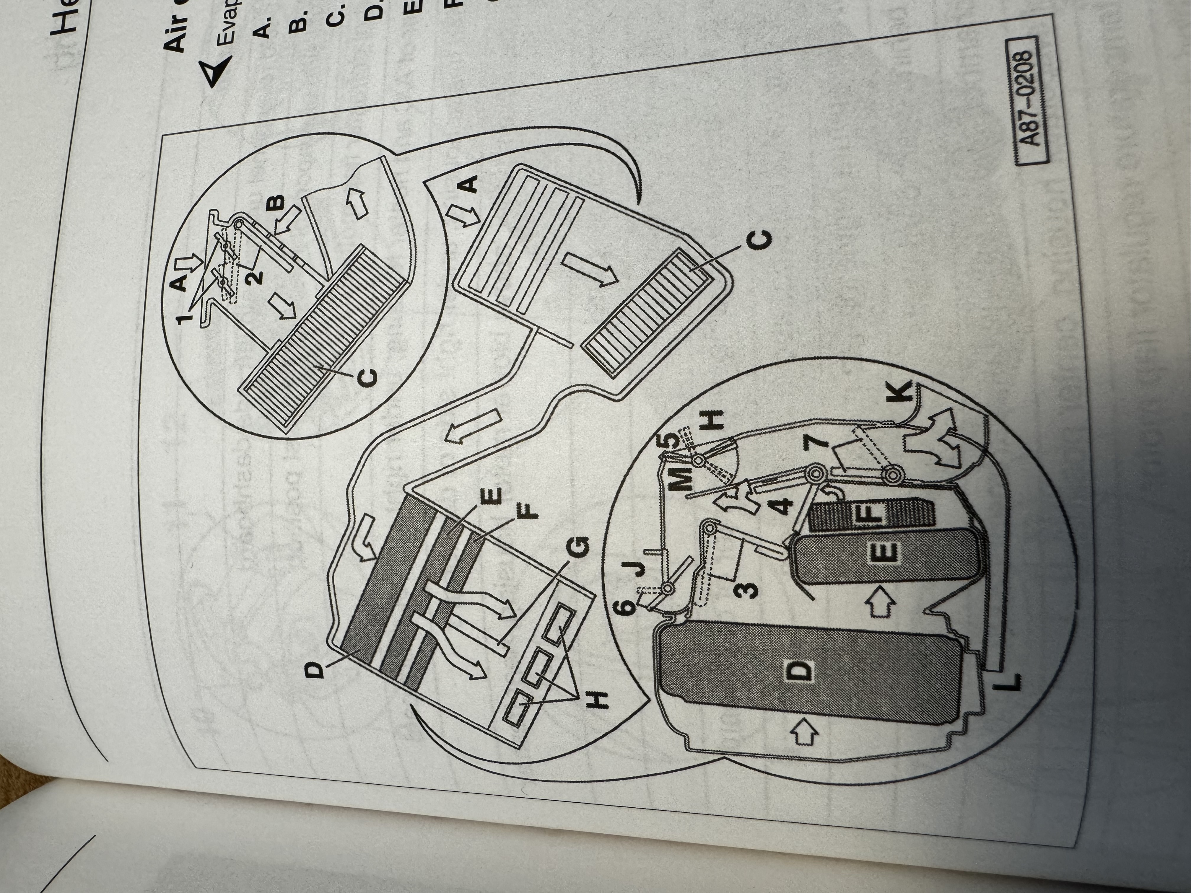

Whilst I’m sure isolating the inlet box could help, I fear some of the actual problem is the design of the blower housing and routing of air.
I believe as the air comes into the unit it always goes through rhe AC evaprator. If AC is on the it gets cooled down.
Depending on the mixer flaps position air either goes up, down or both ways. If up it goes straight out to the vents. If down it goes through the heater core then to the vents.
I assume that in full COLD position all air should go up, however some of the air actually goes down to the heater element and swirls back round as the flap is after it.
This must heat up the air. Ideally you want a flap before the heater core. Our cars do not have valves in/out the heater core so it’s always got hot coolant though it.
Daytona RS6 Avant
Re: Am I being daft. AC/blower query.
D is the AC evaporator
E is heater core
F is additional heater that most of us won’t have.
E is heater core
Daytona RS6 Avant
Good points. Well analysed.
