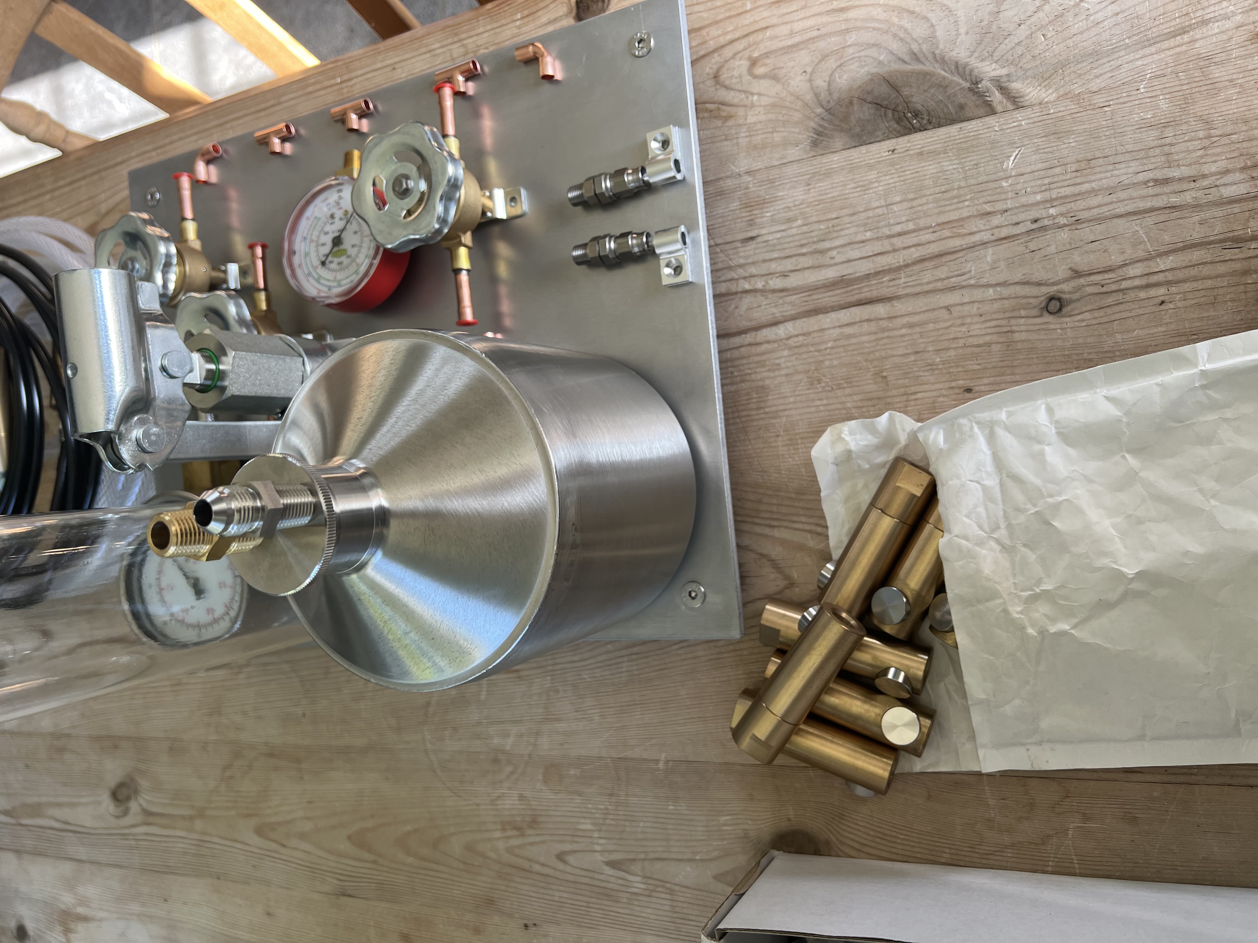

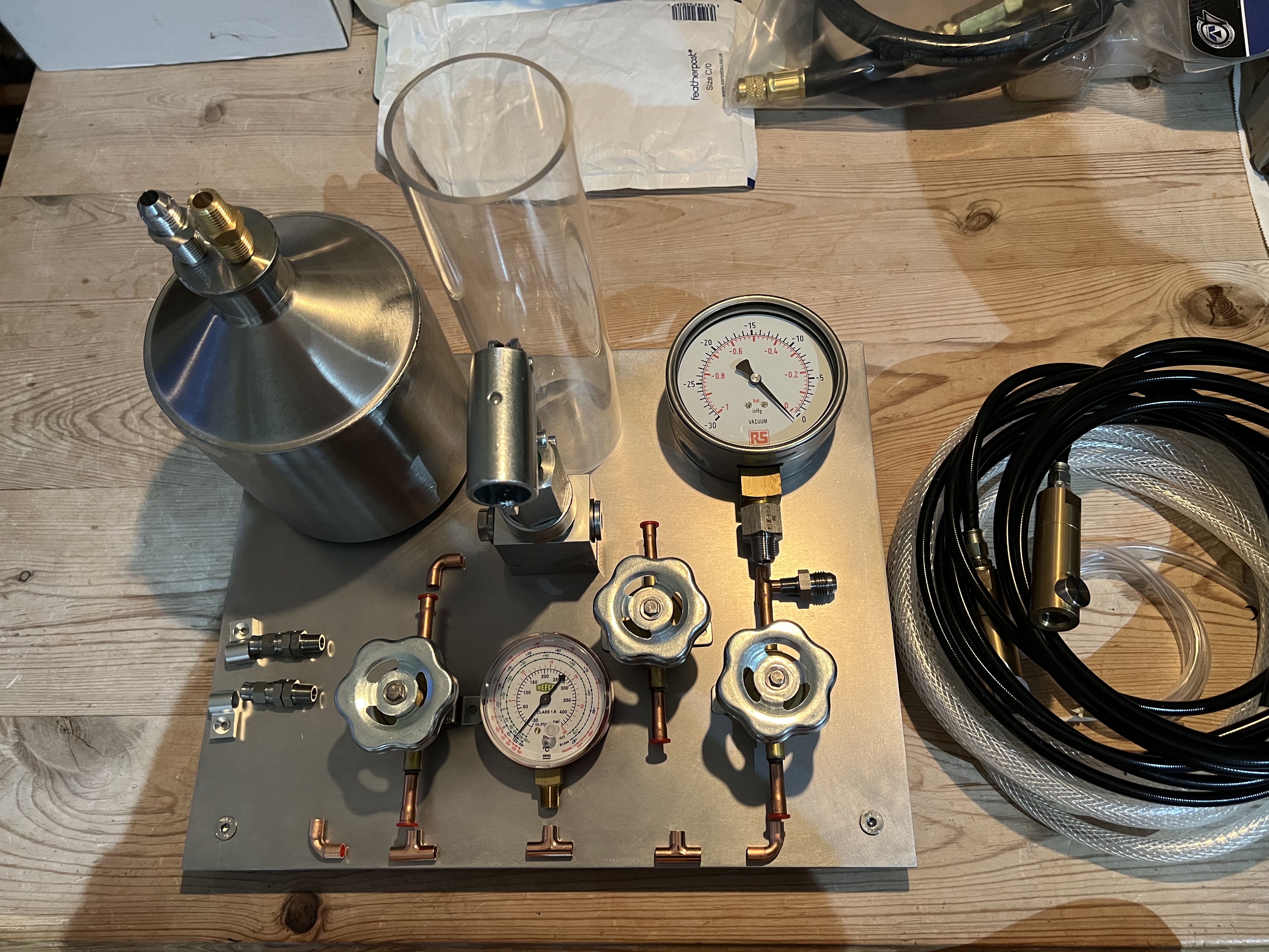

Tool is coming together to enable this to be DIY and an easy regular maintenance check, i am keen to keep the DRC, its a great system.
I understand people may be intersted in this so will start a new post shortly and all going well, open up a group buy to supply the tool to other enthusiasts. This is the prototype using some various parts i had and custom parts to finish it off.

Drool... Can't wait to read that one - esp. the part where you reveal to the world where you sourced the connectors from the flex lines to the shocks. That's where I got stuck when I researched this...lugars4 wrote: ↑Thu May 30, 2024 11:09 pmTool is coming together to enable this to be DIY and an easy regular maintenance check, i am keen to keep the DRC, its a great system.
Re: All comes at once - DIY: SAI, DRC, Oil cooler, Carbon clean, Fan, Tyres, Paint Corrosion, Injector Service
The connectors took years to find and had to buy a whole lot. Cost a small fortune but will be worth it if gives a few people their own tool to use at home.

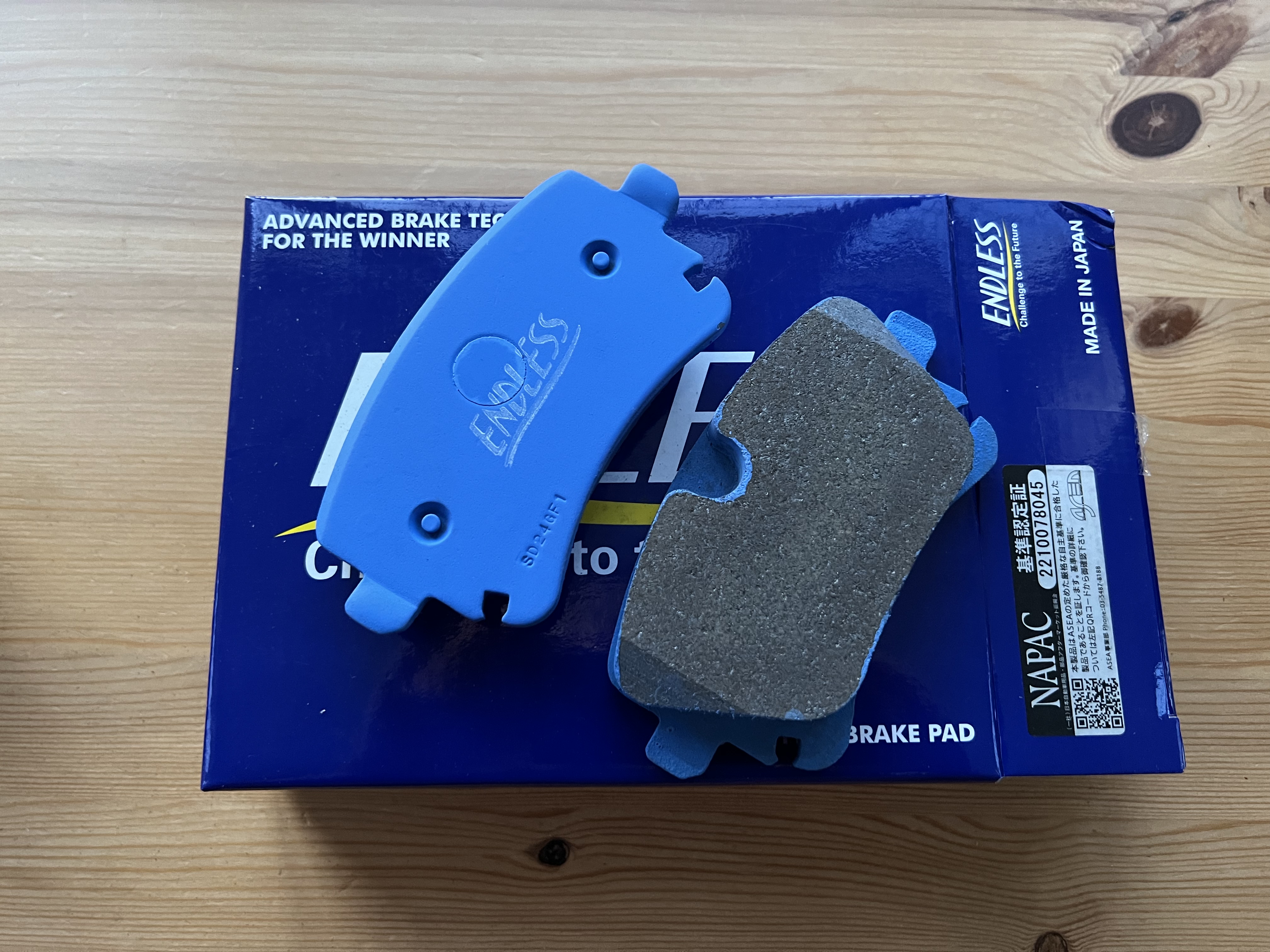

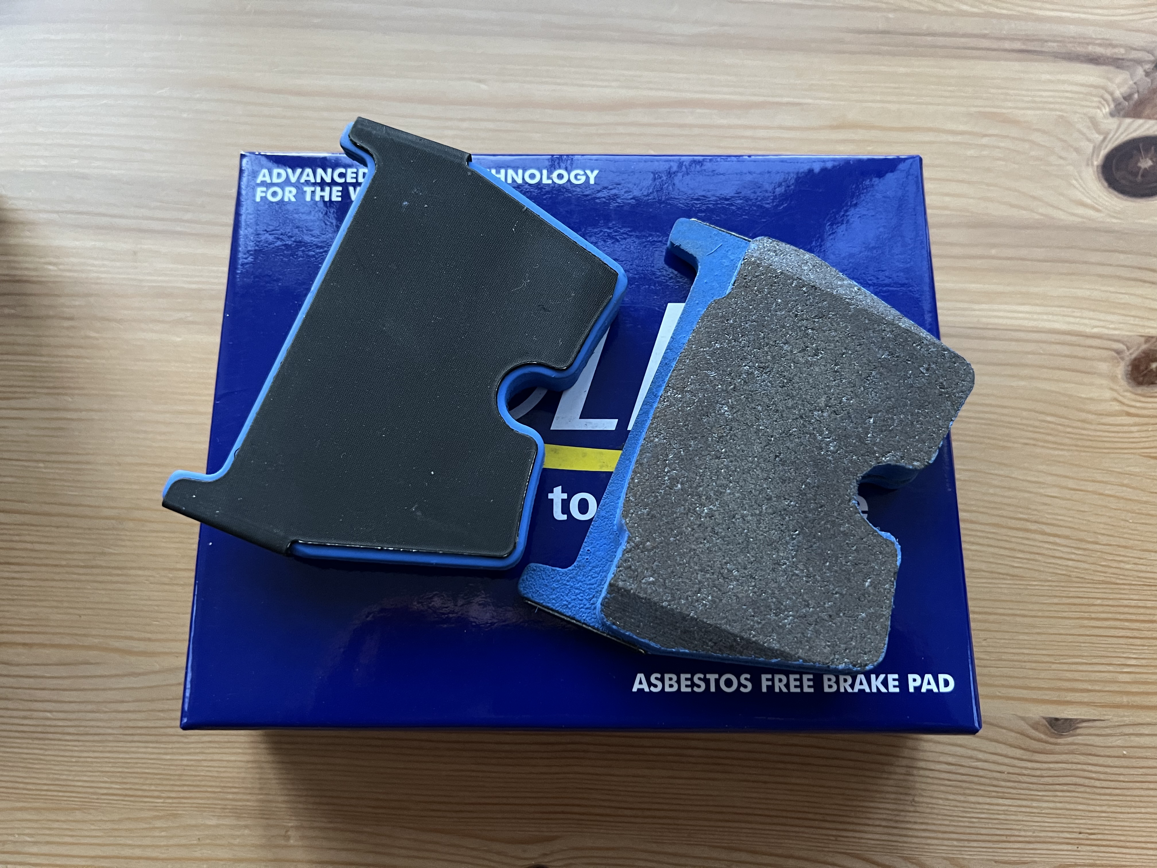

After a very long wait, hopefully worth it, my Endless pads have arrived!
The fronts come with backing pads, rears dont, will see how they go, i have seen people take the backing pads off their existing pads to use on endless, not sure if it will be needed on the rear, i trust their R&D it wont as a starting point.
Here's to less brake dust, better performance, less rotor wear and a bit of fun.
