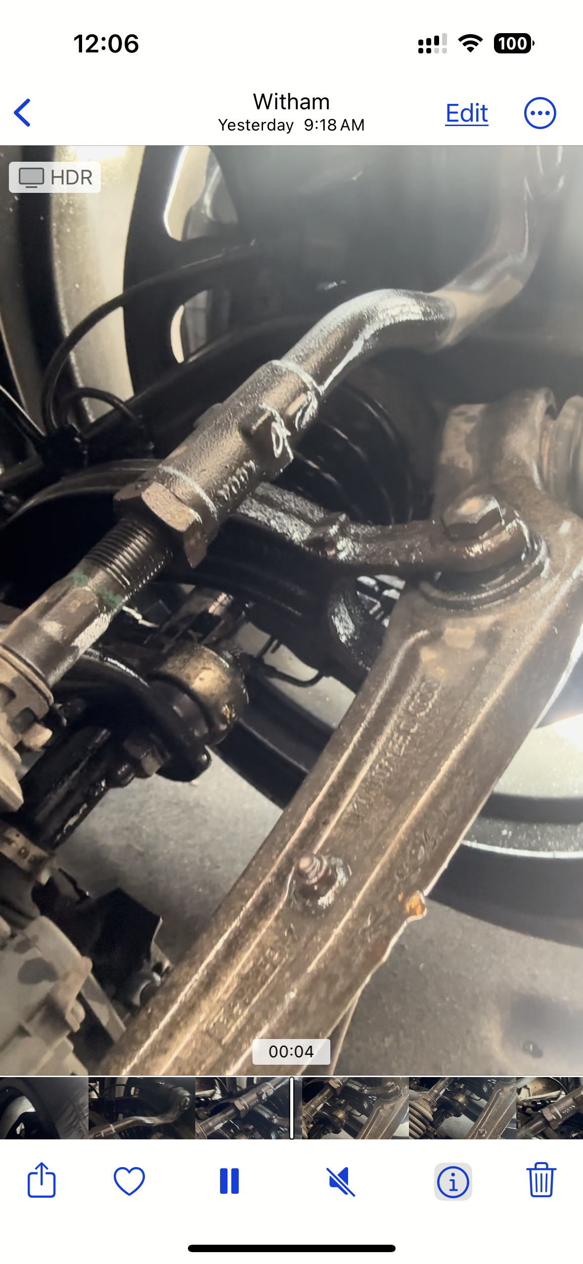

Had leaking fluid coming from the passenger wheel and lots of it - was worried it was brake fluid on my newly refurbed wheels but it looks like a drc pipe has given up and wet itself - by the time I nursed it to my local garage the suspension was not nice at all.
They’ve showed my the pipe that has gone and said it’s a specialist or main dealer only - which I kinda new.

Poor pic attached - I do have a video but can’t see how to upload

Audi want £ 2880 to replace 4 drc pipes, new fluid, and recharge the system
Being collected today as that’s just not realistic

Pic from front passenger side

Now been recovered to Daniel James performance (Southend Essex area)
They have the tooling for the recharge and have worked on many cars with DRC
All 4 flexi pipes being changed at over £800 (parts only)
Quoted c £1500 all in parts /labour /fluid /recharge
They are also doing a service/ health check ( separate cost)
So far very happy, better service and price than the stealership !
