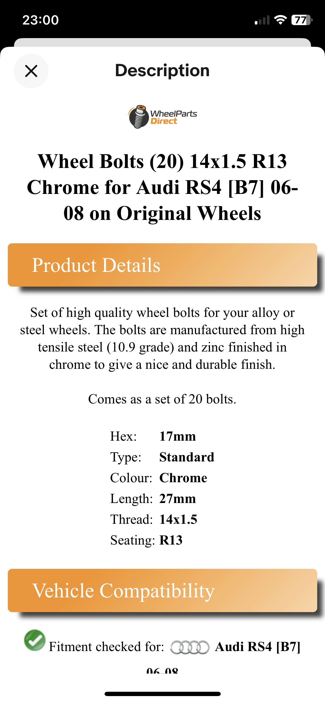

Standard wheel bolts are M14X1,5X27,5
2-part and R13 part number WHT002438 and about £4.50each from the stealer

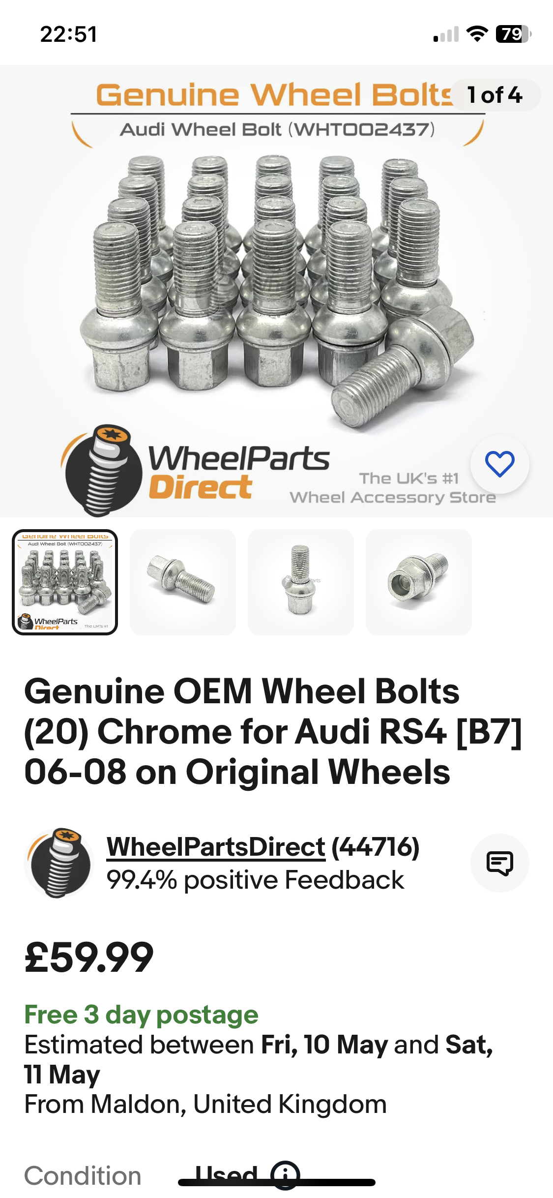

I will get the two part bolts shown above but they are part WHT002437 not WHT002438
Don’t know if there is any difference.
As the sizes look to be similar.

You want the WHT002438 as it’s a 2 piece design which is used on all RS models.
The WHT002437 is a single piece and doesn’t have the loose collar.
I recommend you purchase the correct ones, but it’s your dime as they say over there…

WHT002438 is the VAG reference for the bolts for our cars.

If I Google WHT002437 it’s a solid bolt which is the wrong one

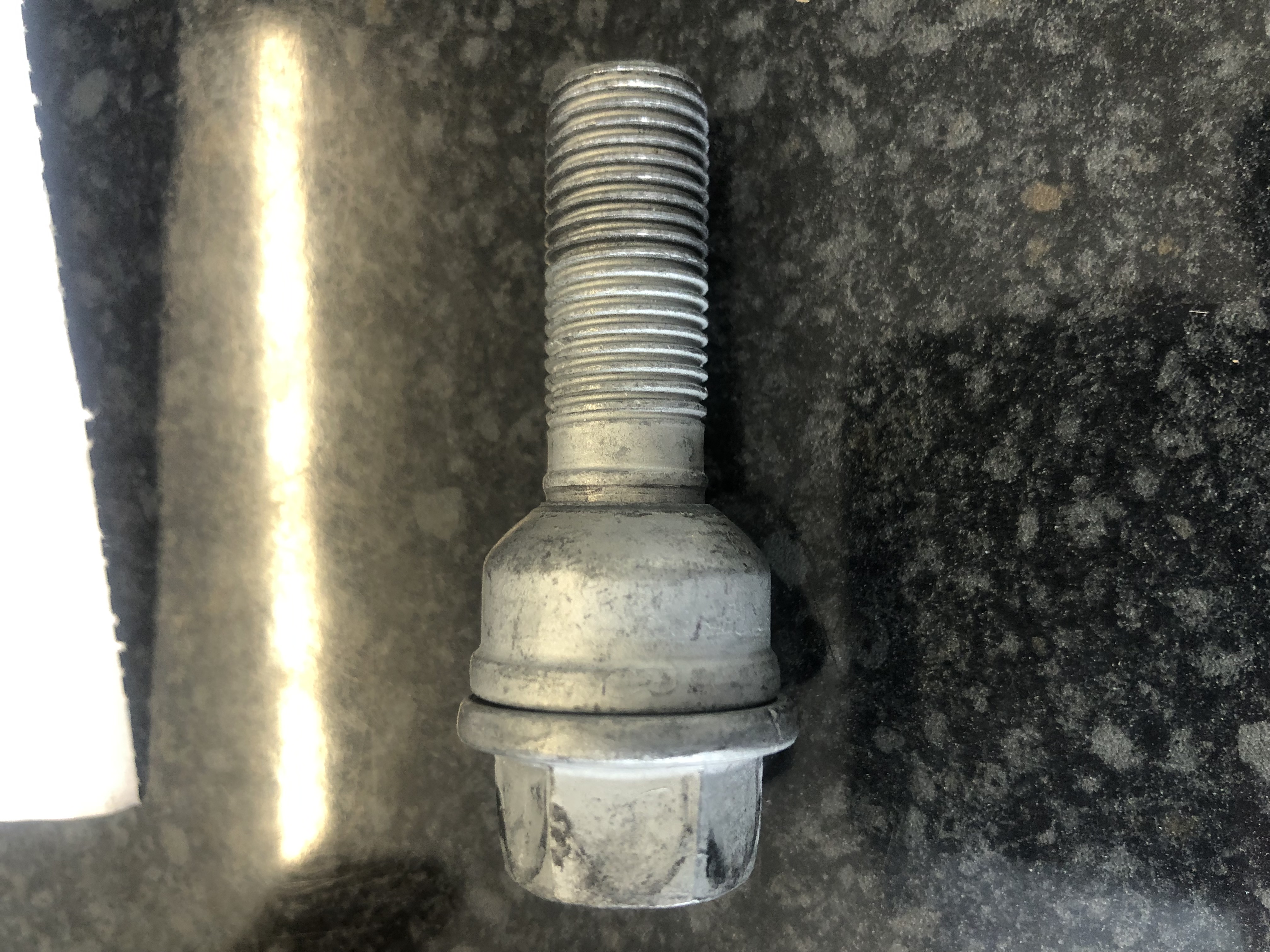

Wrong bolt but it is a two part bolt
Defo not OEM for a AUDI RS6 B7.

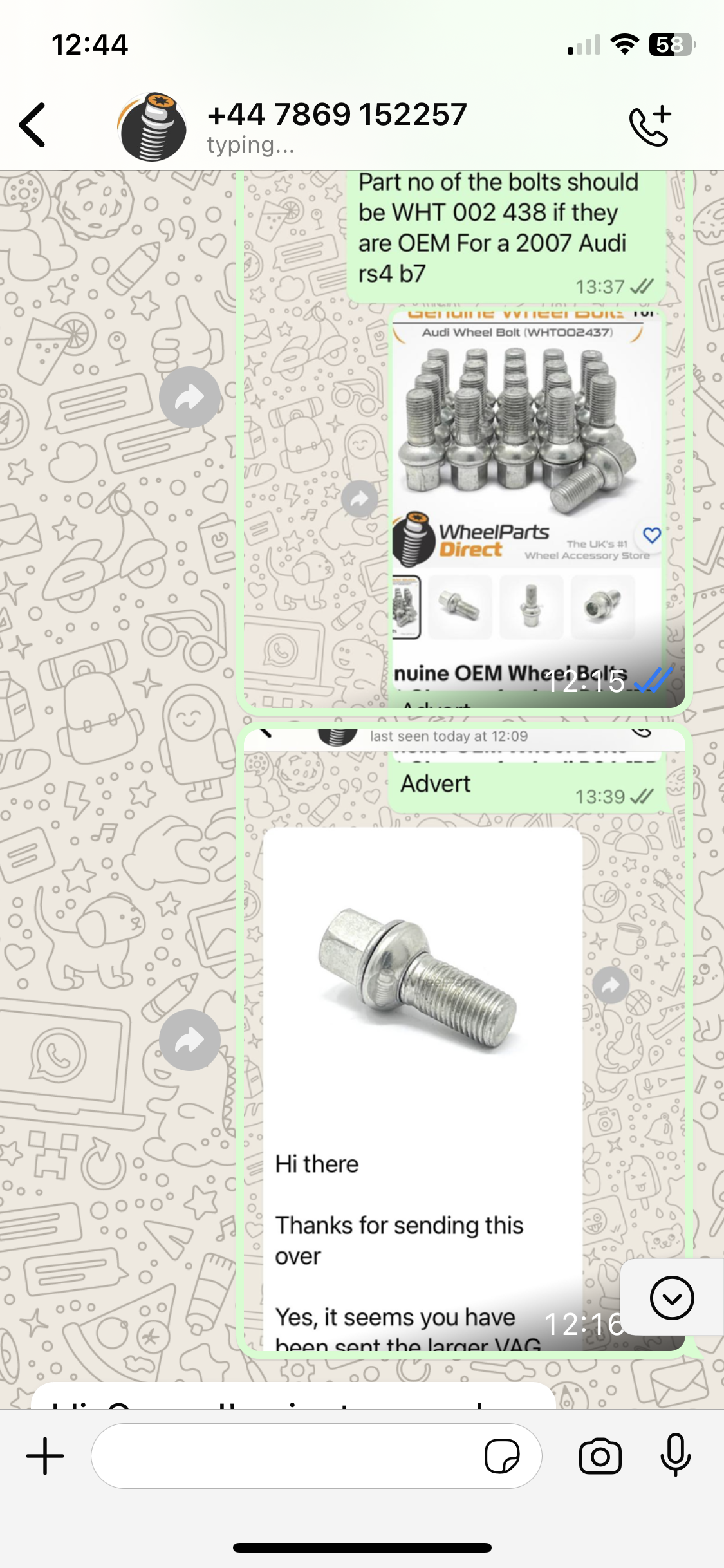

Just spoke to supplier he confirmed the wrong bolts have been sent.
Had to go to the garage to check them out.
They also confirmed that the advert did indeed have the wrong part number.
Shopp and topman are correct.
The part number on their advert should have been
WHT 002 438.
