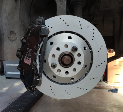

Thanks lads! I will monitor all parameters for a while to ensure everything is ok and power stays with me. Good job she got new anchors last weekend

What pads did you get?

Boggo Brembo?

Only if you ever need to slow down quickly.
