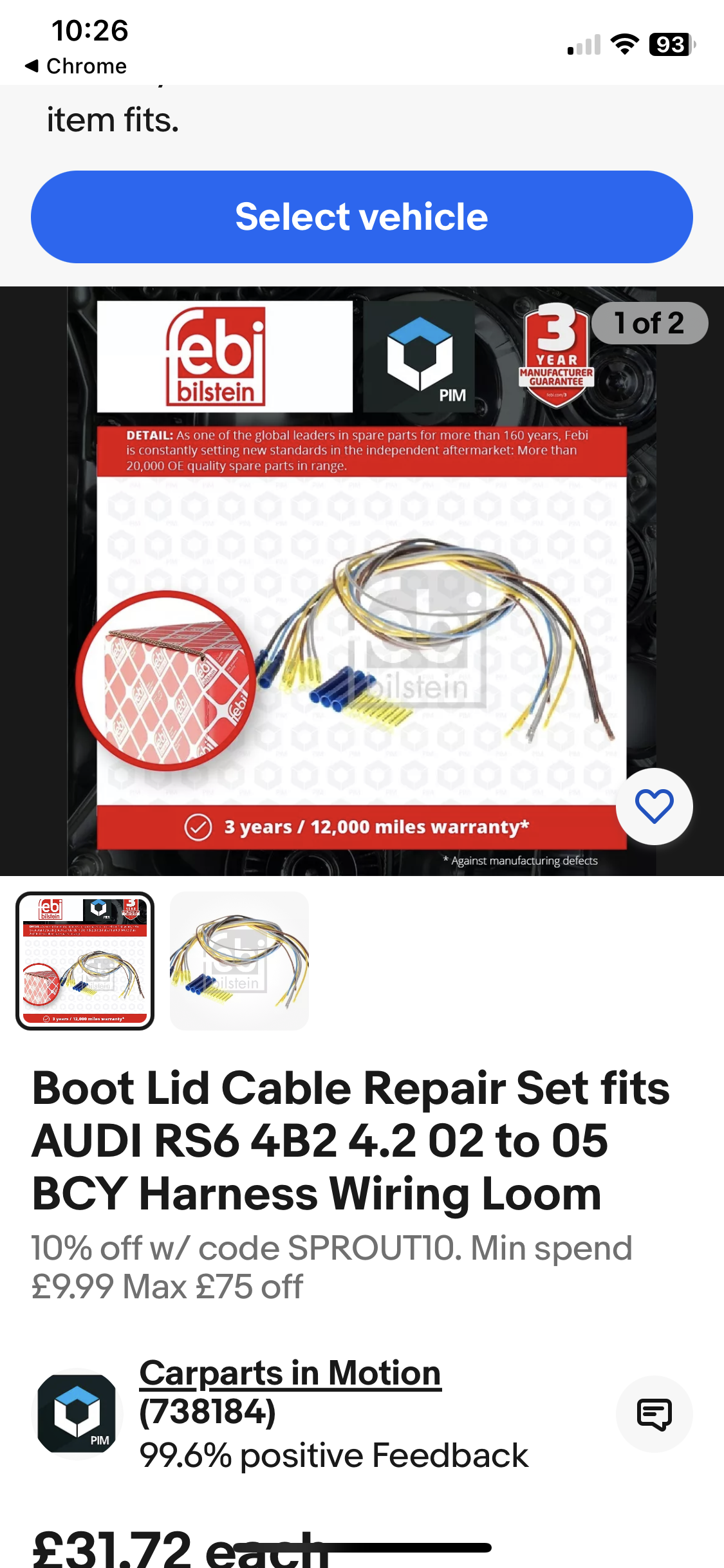

Will do a better repair when this kit arrives.
