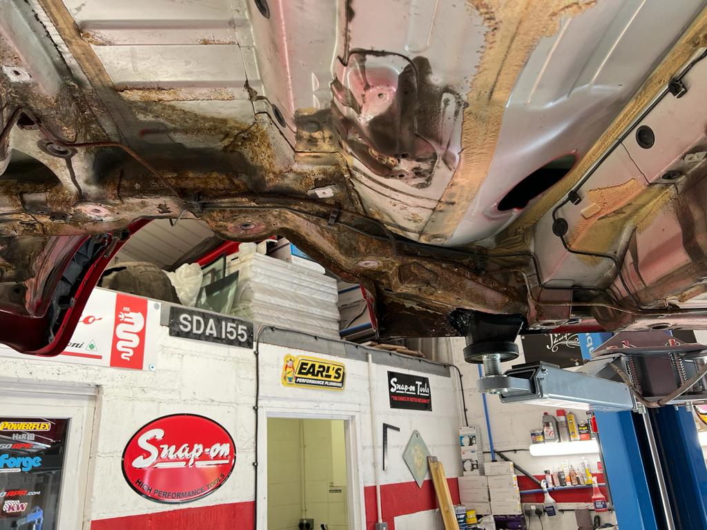

I managed to get hold of some of the rear suspension arms, links, bushes etc from Autodoc
As mentioned, unfortunately it will require complete Rear Subframe drop and removal to install components - at which point - may as well tackle the surface rust and corrosion on the rear chassis and subframe - so pretty big job
At this point.. I just want to get the RS back on the road, having been off the road for several months..
So, I'll have to formulate a plan later in the year / probably next year to tackle this...

Meanwhile.. be nice if anyone has some pointers / tips!
