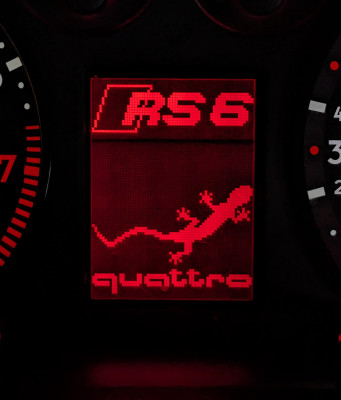

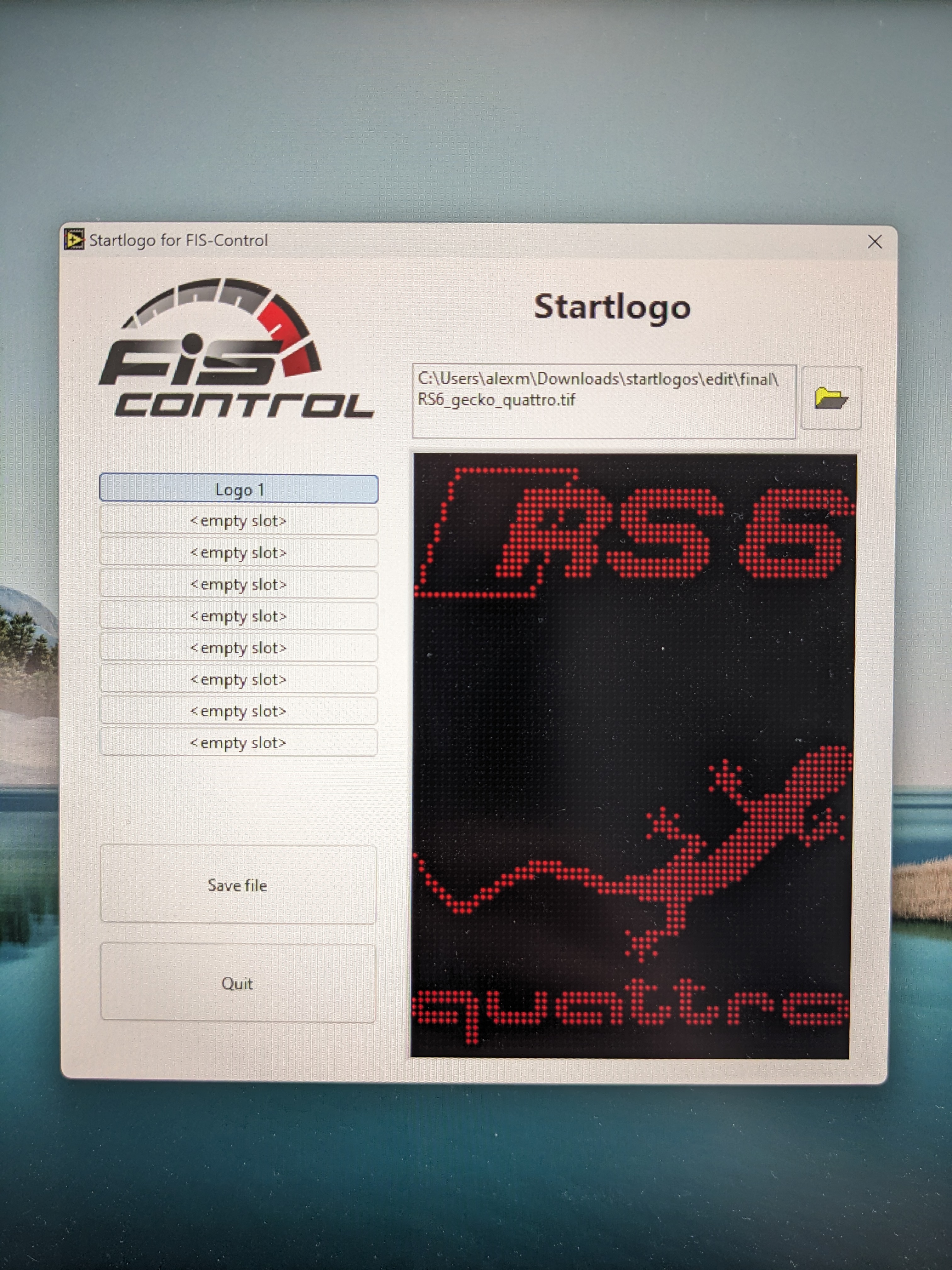

now I'm unemployed i found the time to mess around with the FIS unit.
getting it to work was not as simple as appears. In the end Stefan from the FIS-Control forum was really helpful +there are full instructions. mine wasn't doing as expected.
one thing to note is that although in theory you can access FIS Menu in Park & Neutral, the warnng about brake when changing gear ovverides it. so you need to be in drive with the ignition on to access the menu and confim the configuration of FIS-Control and Cluster has worked. in the end it did.

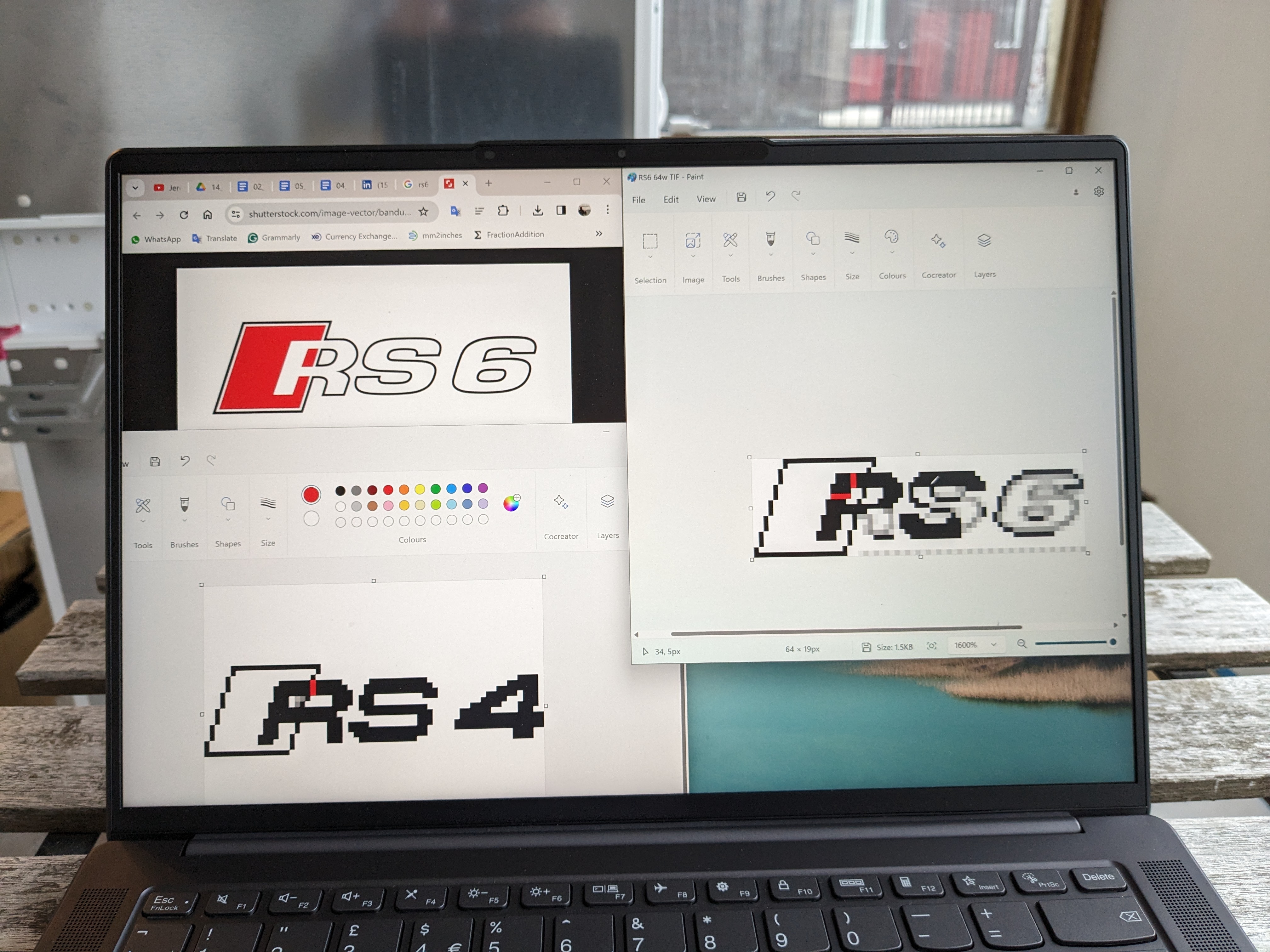

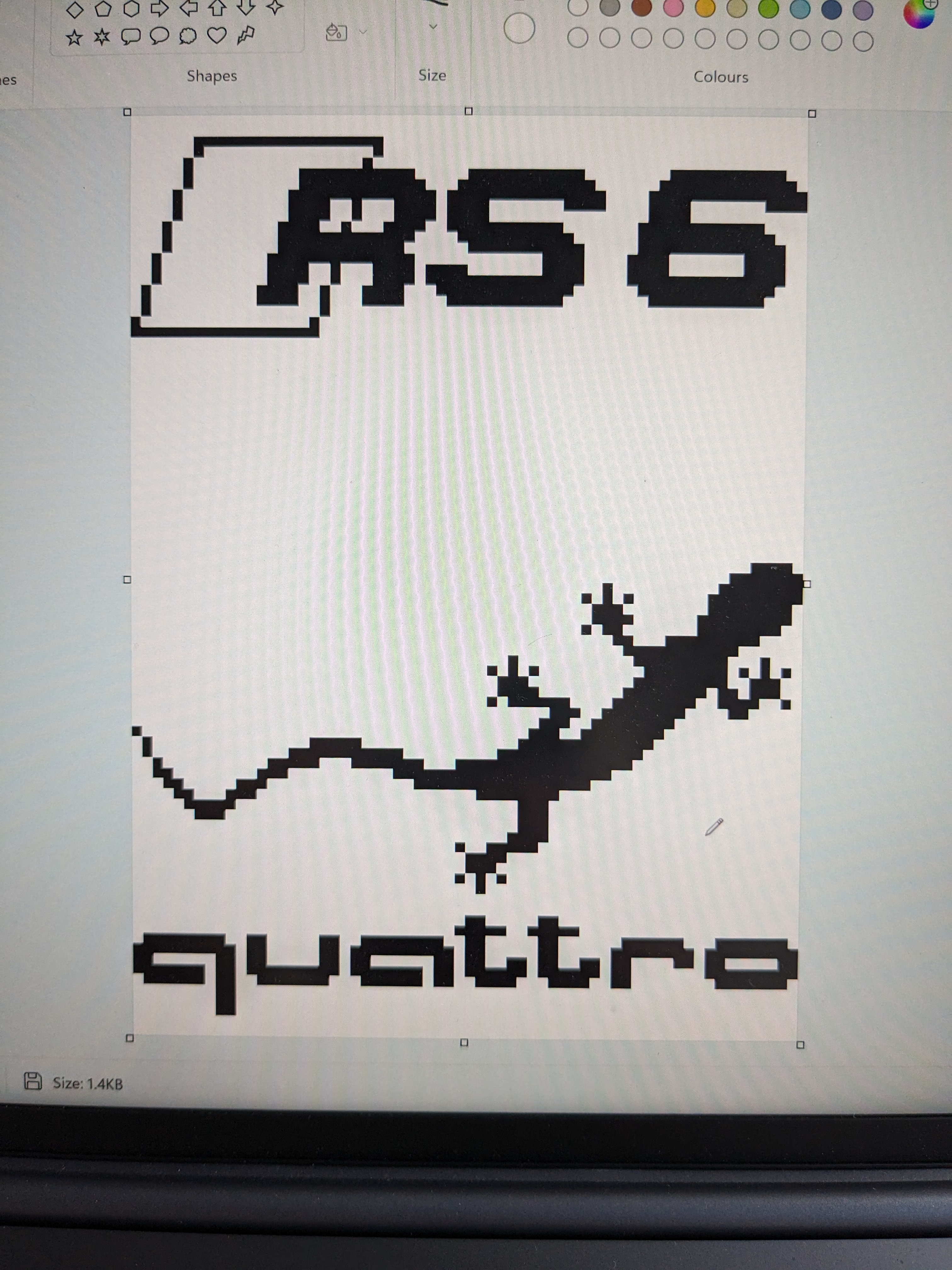

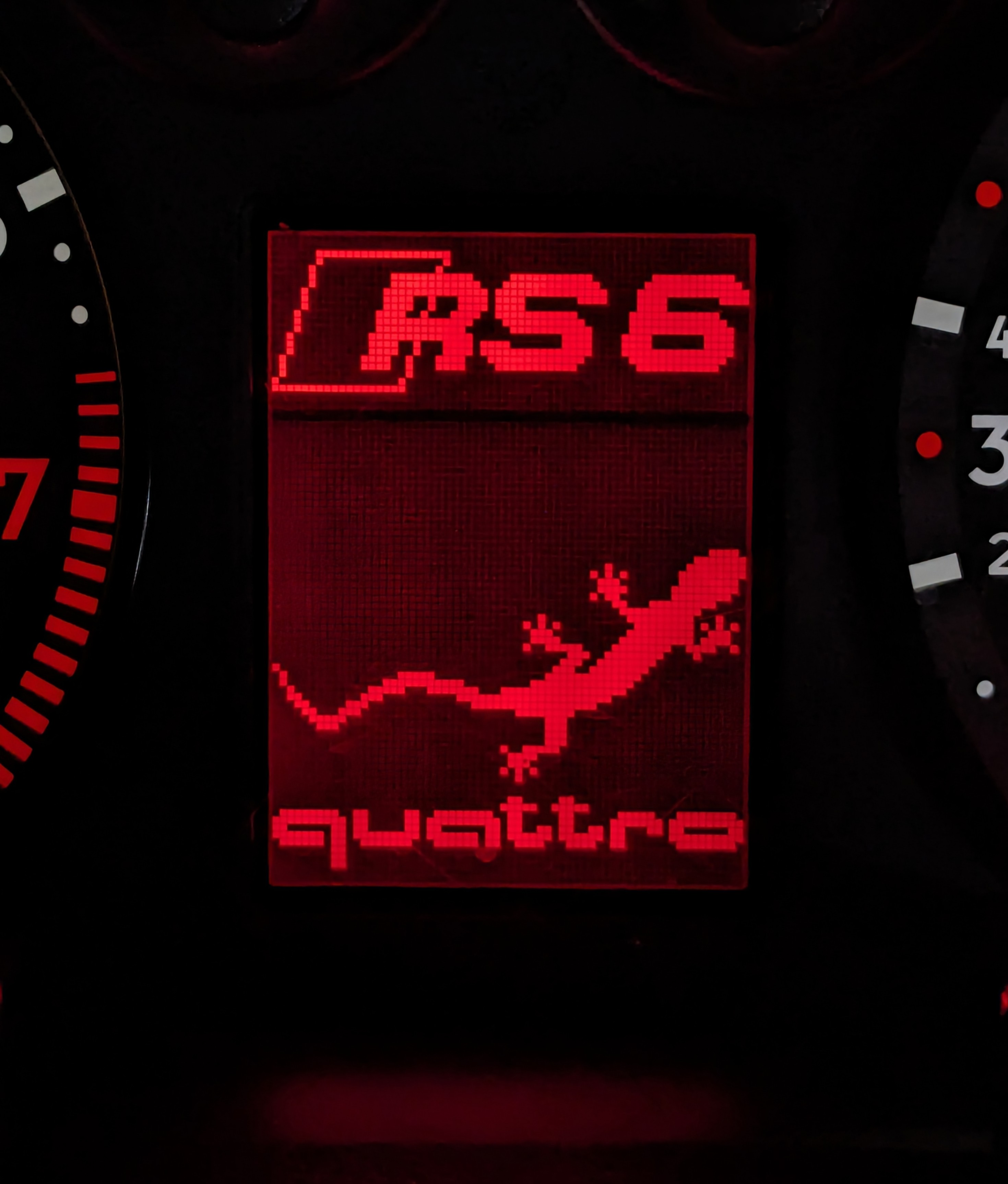

i got my MS Paint skills out last night. i made the RS6, updated the gecko and the quattro now i get this when i start the car. like a PC game circa 1988. (I can share the dat file if anyone ever wants it)

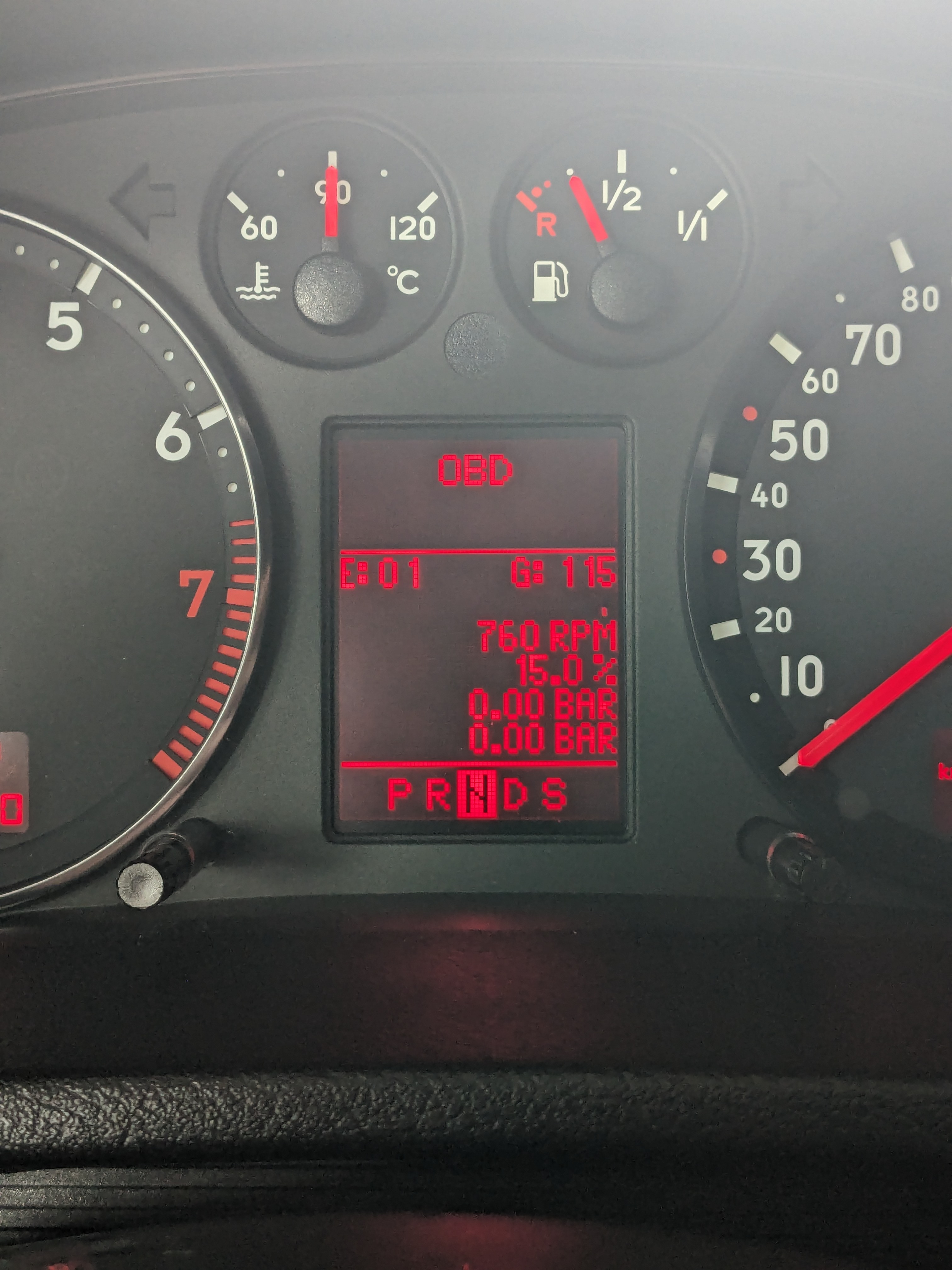

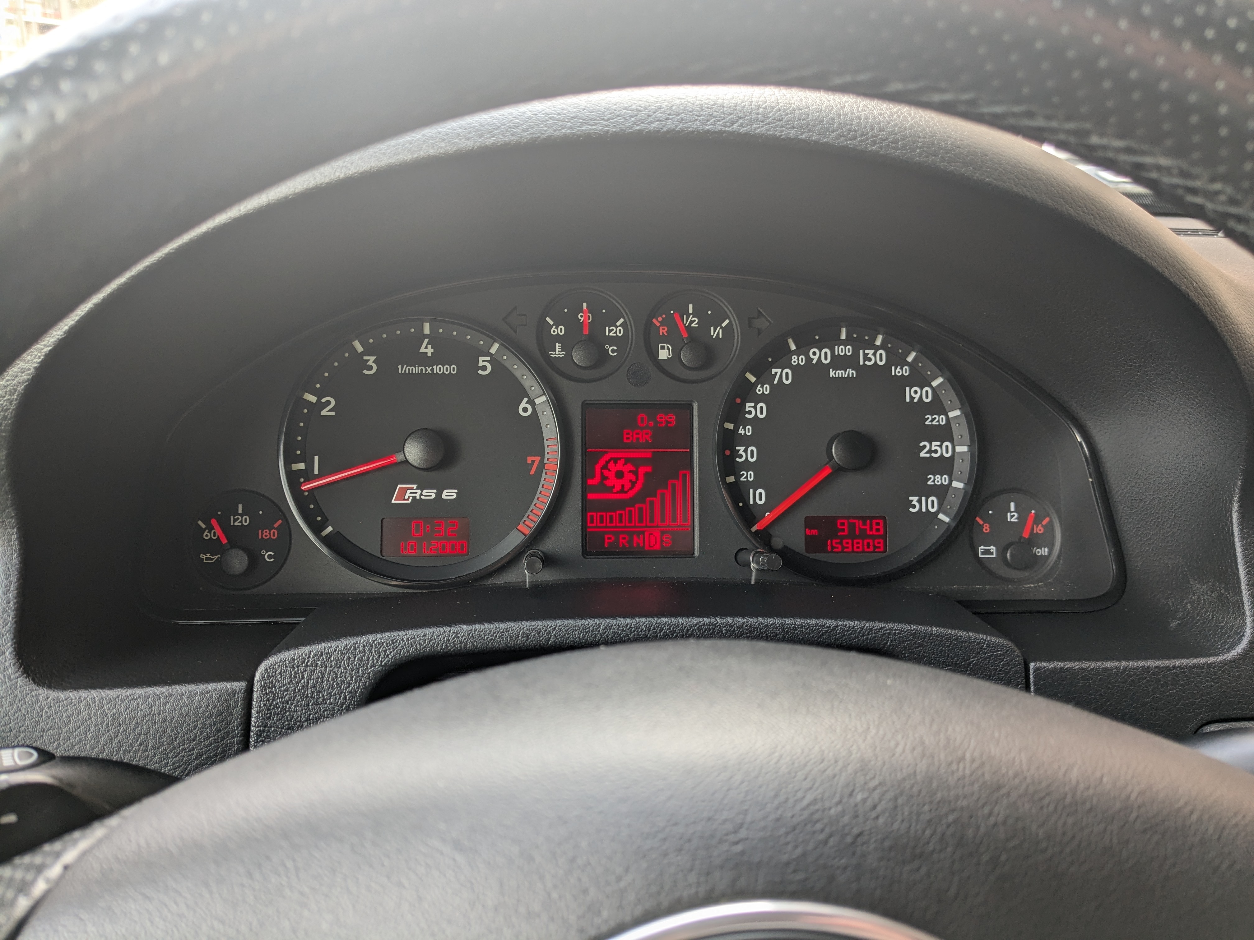

Can anyone tell me the value location for the MAP? Reading around I see the group is 115. Trial and error got me to atmospheric pressure.
I believe the FIS will subtract Atmospheric from MAP to give me Boost.
I now have a steady atmospheric pressure reading....
I'm kicking myself now, with the never ending DIY flat reno I didn't have the headspace for it. I didn't have a laptop. Now I will.
Anyway
I had a get a laptop to find a job...
Until I get a job and money the car bits will have to wait.
RS6 C5 Avant 2002 Daytona Grey
TTH 620 - Wagner IC - OC.T 200cell&downpipes - DW400 pump - 034 TCU chip - FIS - B16 PSS9 - 034 control arms - H&R ARB - OZ Superturismo
Re: FIS Control
The RS6 doesn't have a MAP sensor. It has a boost pressure sensor. The 2 terms are sometimes used interchangeably, incorrectly.
The only information about the pressure in the manifold comes from the boost pressure sensor. The ECU has a built-in atmospheric pressure sensor and it uses this to adjust the mixture for altitude.
The boost pressure is available in lots of groups. 115 is fine, position 4.
The atmospheric pressure is available in group 113, position 4.
- anditsoundslikebells
- 3rd Gear
- Posts: 377
- Joined: Thu Feb 13, 2020 6:22 pm
Re: FIS Control
thanks Shop. i did wonder and doubt it did. a quick google and i dound one for sale... as you say, incorrectly.
i'll add these and see where i get to

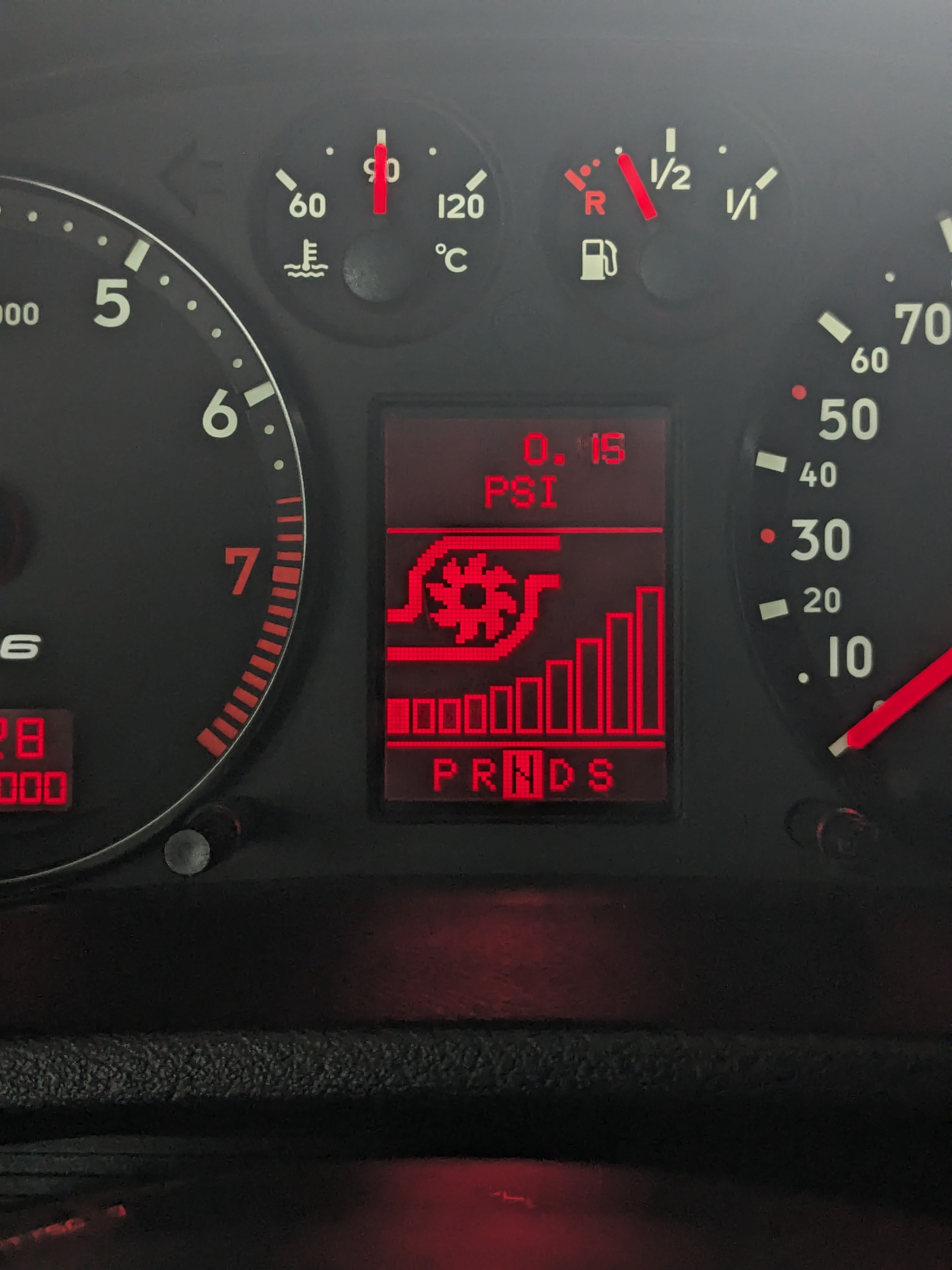

Re: FIS Control
You'd subtract the atmospheric from the boost pressure to get the amount of boost.

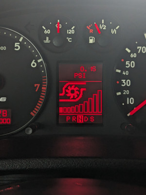

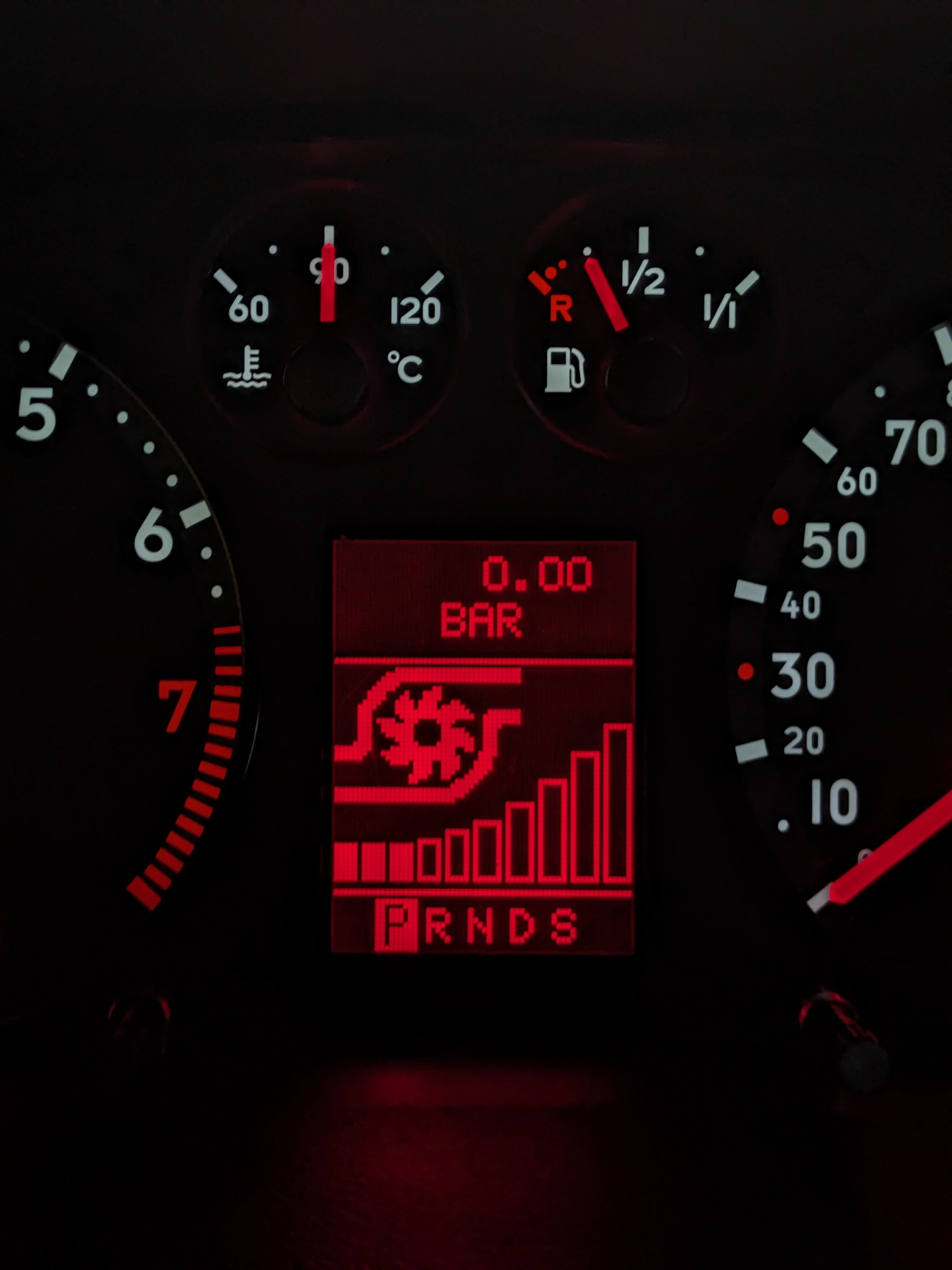

interestingly i can access the ecu data through the FIS.
is there a mapping table somewhere online that would tell me what these values are for?
getting somewhere. i need to add the upper/lower limits for the bar graph.
i guess these would be specific to the tune and would have been logged.
i'll ask JD Engineering what they did when they set it up. and snake:
Re: FIS Control
Log your requested boost in group 114 when you go WOT and you will see what the max requested boost is.
