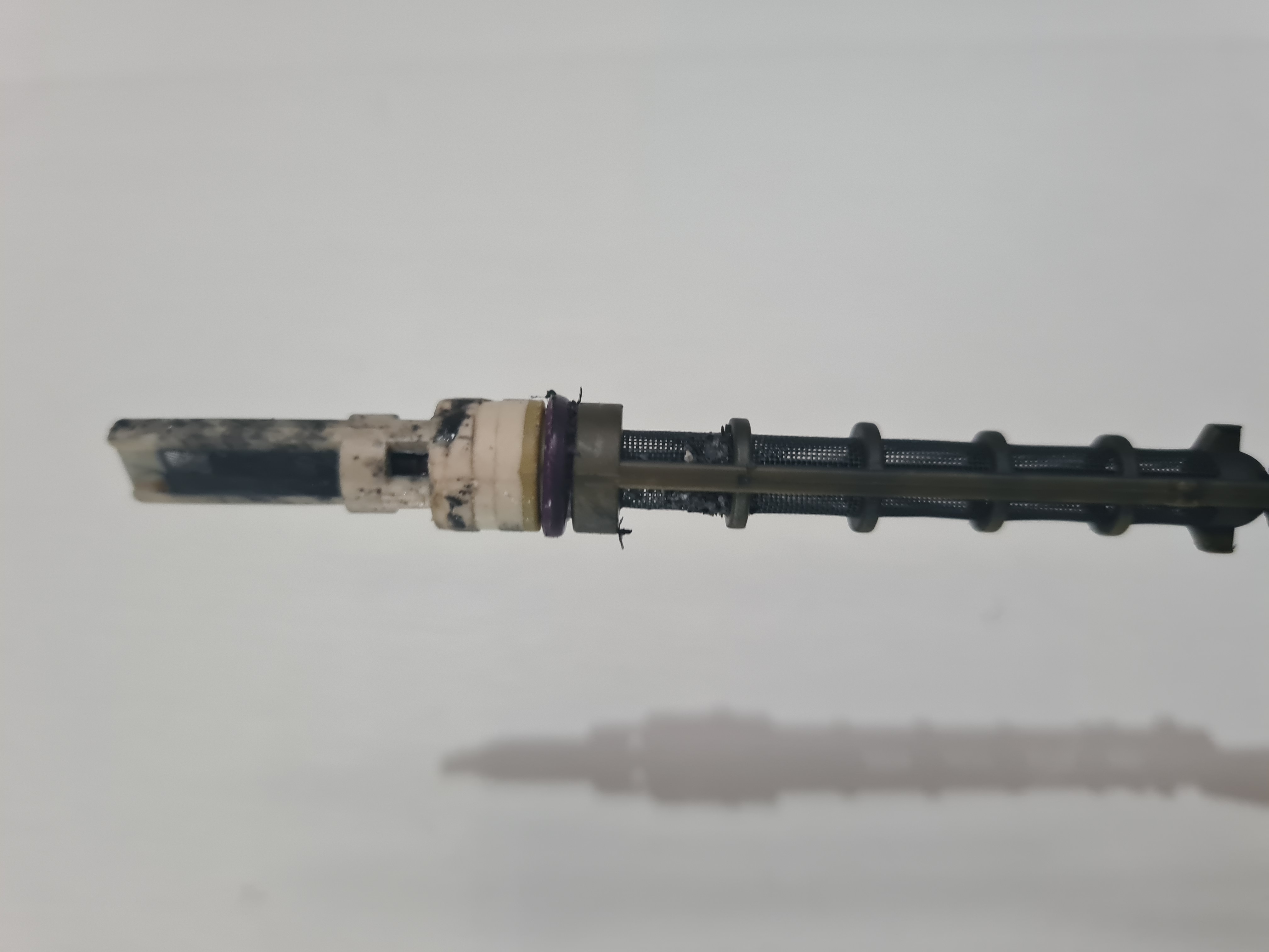

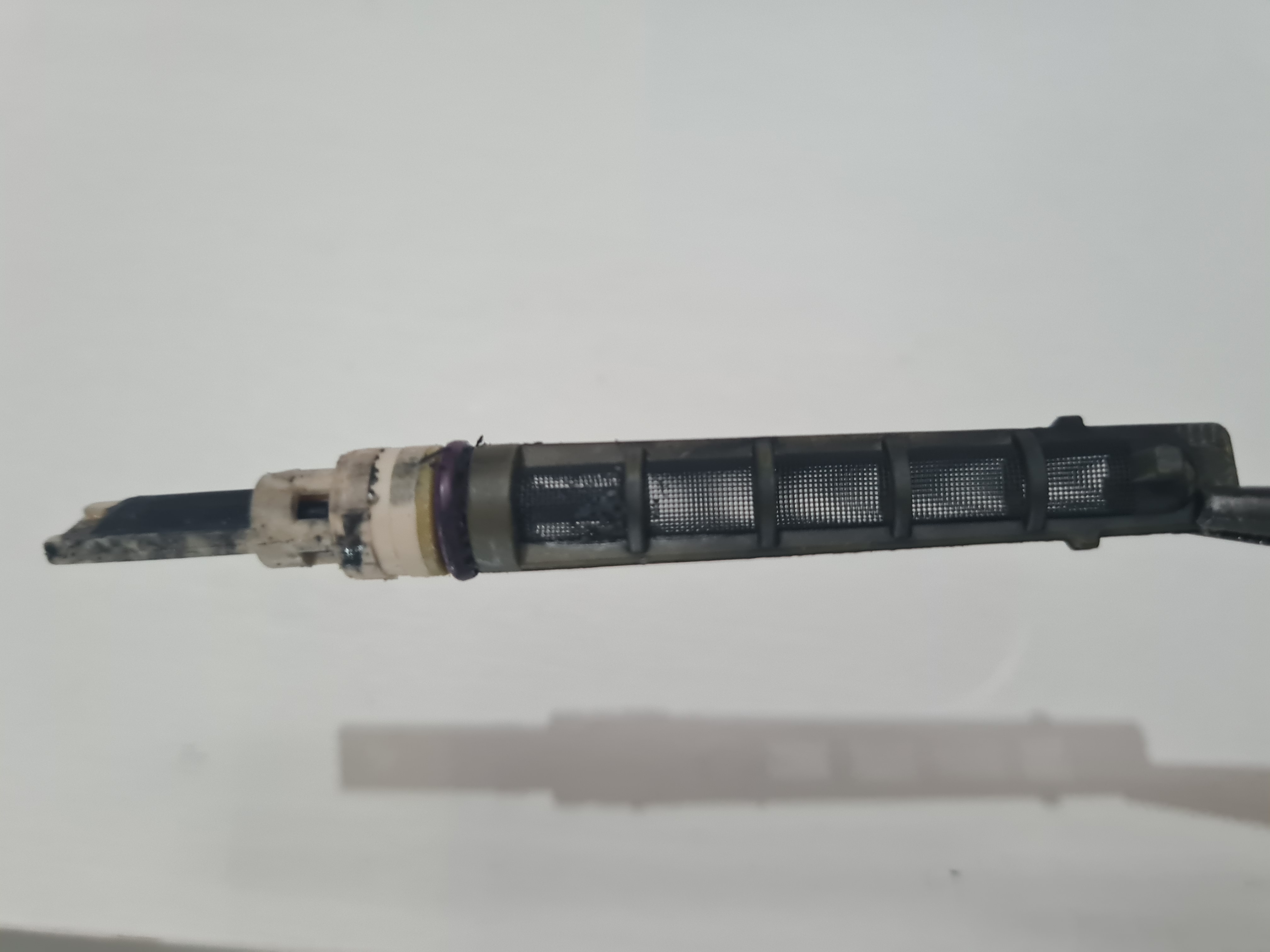

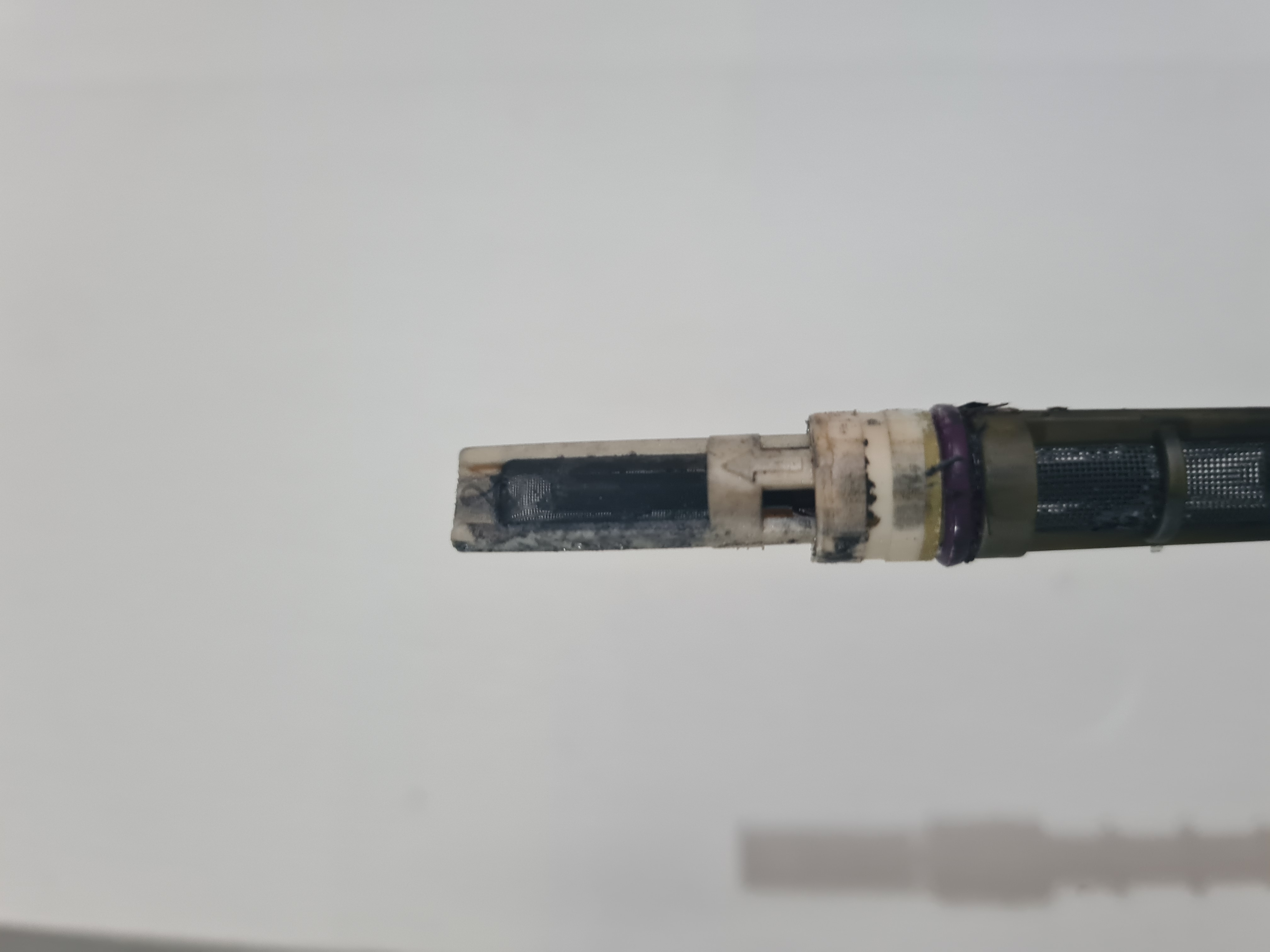

Post by Lander91 » Wed Jan 17, 2024 8:49 am
Got into the scuttle box on the weekend. Replaced the orifice tube/screen and 3 seals that I could access. Check out that orifice tube! I don't think it's the smoking gun, potentially it's that way as a result of the system overheating and scorching itself after repeatedly being topped up (repeatedly getting low on gas). Anyway, as an FYI the procedure of replacing the orifice tube is easy.
De gas the system
Remove the scuttle panel
Unbolt the coolant res and secure aside
Remove the hex bolt (8mm I think) from the bulkhead high & low pressure line block
Loosen the high pressure junction that is below the coolant res (22 & 24mm spanners)
Remove the detached piece of high pressure line
Needle nose pliers to extract the orifice tube found in the section of pipe
Clean pipe and junctions - well!
New orifice tube is a challenge to get in, new version has 2 orings on it. Constant careful pressure pops it in (reference how far in the replaced part was in)
Put it all back together with new seals.
Cross fingers and regas. (I haven't done this step yet)
