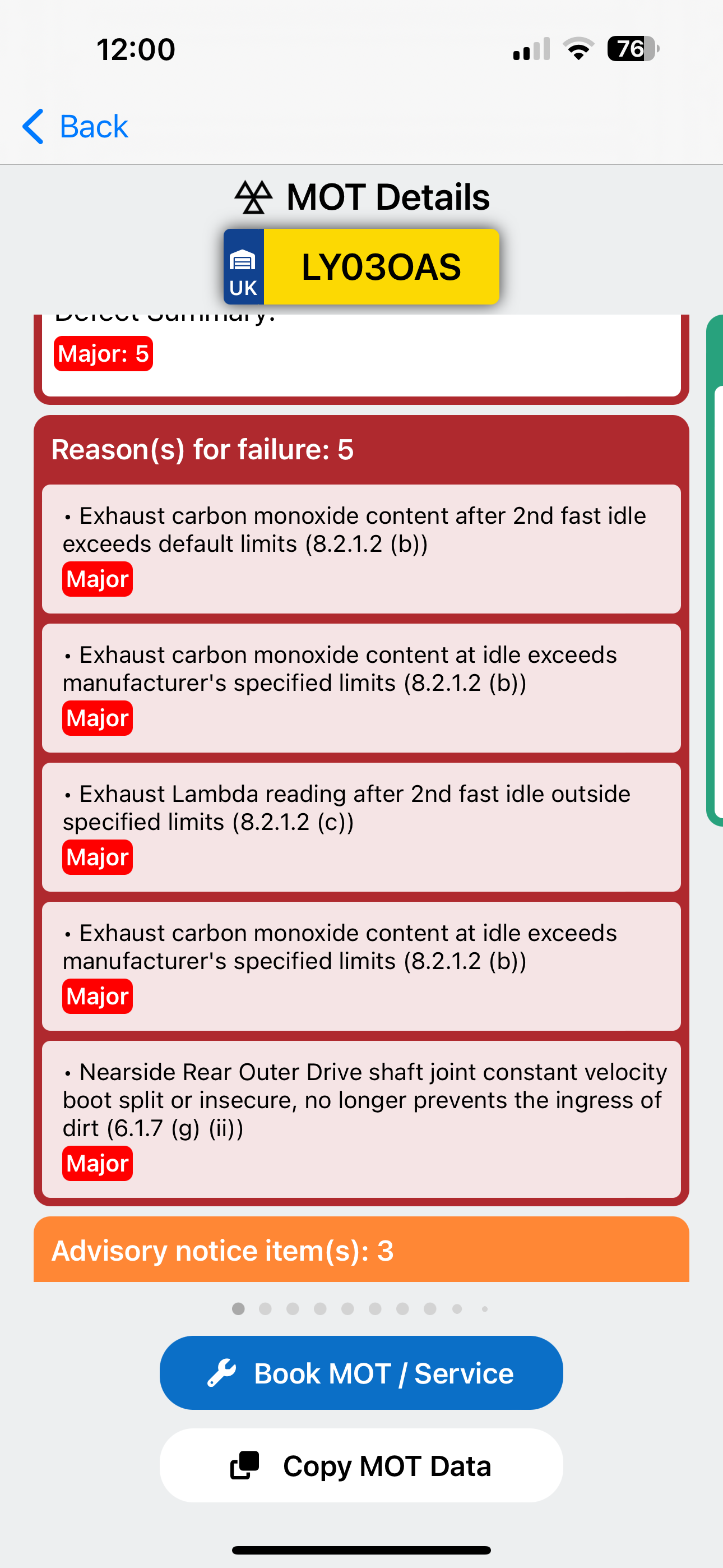

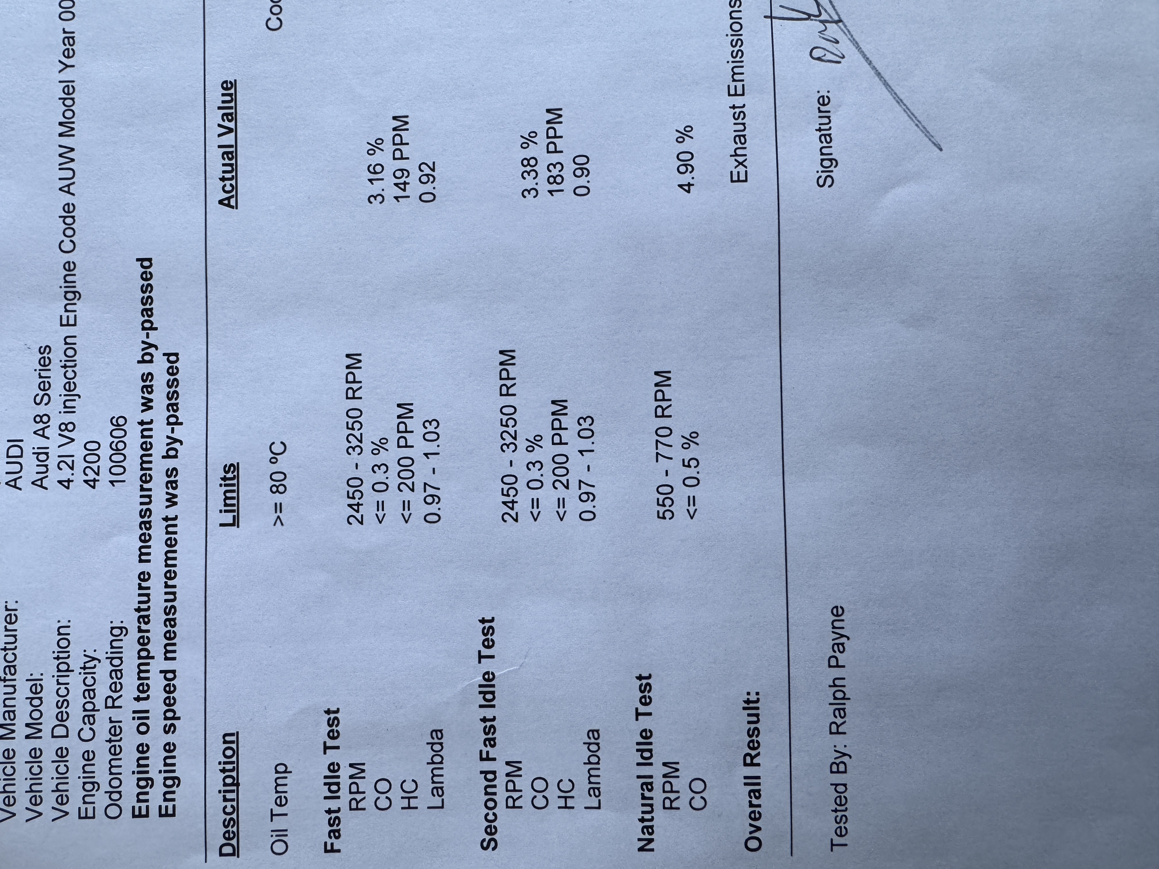

Just had MOT this morning and failed on emissions as shown. CO readings sky high and lambda readings low. Car runs spot on with no error codes/dash lights. Only had car for around 6mths and at last MOT had quite a bit of work to pass MOT including new lambda sensors as it actually failed on the same, exhaust carbon monoxide at last MOT. I fitted a milltek stainless system about 1 month ago - could that cause this issue? Looking at receipts it was lambda sensor 1 and 3 that were replaced for last MOT. What does this mean? Any help/suggestions please?

Probably need to check the primary and secondary lambda readings with VCDS to work out if it’s running a bit rich, or if the cats are not working.

To narrow down the cause, I would want to know if both banks were reading the same. If they are then the cause is likely in the admission. If not then in the exhaust.
I'd also want to know if the car's lambda sensors were reading the same as the gas analyser. If there's a significant different that could point to a dodgy sensor or a pre-sensor exhaust leak can cause wonky lambda readings. The SAI could be a source of this if a combiner valve has failed, letting air into the exhaust manifold.
If the car has been modified, then who knows what warnings have been coded out.
Also check the trim to see if one side or both is running rich.

Yeah, good point L to R as well. And I was thinking looking at the reading of both Lambdas each side would help correlate. But main point of my post was so say I'm less convinced it's SAI related since, whether coded on or off, since it only runs for a couple of minutes. Could certainly just be an iffy map though couldn't it.
Re: MOT fail this morning on emissions
Yeah, I don't think it's SAI either. Unless it's a combiner valve, and they do fail. But that would mean readings off on just one bank, unless very unlucky. Similarly, one bank being off could implicate an injector, spark plug, coilpack, etc.
I suppose the new cats could be been incorrectly installed, allowing a leak on one or both sides.
I guess with the tools you've got available, you can check the pre and post lambda sensors readings with the Vagcom, on both banks. That will give us a bit more info than we've already got. That and the trim, and MAF readings. Belt and braces, innit.
