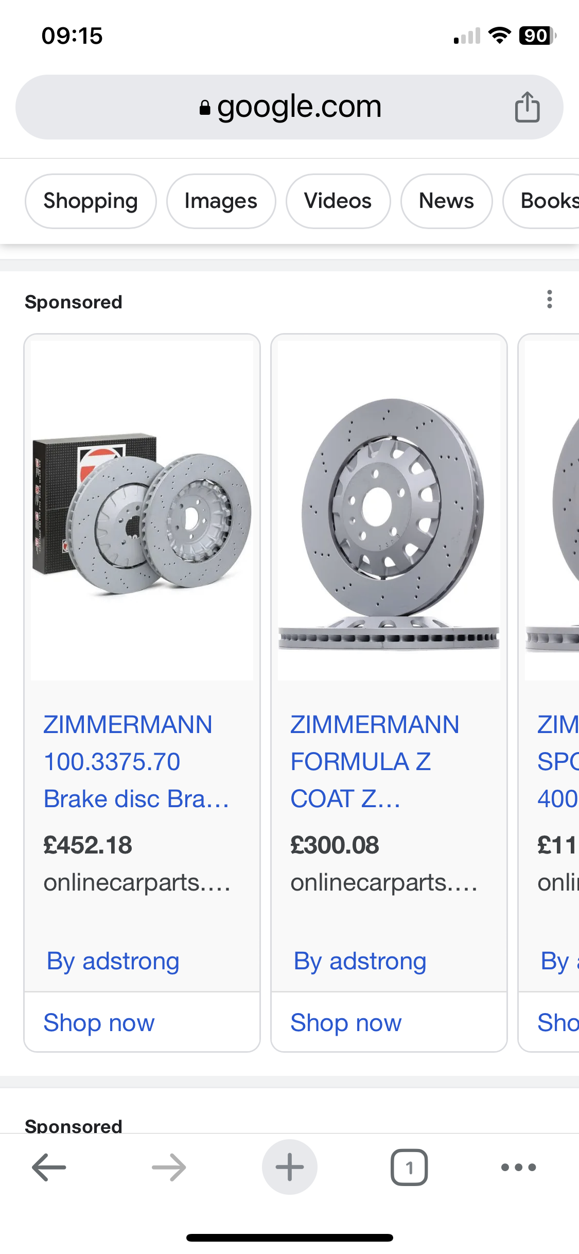

I just googled Zimmerman brake discs for 2003 Audi rs6 c5.
Loads of Zimmerman discs came up.

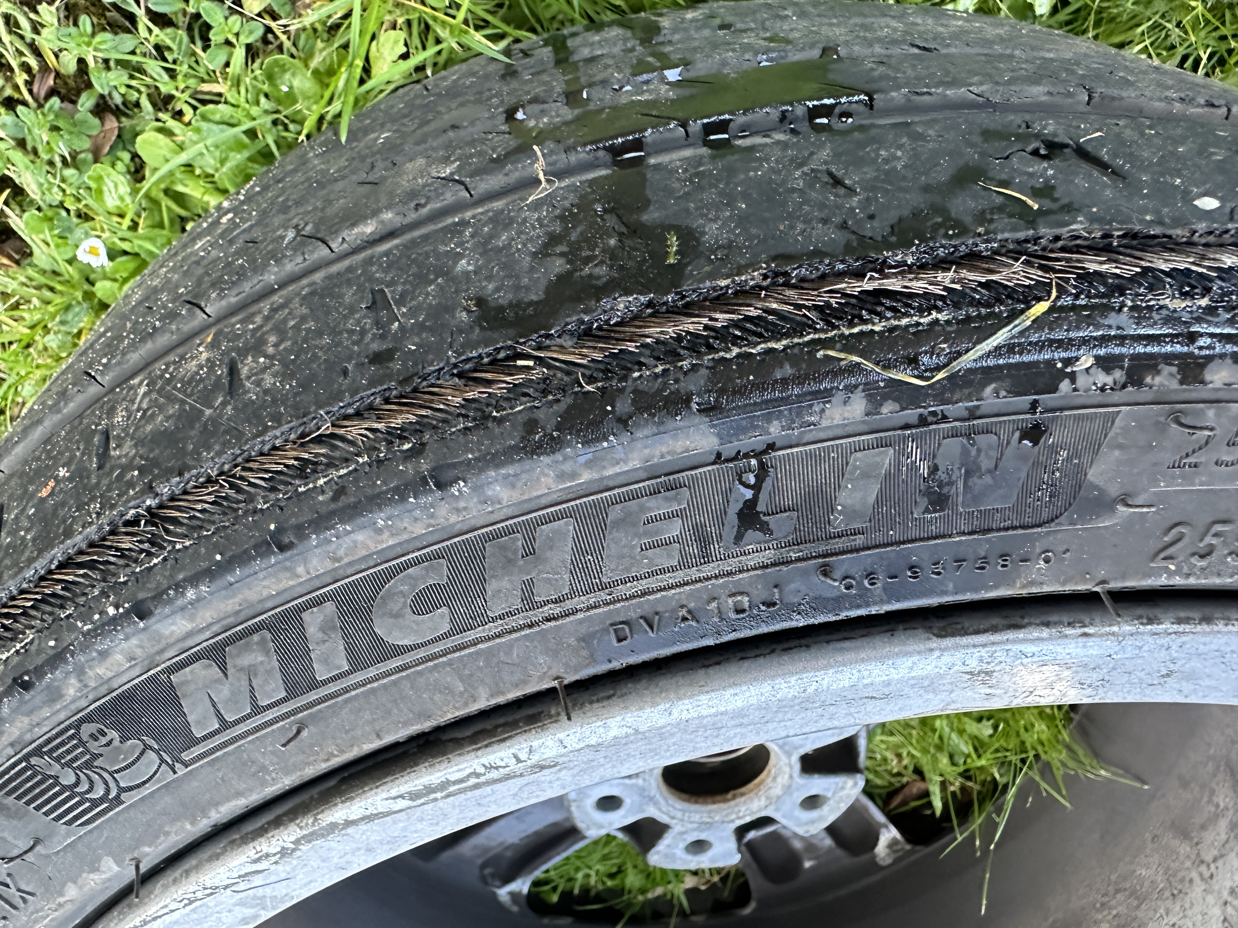

Ok. It’s been 6 weeks since doing the front brake discs. I recently had a vacuum fault which caused the brakes to become really heavy and am now dismantling the car to investigate. With the wheels off I’m very alarms to see that both front tyres are experiencing massive shoulder wear which makes me somewhat worried. I gave these wheels a jolly good wash whilst doing the brakes and there was no way I’ve have not spotted this…
I think the Zimmerman disc is not quite as tall as the OEM Audi disc.

Won’t have anything to do with the disks. Can’t see how it could.
Looks like it’s been gouged by knobbly on the hub carrier. Weird for Michelins. Are they the right size?

If the thickness of the bells are narrower than OEM it will reduce the front track slightly.
These are 255/35zr19 which are now 2 1/2 years old. 6 weeks ago they were fine.

That’s not a tracking problem. That looks like a contact point. What pressure do you run?
Maybe put some tippex on the knobblyto see if it gets rubbed off by the tyre.

What’s the load rating of these tyres?

Re: front brake pad recommendations
There isn’t any markings or rubber deposits on the knobbly bit, nor is it polished. Just the same finish as the rest of the upright. Will check load rating shortly
Tyre pressures 3 bar. 96Y "extra load" load rating.
Fine for 23,000 miles
Thickness of Zimmermann disc at wheel bolts 7.5mm, will check original disc which are still around later.
Tyres were getting close to wear limits but obviously want next set to last 20k miles too.
