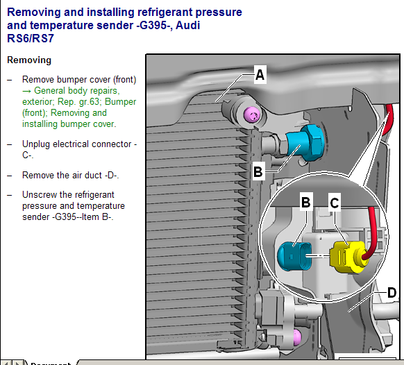

I removed the cover to get access to replace the HP AC pressure switch on my RS6 C7
Cant see where it is it’s near the passenger front light but where
Anyone got pictures mine is 2013-14 model

ELSAwin shows it here: (presuming it is the combined temperature and pressure unit)
[second picture shows the general arrangement for non RS6]

Much lower down and usually a bumper off job to get to it

Definitely bumper off job. Just had mine done at dealers. Sensor, local wiring and ADAS calibration.
