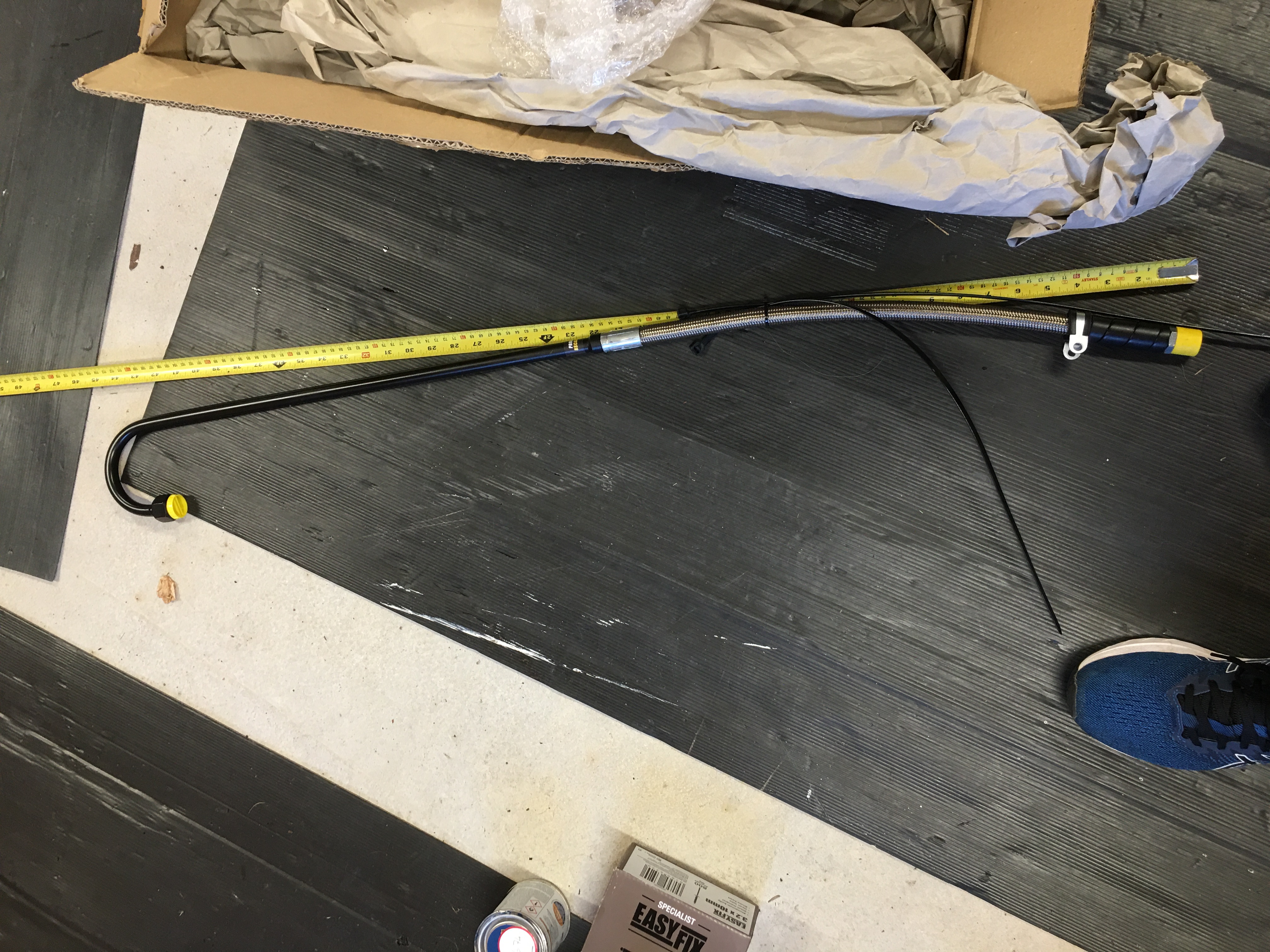

Post by cover99 » Wed May 31, 2023 9:42 pm
3 hoses for oil cooler lengths. Will add the relevant part numbers to the photos. Just need to double check them. Maybe of some help to someone in the future.
