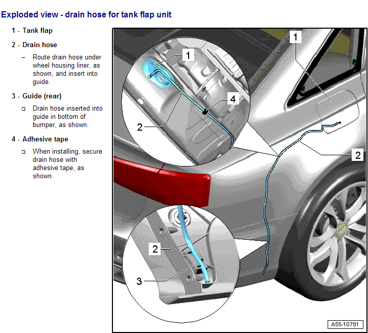

MIGHT be the drain hose from the fuel filler housing - maybe be worth pouring some water in the housing to see if it drains out of the hose to confirm (with the petrol filler cap closed of course :bigblink: )
[picture on ELSA shows saloon but gives the idea - it is well worth getting ELSA for yourself if you plan any DIY repairs]

Thanks feeltheburn, will definitely do that, appreciate the response. If it is that hose then it must have come loose.
