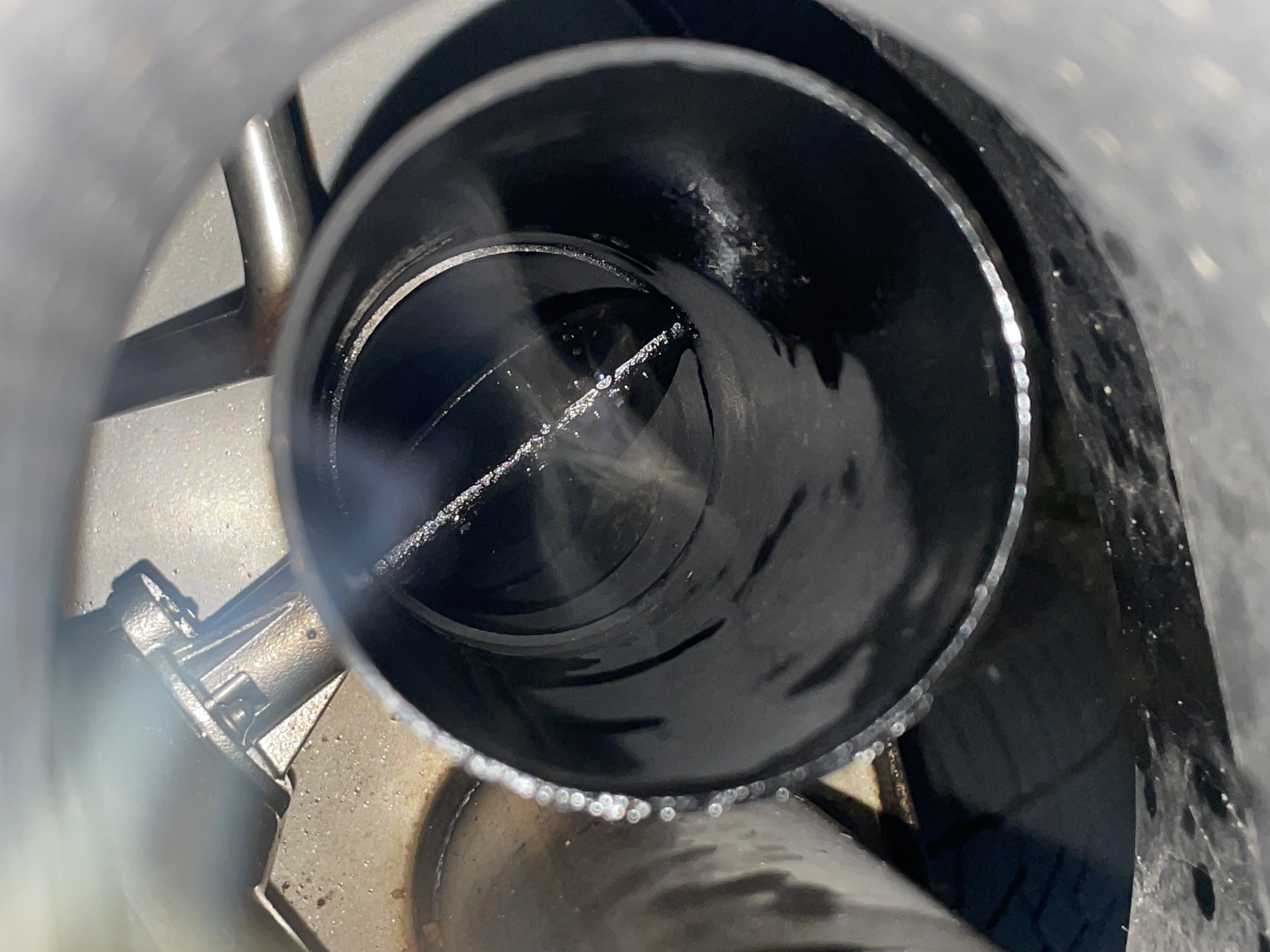

Try checking what I wrote, check your valves
Re: Miltek Cat Back Exhaust Drone
I checked, both seem to be open all the time. I looked in with the car turned off and last used with engine sound set to comfort, and both are open, started the car and turned Drive select to Comfort but the valves didnt close, turned it to Dynamic then back to Comfort and still no movement. I could feel a wire going to the valve control so assume theyre connected which would suggest theyre both stuck open.

Some research suggests then being open at idle & parked is normal, engine was cold too, so i dont think it means anything then being open today?
Checked again this morning and valves both close no problem so I think its just the none resonated centre section thats causing the drone.

Hello, if valves closing in comfort and open in dynamic then you exhaust works just fine, and it’s none resonated Miltek seems to me, I also own that exhaust, when in comfort and on a highway everything fine no drone, only when dynamic mode I hear then some drone.
