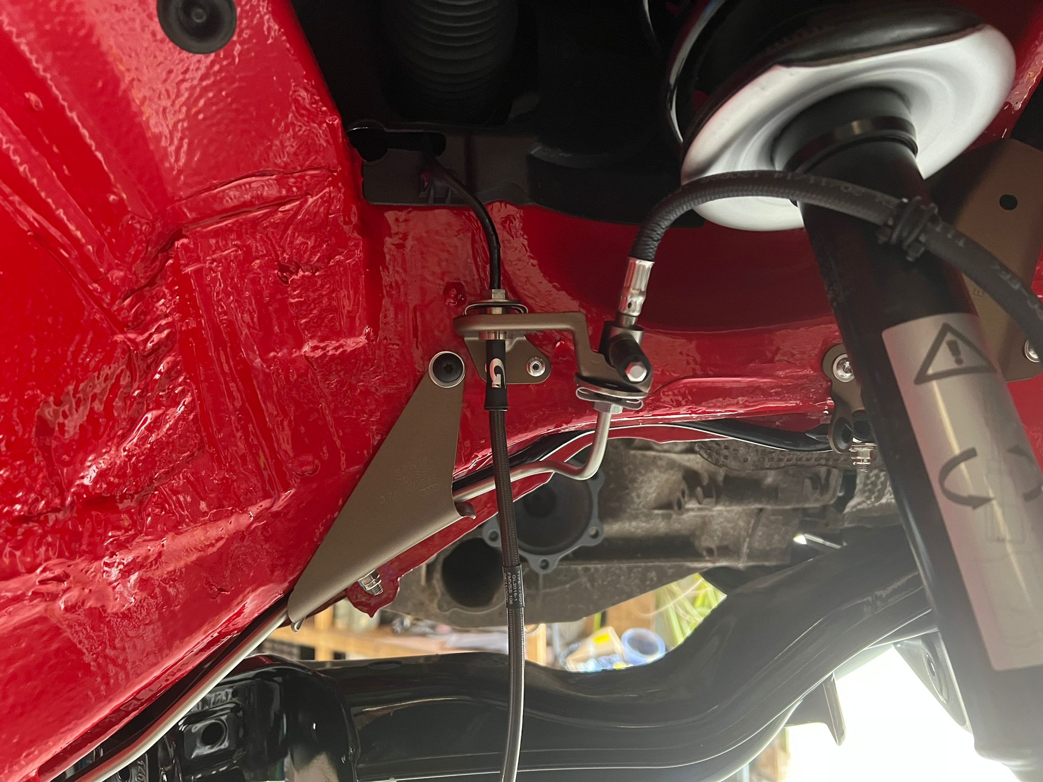

Front end parts lined up and ready to be fitted.
The old bits have been cleaned up and refinished so they can be re-used (where possible) Even the brand new parts have been painted so they all colour match once assembled.
SS+ springs and dampers.

Front end is really starting to come along now. Some of the front suspension parts have been fitted along with a new sump due to the old one being corroded.
The stuff in the engine bay is letting the side down now but that can wait until the engine is removed in a year or so.
Power steering pipes not looking too great though...
