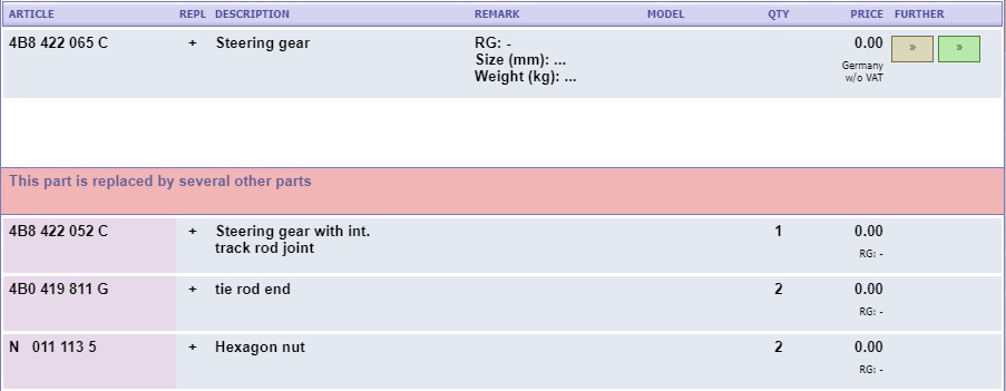

BTW Steve, I found the answer to the part number conundrum for you and it's exactly as Ben reckoned:
Re: Steering rack suitability
I'm also seeing that people are advertising the 4B8 422 065 rack as fitting the RS6, but then according to the parts catalogue, 4B8 422 065 C is the correct part, and the non-suffixed part number is for the V8 S6, not the RS6. So be cautious on your ebay searches.

There's no bet - it certainly will, as per the screenshot above.
