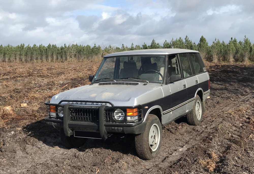

This is my Rangey V8 EFi (flapper) in its natural environment after I took it out for a jolly the other day:
Such a competent off-roader, even for 70's technology. Some of the terrain I take it on would have a Q7 or X5 crying for its mummy. Engage diff lock and off you go.

Interesting - a LHD one? With mismatched tyres? :bigblink: :thumb:
I alweays really liked those old Rangeys - but the ability to pile junk in the back of the defender (and my 109 V8 before it) always felt more useful to me. And now with some foldable rear seats - the twins love the "high up" view they geat from the rear seats, although I have just ordered a rear step so they can get in from the back. Would still quite fancy a V8 110, but the 90 is just a bit more maneouverable (I''m not going to say nimble) while still having a 3.5 tonne towing weight.
Is it a 4-speed manual in yours - LT95 "santana" gearbox I think? With Fairey overdrive that crunches when you disengage because the synchromesh always wears?

Yeah, the mismatched tyres really hurt cornering speed and lap times. Fortunately, when I'm up to the hubs in mud, doesn't seem to matter much.
Unusually, mine's a 4 speed auto. But with diff lock and hi/lo ratios. Go figure.

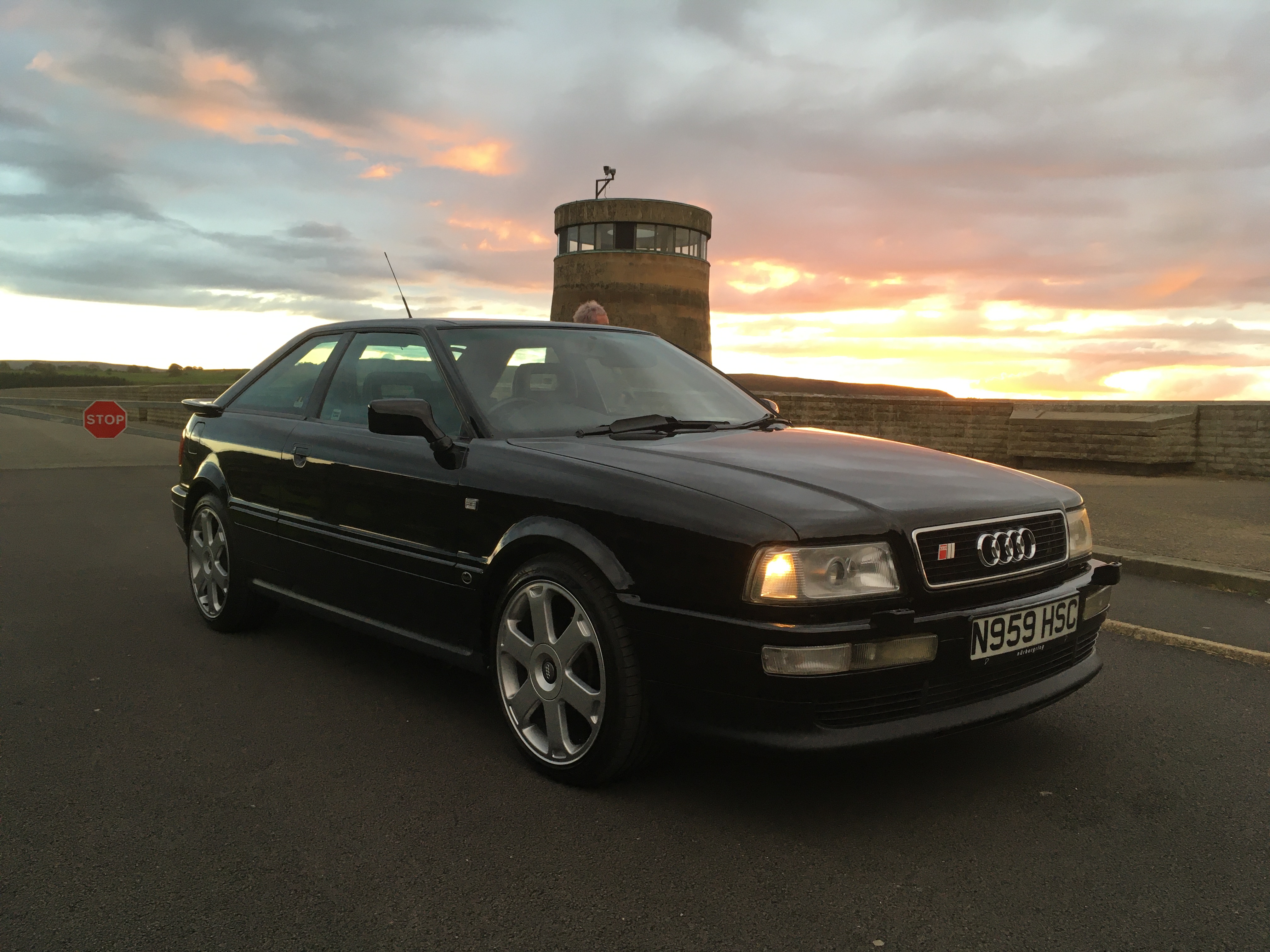

Something a little different to your lovely Landies, this is my little weekend toy and its been in the family since October 2000!! Gets quite a lot of attention and I still love driving it!

Wow. An S2. Haven't seen one of those for ages. Friend of mine had one with an RS2 engine, highly tuned. The turbo boost was a cliff edge and giggles were involuntary.

That's lovely. To me, this is "the" real Audi. I think our C5 RS6's are still decent, but very very different cars and worlds apart in terms of being a different company these days.
Back then, IMVHO, it was about quality. Nowadays it is about the appearance of quality.
