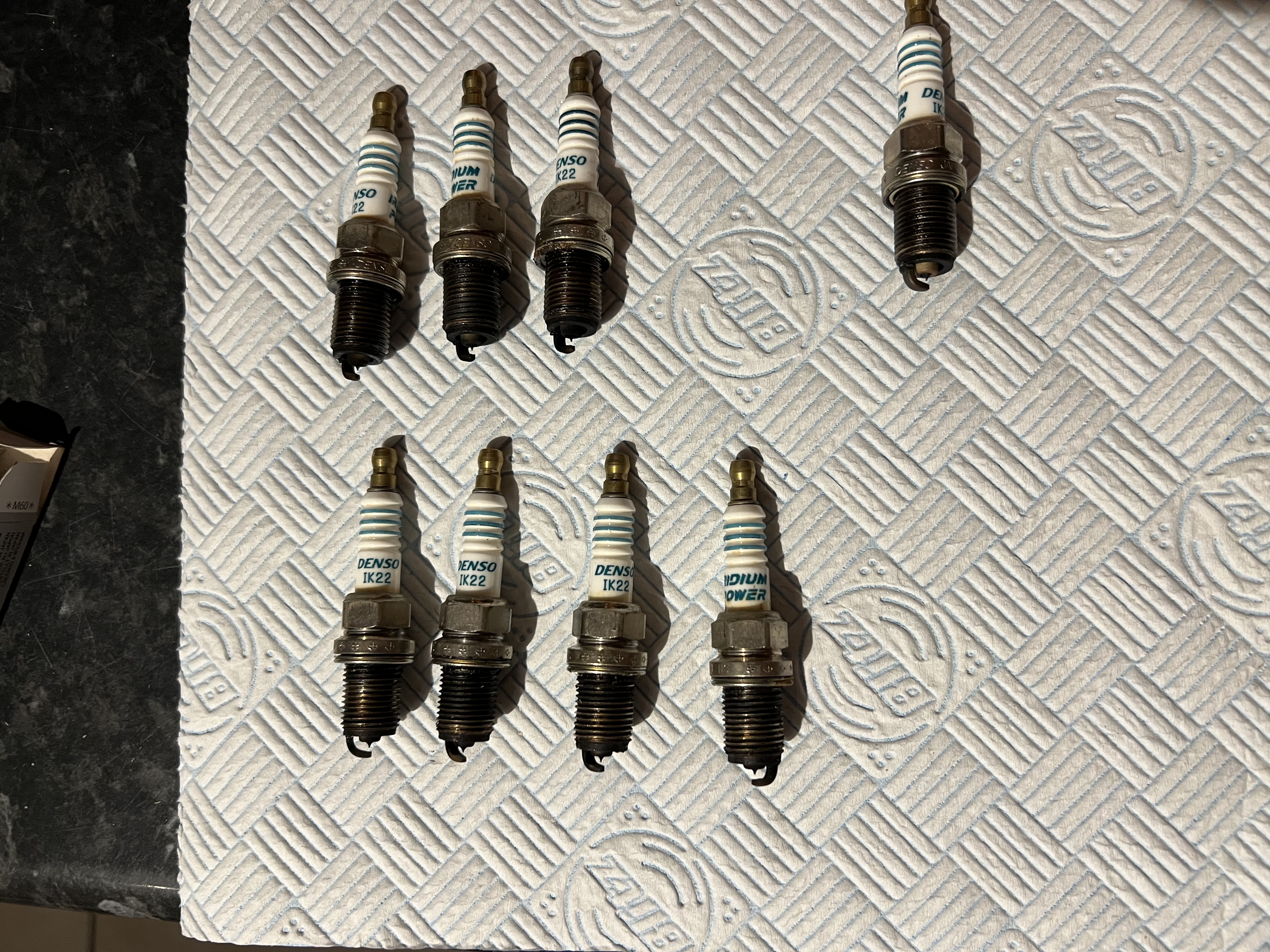

Well I discovered the Denso are very fine in comparison to the NGK, electrode tip etc

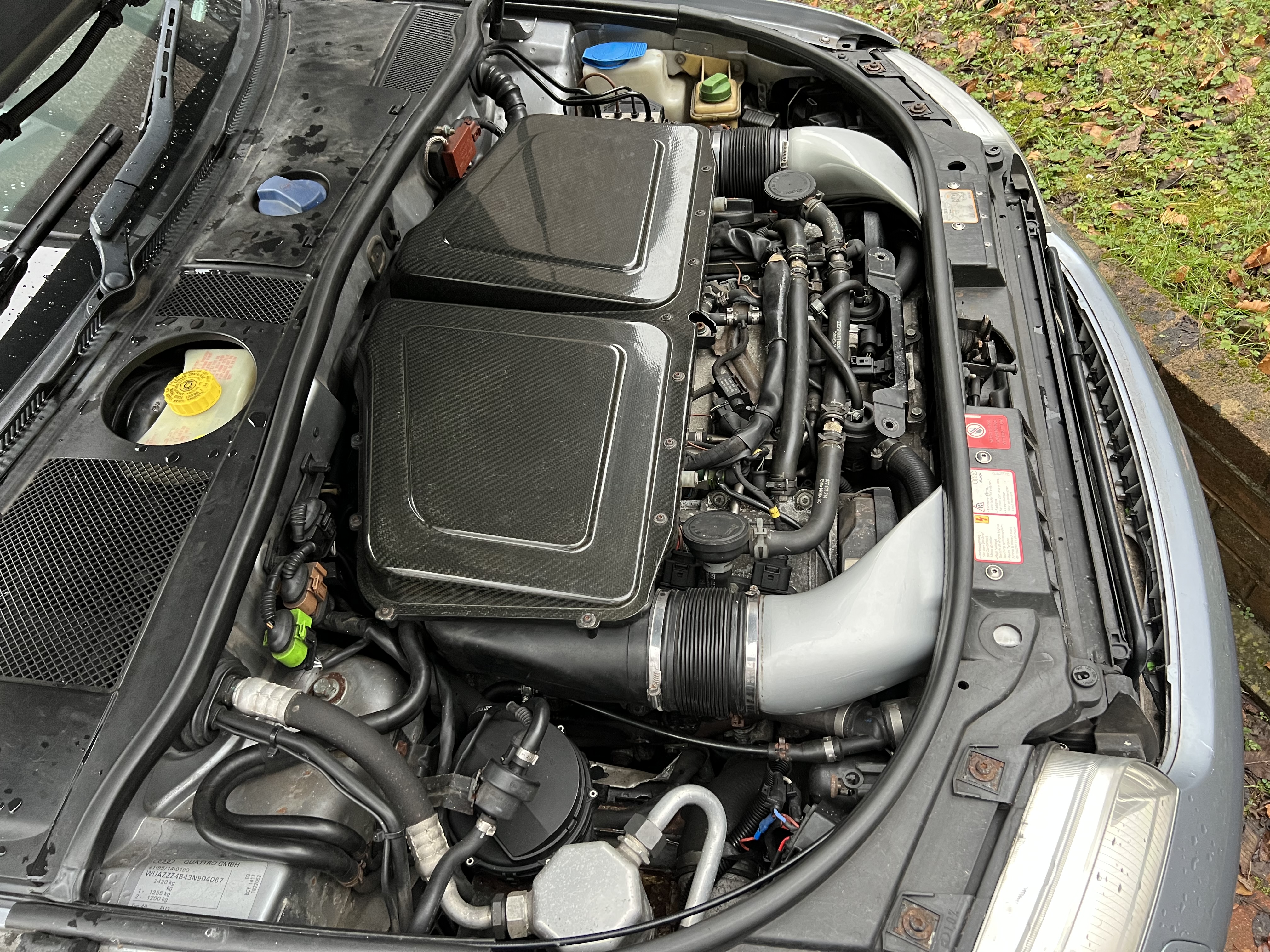

Anyway, here’s some pics of how it went

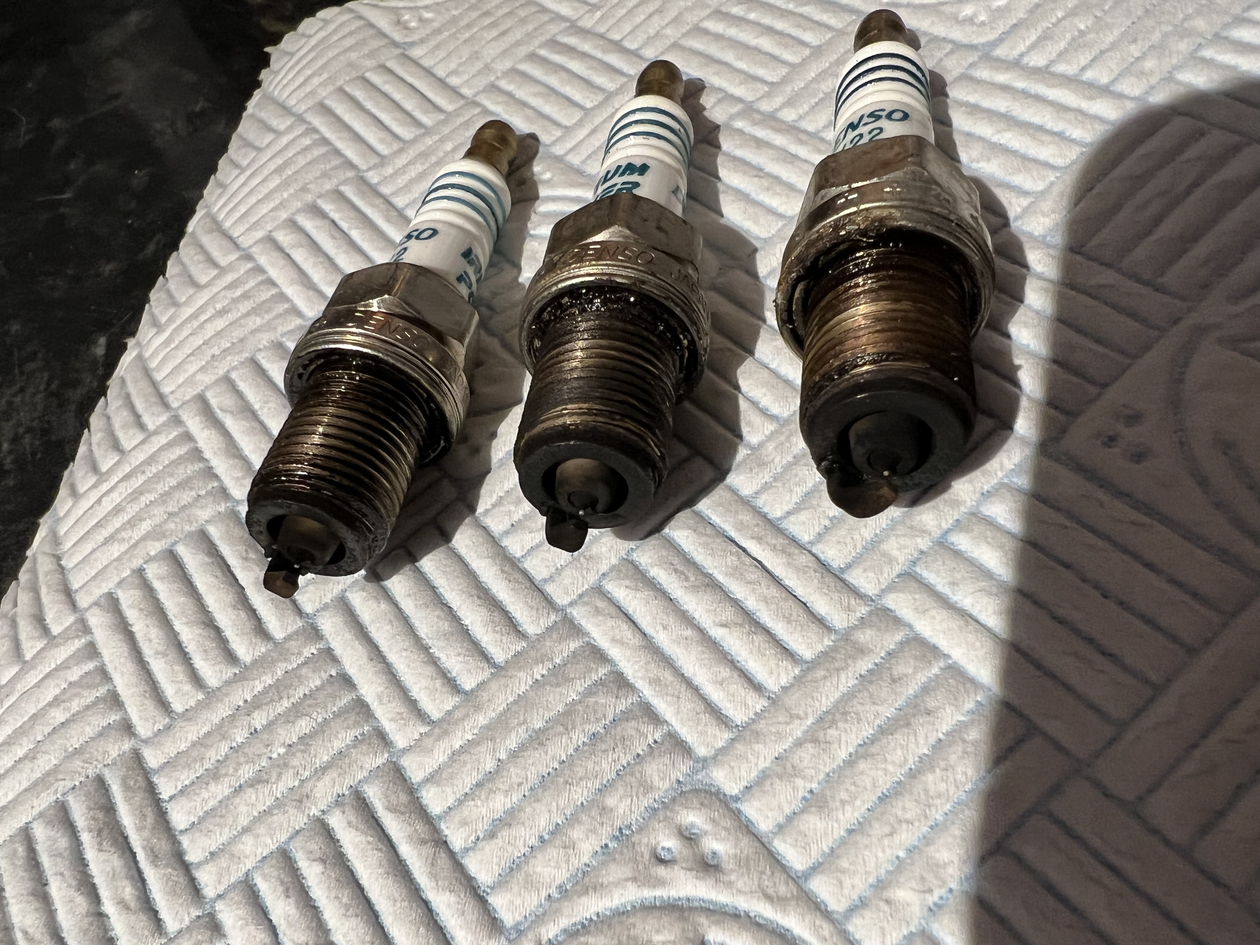

Here’s plug no 2
Compared to the other 3
They look healthy enough, but 2 does have a cleaner electrode which would indicate the non firing/coil issue
First 4 out and new NGK ready to go in
Cheeky in progress pic
Here’s plug no 2

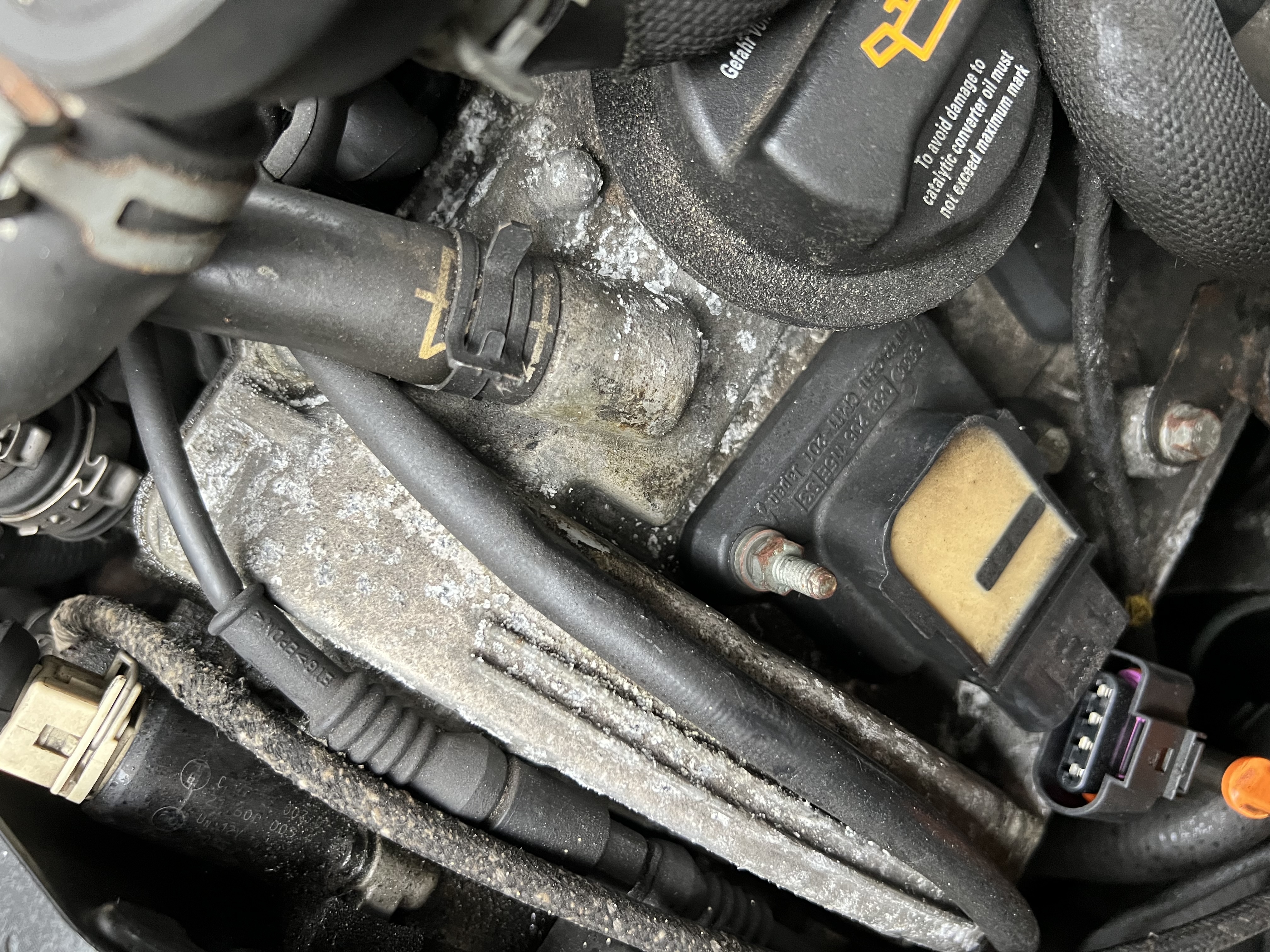

I found this on the other bank, first plug at front of engine
Is this normal? Or has somebody knackered a thread on a coil previously? It wasn’t even in tight, came out in my hand
I managed to get it to catch putting it back in, so it’s got a better fit now at least
