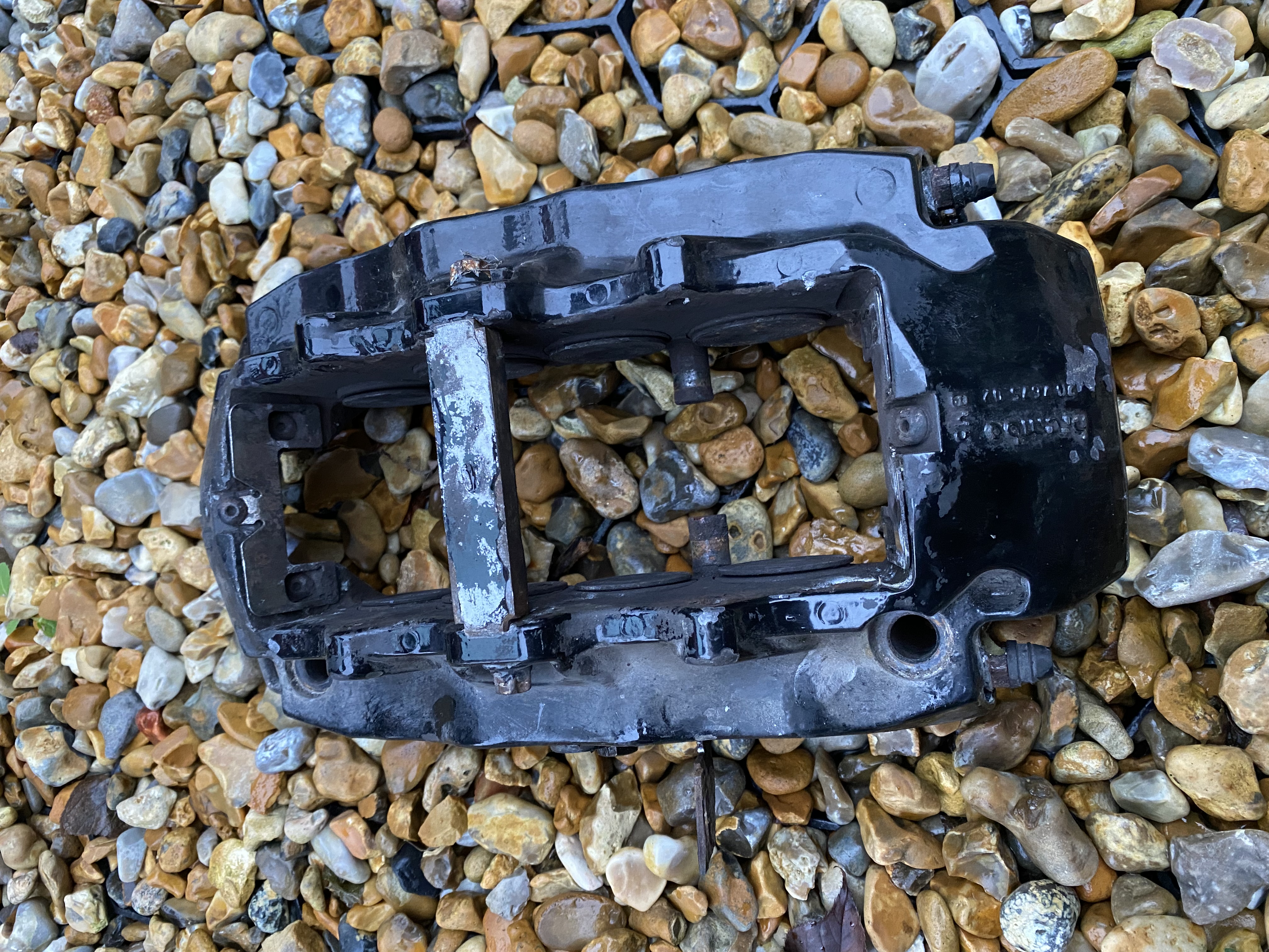

I've a few things on just now, so I haven't done much with the pair I bought.
Had some time last night and decided to get a look, and I started to pull one of the calipers apart. All pistons are very smooth and free.
Unfortunately, the mixed material curse kicked in, and one of the nipples sheared off..typical my luck, so that's the project over the next few days and to get my blasting cabinet up and running.
RS Calipers are notorious for seized nipples, need to pick up an M10 x 1.0 Tap for chasing and a set of easy outs.. pads were pretty tuff to get out and we're cheap TWR jobs..ImageImageImageImage

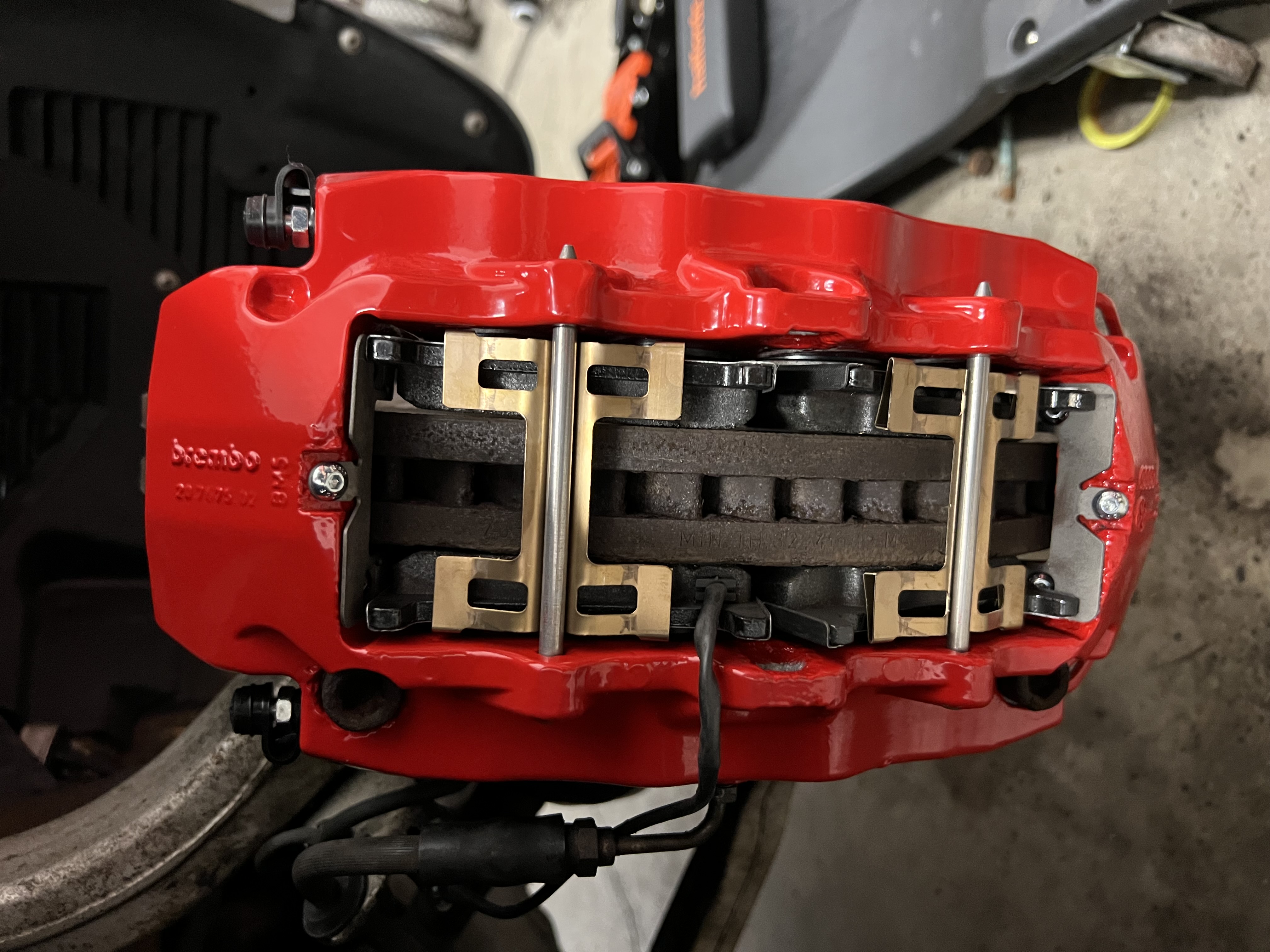

Chris, once you have removed the calipers thats it really, i even had issues removing my pads as my pins were seized also and Ian told me to leave them in and he would deal with them, very helpful guys
He removed the spreader bar on my calipers as he said most people dont refit them as they are not needed and only used for the first few years of the 8 pot runs, as you see with RS3 etc they dont have them now, he did powder them still and returned them to let me decide if i wanted to reinstate them, ive just left them off

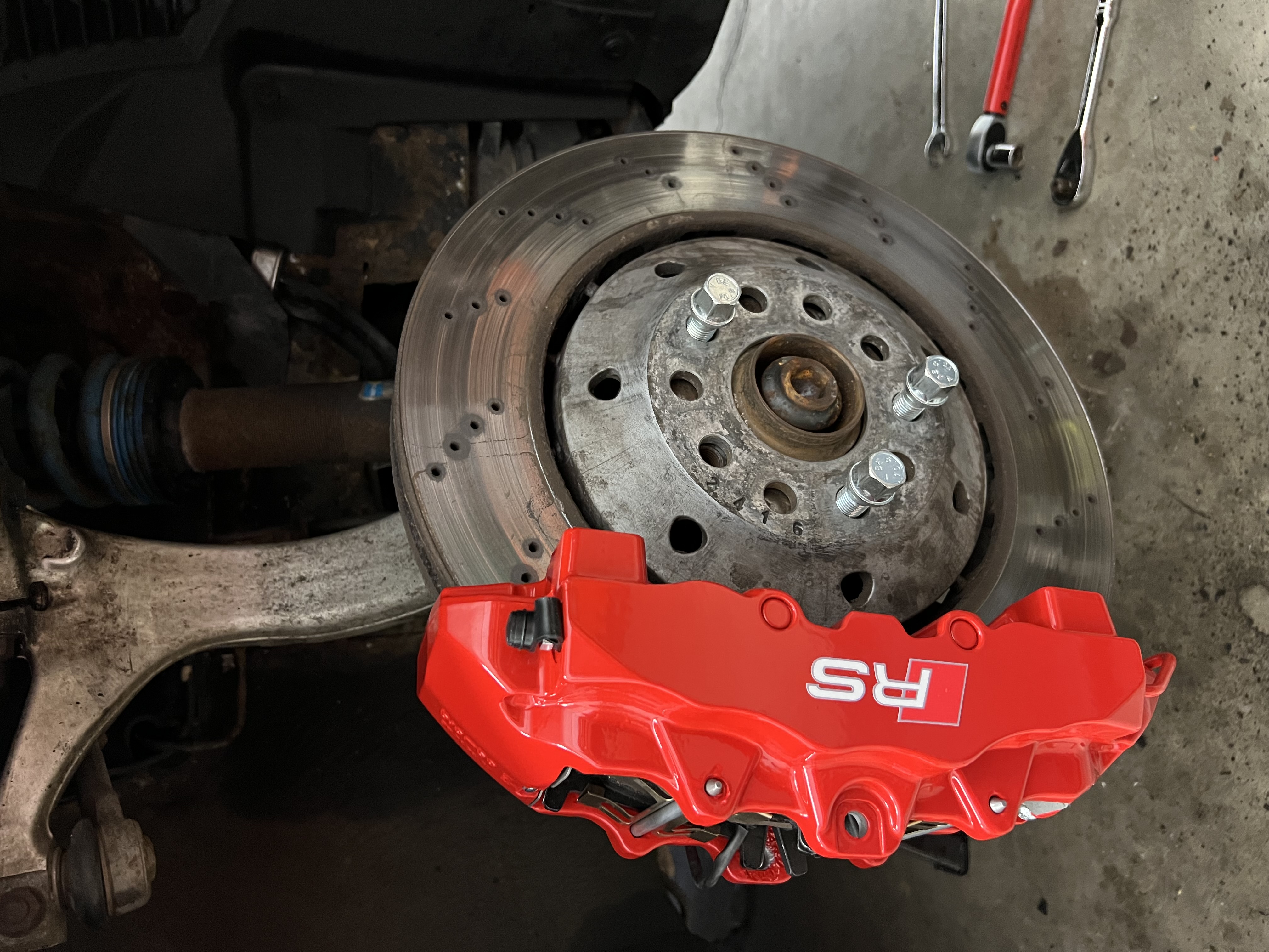

Sorry mate, had been busy with work in the lead up to Crimbo etc and havent been on much, heres some pics of mine fitted, i'll get better ones with wheels on also when i have a chance, currently battling manflu :cry:

Cheapest I've seen pins and retaining springs are 45 quid from addiction motorsports, my springs are fine but the pins are gubbed.
Had a major issue with two of the M5 Torx screws holding the shim plates in situ, total bastard of a job, the heads were badly corroded, so had to butcher them off with a combination of a small cold chisel and a couple of plain drivers.
Still struggling with this nipple, think I'll hand it in to the local engineering Shop, worst case scenario I'll get him to drill it out as close to the threads as possible then collapse the walls using a fine punch set, should get it out that way.
Still to order the seal kit, Fren-Tech kit is totally decent, I've used them before with no problems, by that time my blast cabinet should be up and running, get them cleaned up ready for powder coating, I'm just going for Black..

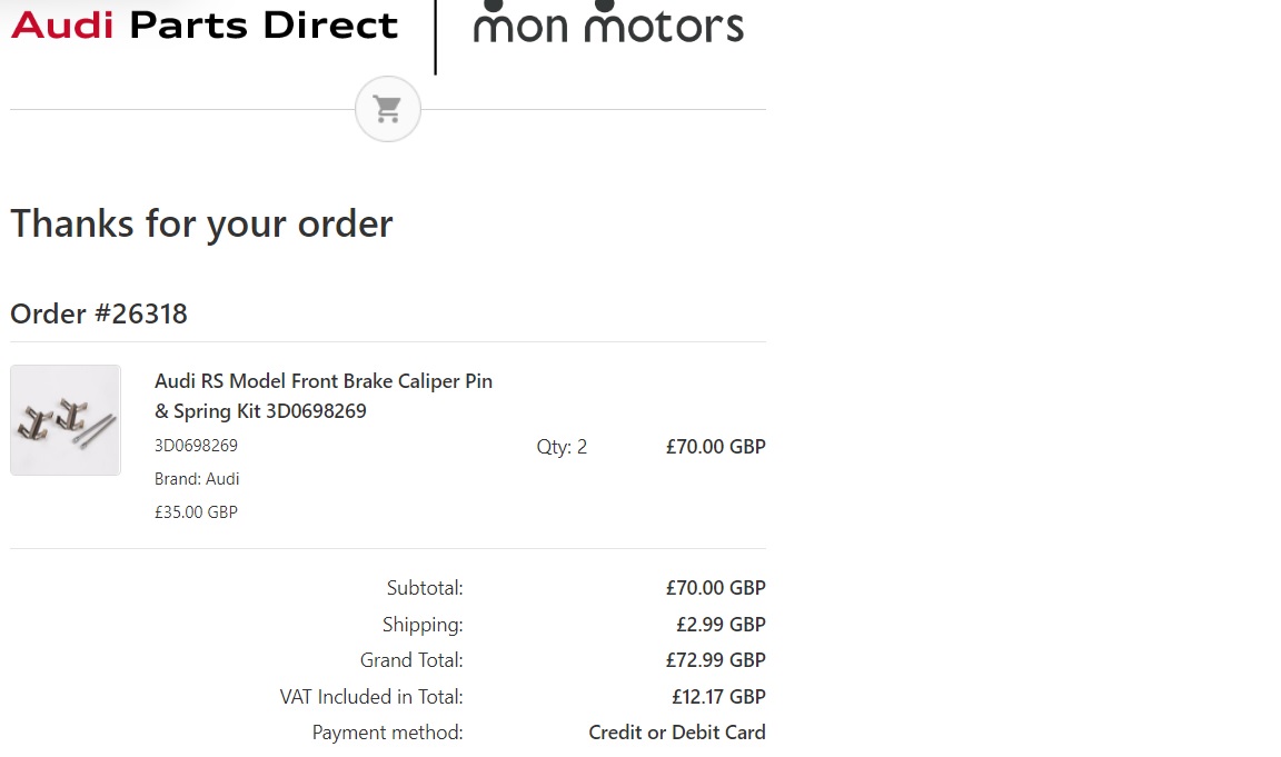

If i remember right, i dealt with addiction and his stuff isnt genuine Brembo, think it was around £50 for both calipers, but i found OE Brembo kits for £35 each so just went with genuine
Let me have a look, im sure i scoured Ebay etc, one from one place and one from a VAG parts specialist, i'll see if i can dig out the names, but they are becoming thin on the ground

Sorry, it was Audi Parts Direct and i found they had a pair, not sure if they restocked, worth an ask

Yes, they are after market, which doesn't bother me, TBH. My M10x1.0 Tap arrived unnoticed, the Amazon guy must have slipped thru my letterbox and never rung my bell. Bit lucky here, these are German Made, and got a 2nd cut and Plug for 5 quid delivered.

Foxmeister wrote:Sorry, it was Audi Parts Direct and i found they had a pair, not sure if they restocked, worth an ask
They have them in stock, 70 quid the pair.. outrageous lol..

As for colour, I’m going for misano red. There’s a little additional cost but I think it will look good.
