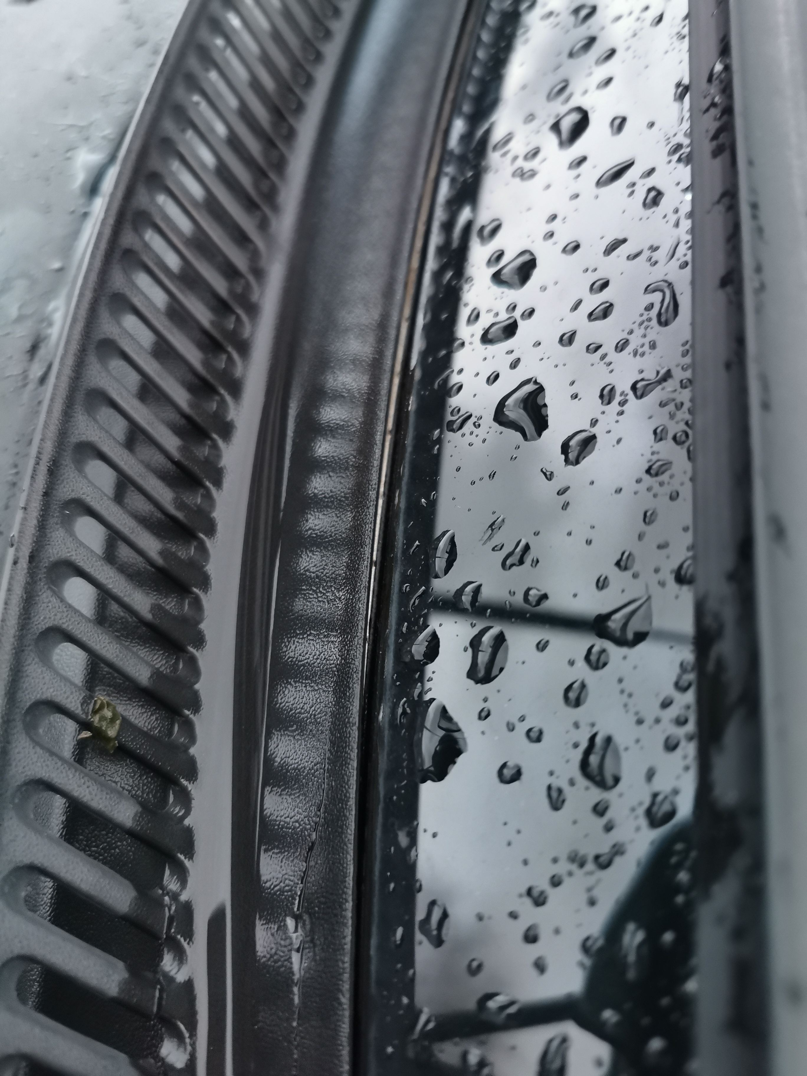

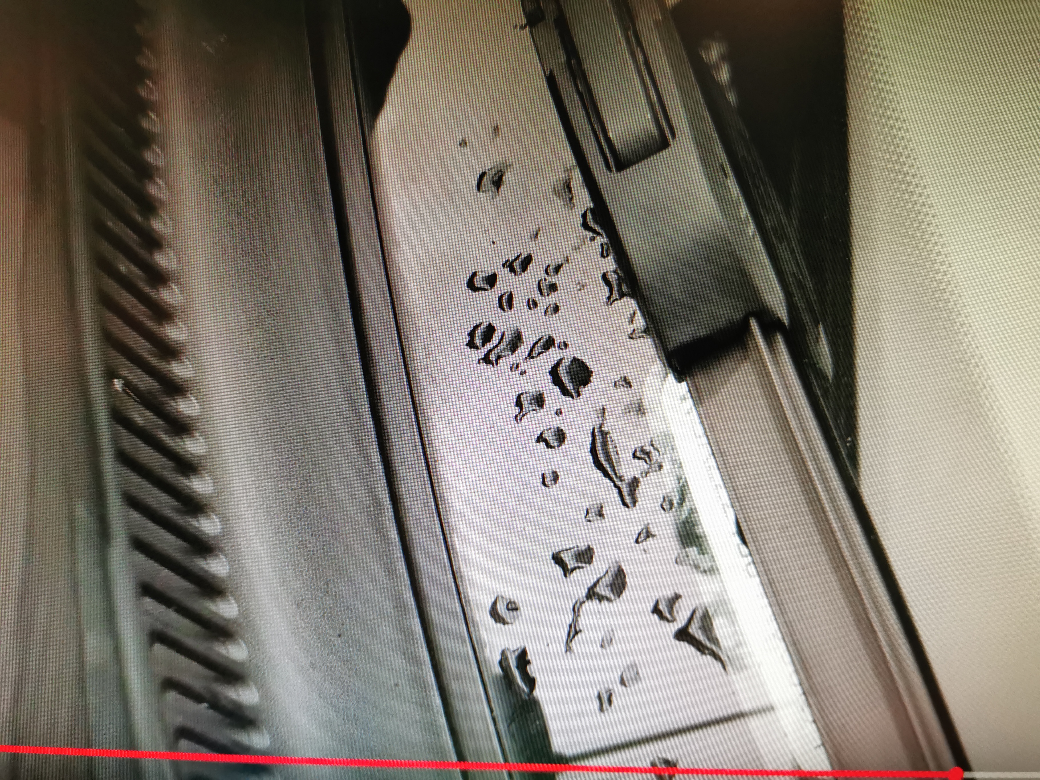

I also noticed on a RS6 YouTube video that there scuttle on the windscreen had a rubber seal/edge to it..... (Mine does'nt) both a screenshot of the video and a picture of mine below.
What seal can I get? Any suggestions.
Is this why I'm getting damp inside? Mine is away from the windscreen a little bit.

Shouldn’t have the gap. There is a lip on the windscreen water deflector that fits under the screen.
Mine broke when I had a new windscreen installed. So I had to get a new one from Audi main dealer. Cost was about £100 IIRC.
They are very fragile and need to be handled with care.

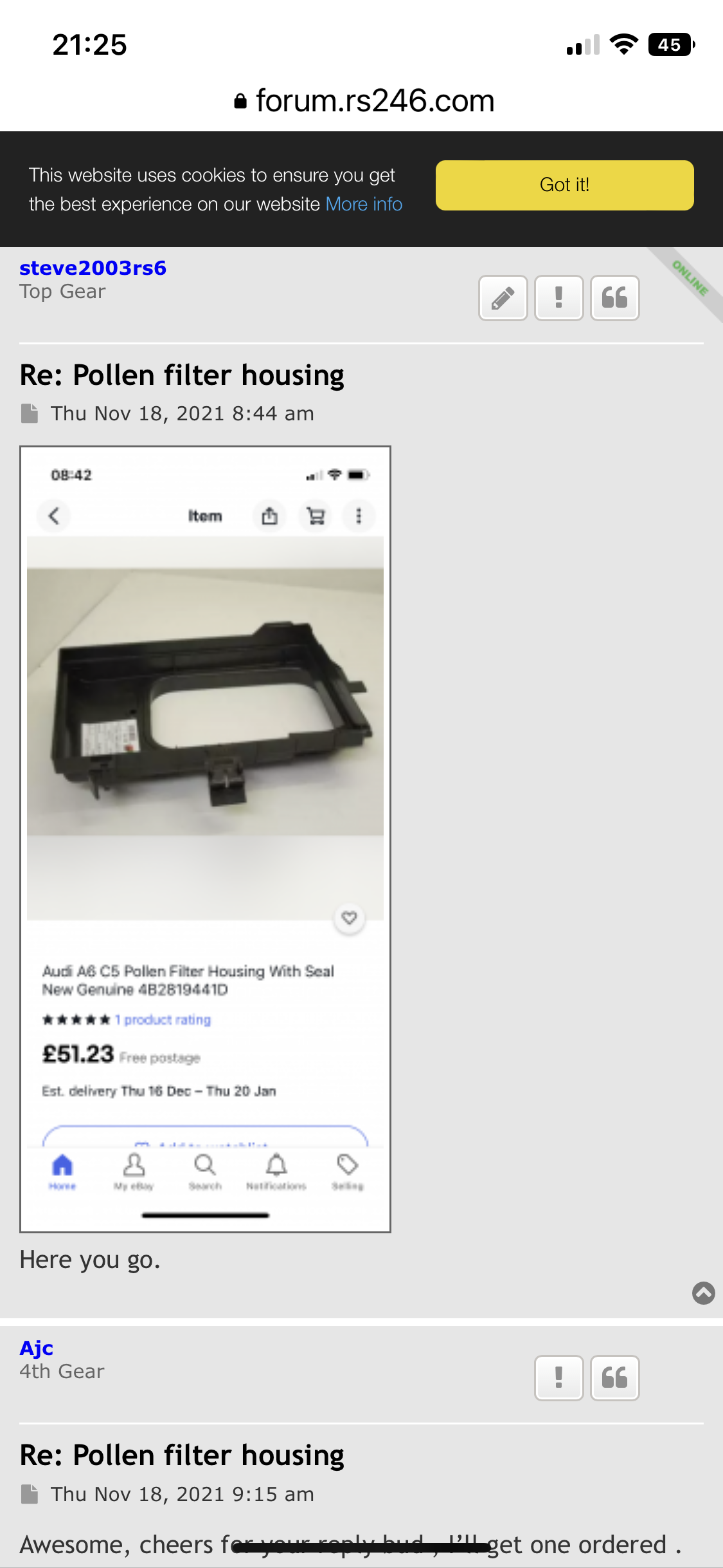

Gav. I don’t get the foam seal comment.
My original seal was rubber.
The new replacement seal which came with the new housing was also rubber.
I was lucky I replaced my housing and seal while the windscreen was out.

This one. Which I bought new off eBay.

Mine was definitely made of some kind of foam, mind you it basically disintegrated when I removed the housing.steve2003rs6 wrote: ↑Thu Nov 17, 2022 10:28 pm1F2CEA8B-7E15-4E2C-8617-548A005DEA86.png

My apologies. I stand corrected.
Yes it is a type of foam.
For some reason I convinced myself that it was rubber.
