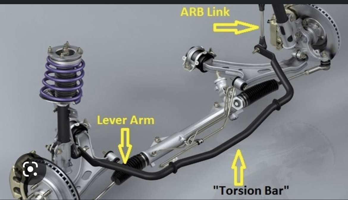

Thanks everyone for information, I have this knocking https://youtube.com/shorts/-I4jIfXouSs?feature=share
https://youtube.com/shorts/x38UUMcTA6I?feature=share
Not sure is it drc or something else, and this noise I get when I turn to the left hard when one wheel especially more higher than other, same sometimes happens when I turn to the right also when car not in horizontal position and one wheel higher than others

Check your arb links. can also cause a knocking noise.

Thanks for mentioning that, I definitely going to Audi dealer, that I have that noise and point them about that it could be drc refill time or these arb links. Or should I not mention them anything just tell that I have that knock sound, I can show on a video
P.S you mean those arb links in a picture I posted?
Or it’s this item https://m.autodoc.co.uk/ridex/8101055

Yes those are correct. As you have DRC part no is 4H0411317C. I try to use a decent brand such as Lemforder, Febi, Meyle
