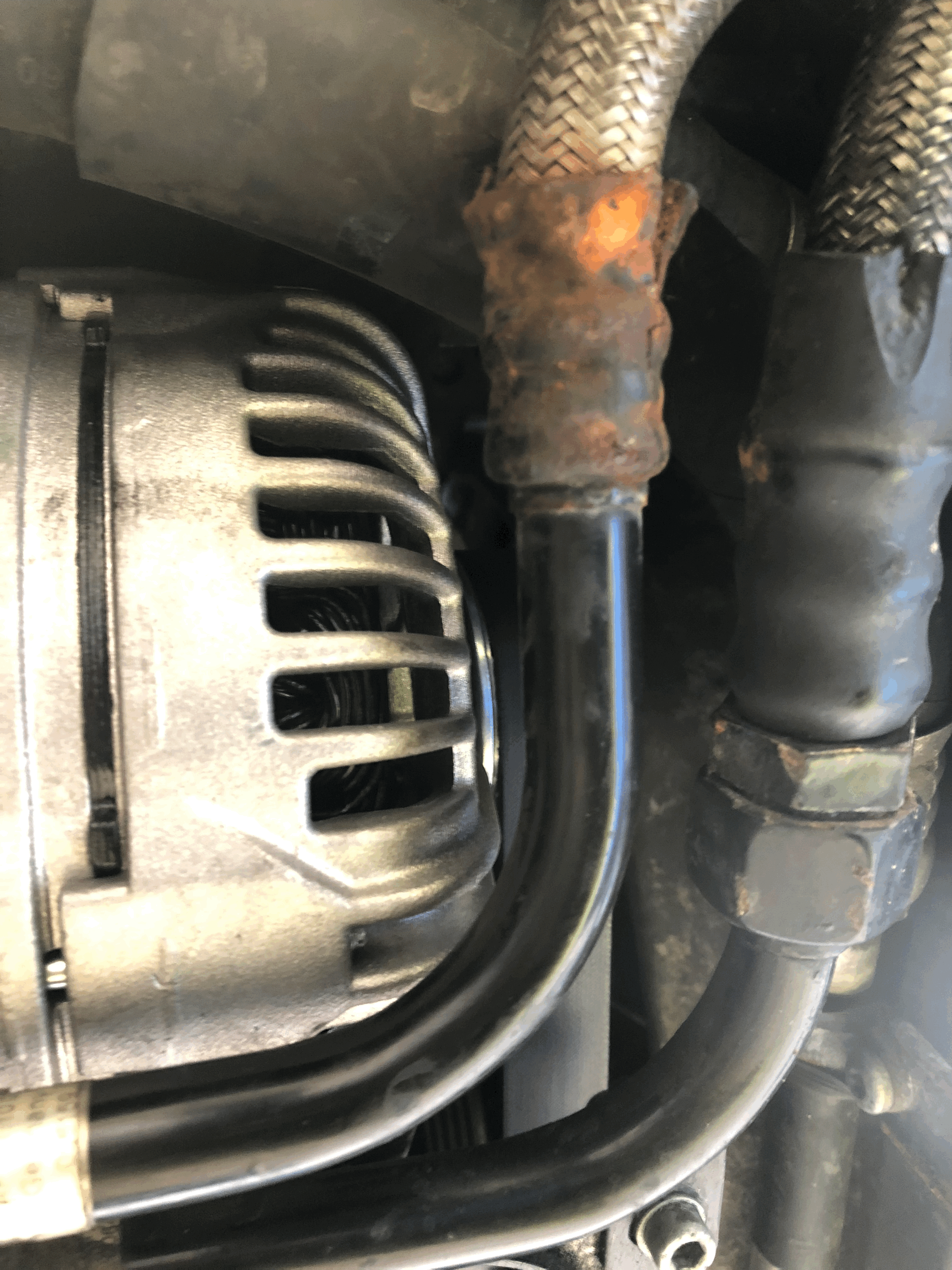

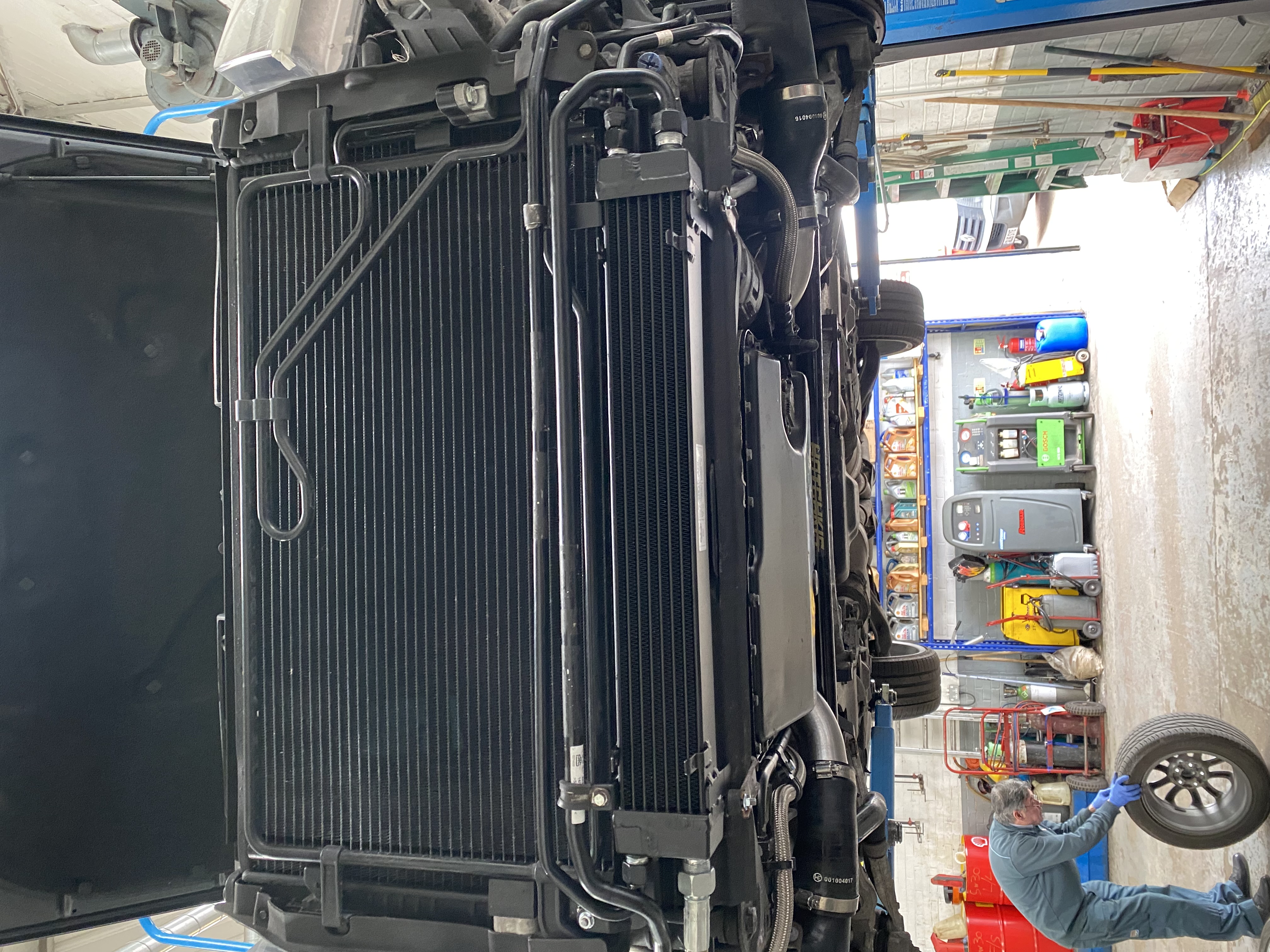

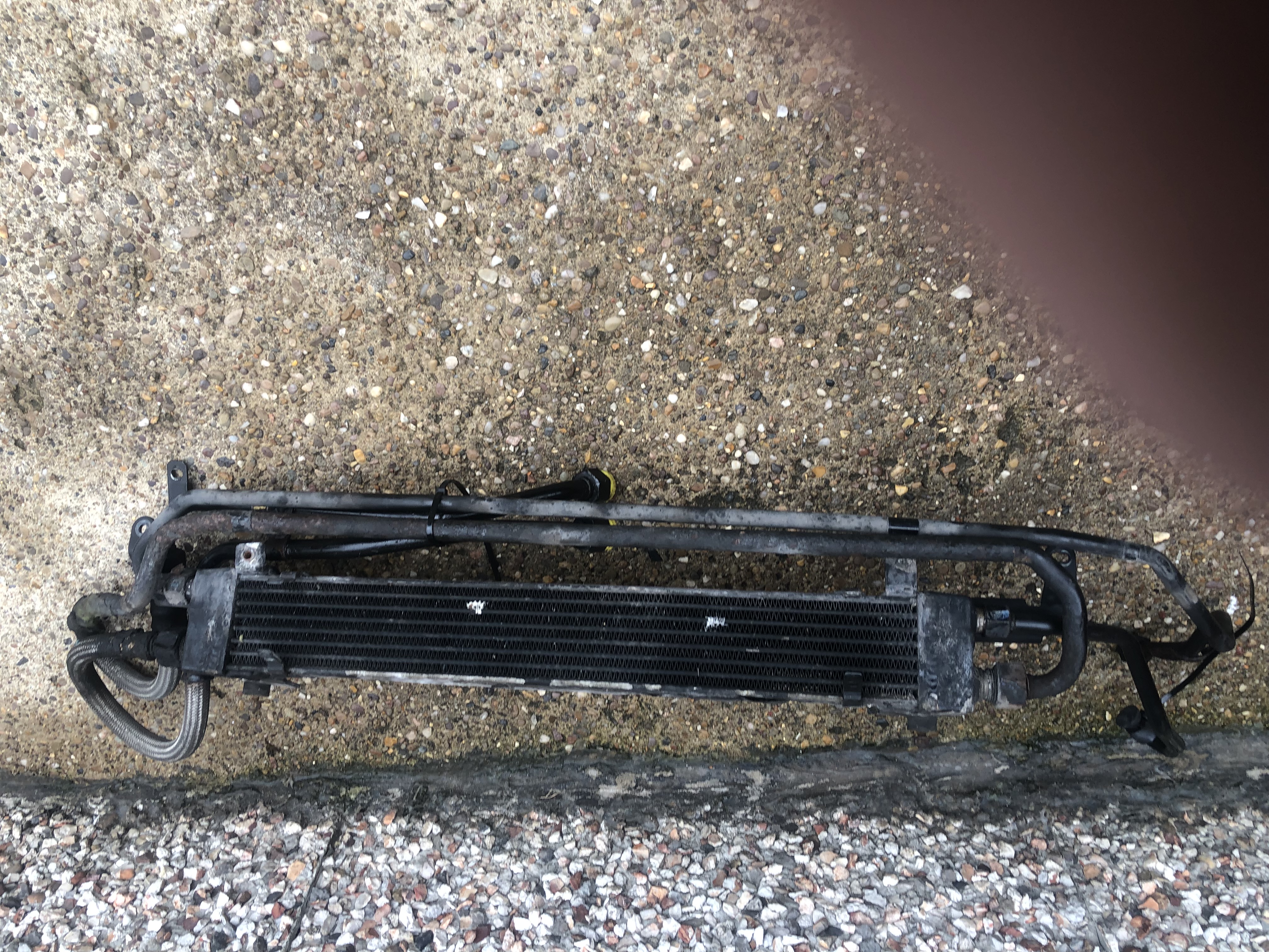

My DIY will replace the shorter of those 2 lines if you wish.
You could fabricate something to replace the longer line too if you need, but it’s a lot more work and a bit tight on the exit of the cooler on the LHS. If I have to replace my cooler or the longer line now, I’ll just build my own custom setup I think. Actually doing one for my LR just now….

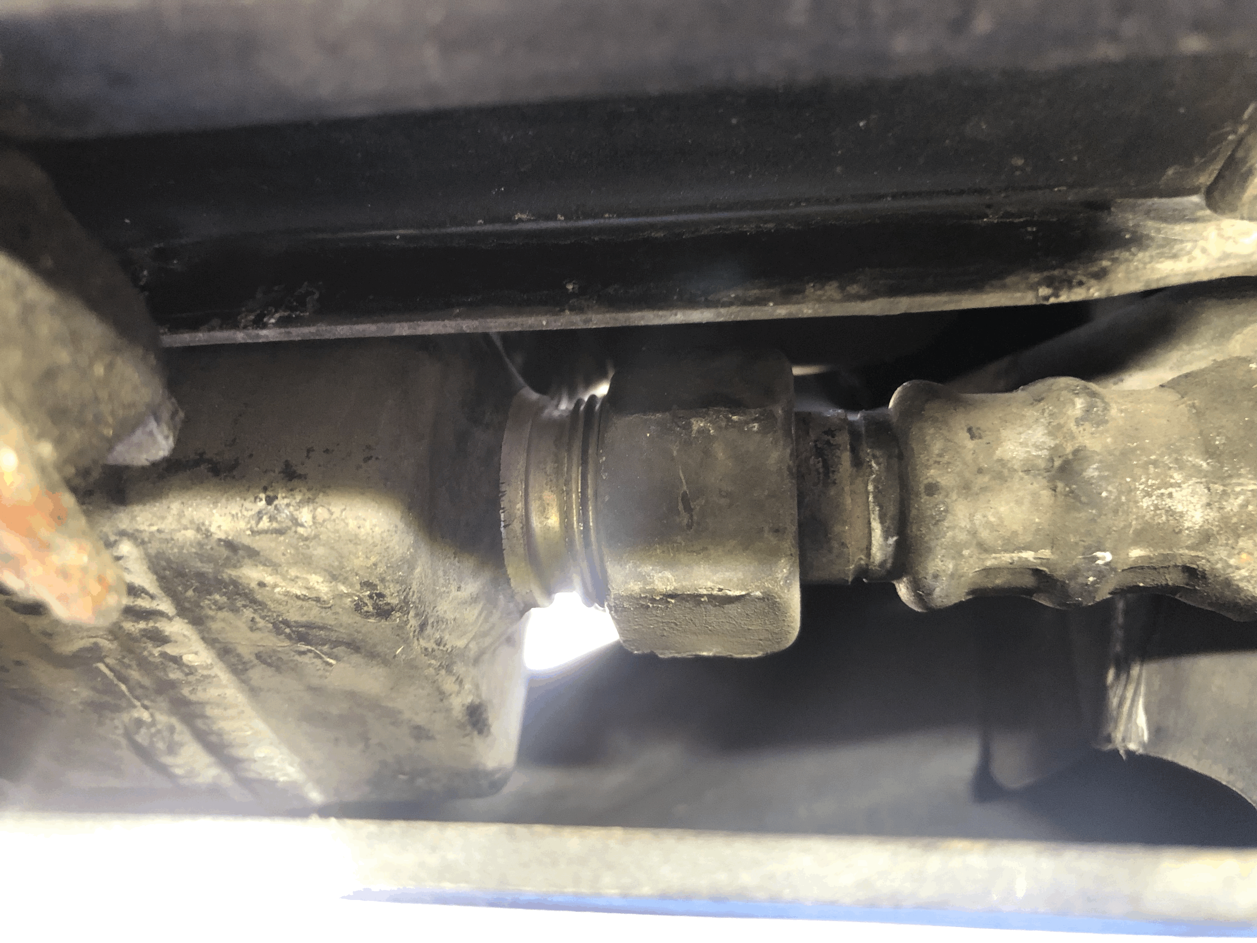

Astro ....Do you know the size of the nuts? quite a large diameter by the looks of them?

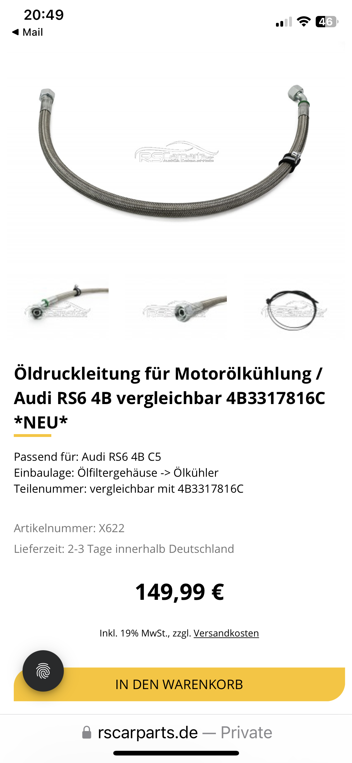

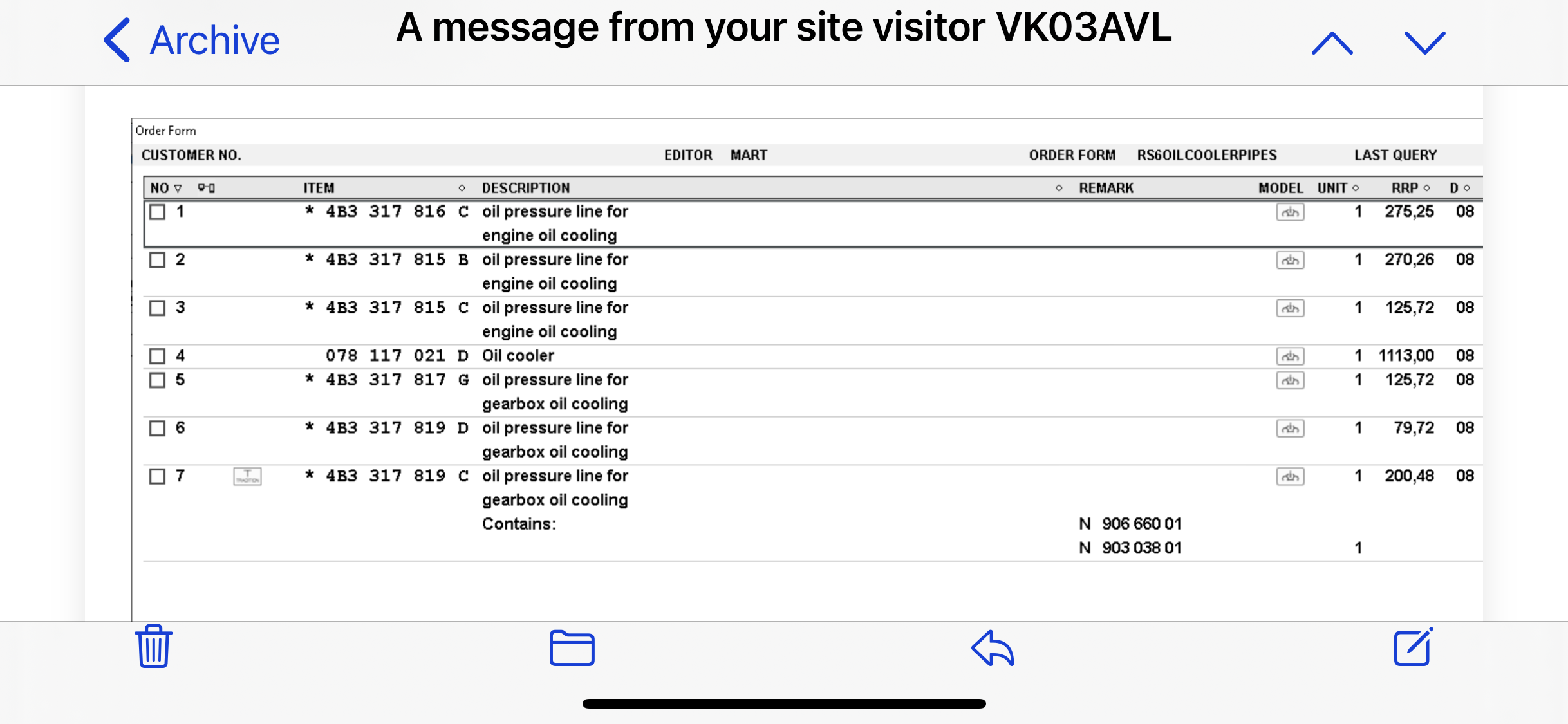

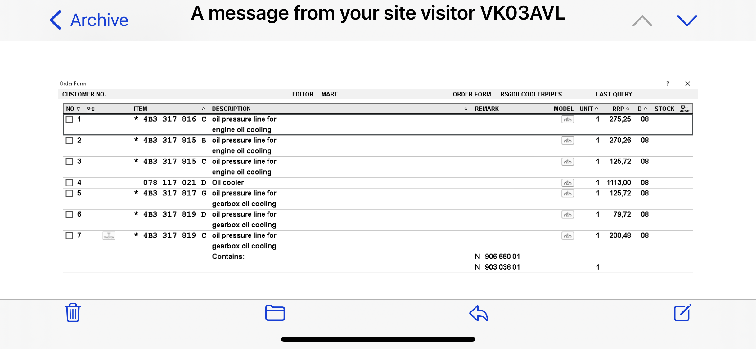

Just bought the oil cooler and 6 hoses/pipes from RSCarparts
Grizz gave me a list of bits needed. Managed to source them all from RSCarparts.
They are not cheap (nothing is on the rs6) but really good quality and it keeps the car standard.
Hopefully get them fitted next year.
Ps I think the prices quoted are euros.

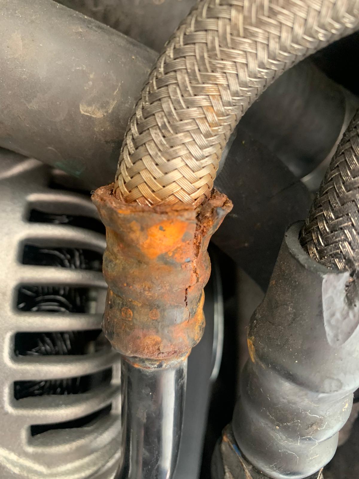

4B3317815C seems to be the part no for the combined flexi to solid hose that goes from oil cooler to oil filter.
No longer available from audi but two local hydralic hose fabricators ( in Watford Herts) think they can replicate ( or replace the corroded joint)
Now just got to get them off and put them to the test.
I'll let you knoe how I get on.

I have provided the above to captain Ric.
But for anyone else these are the parts I recently had fitted they were bought from RS Carparts in Germany.

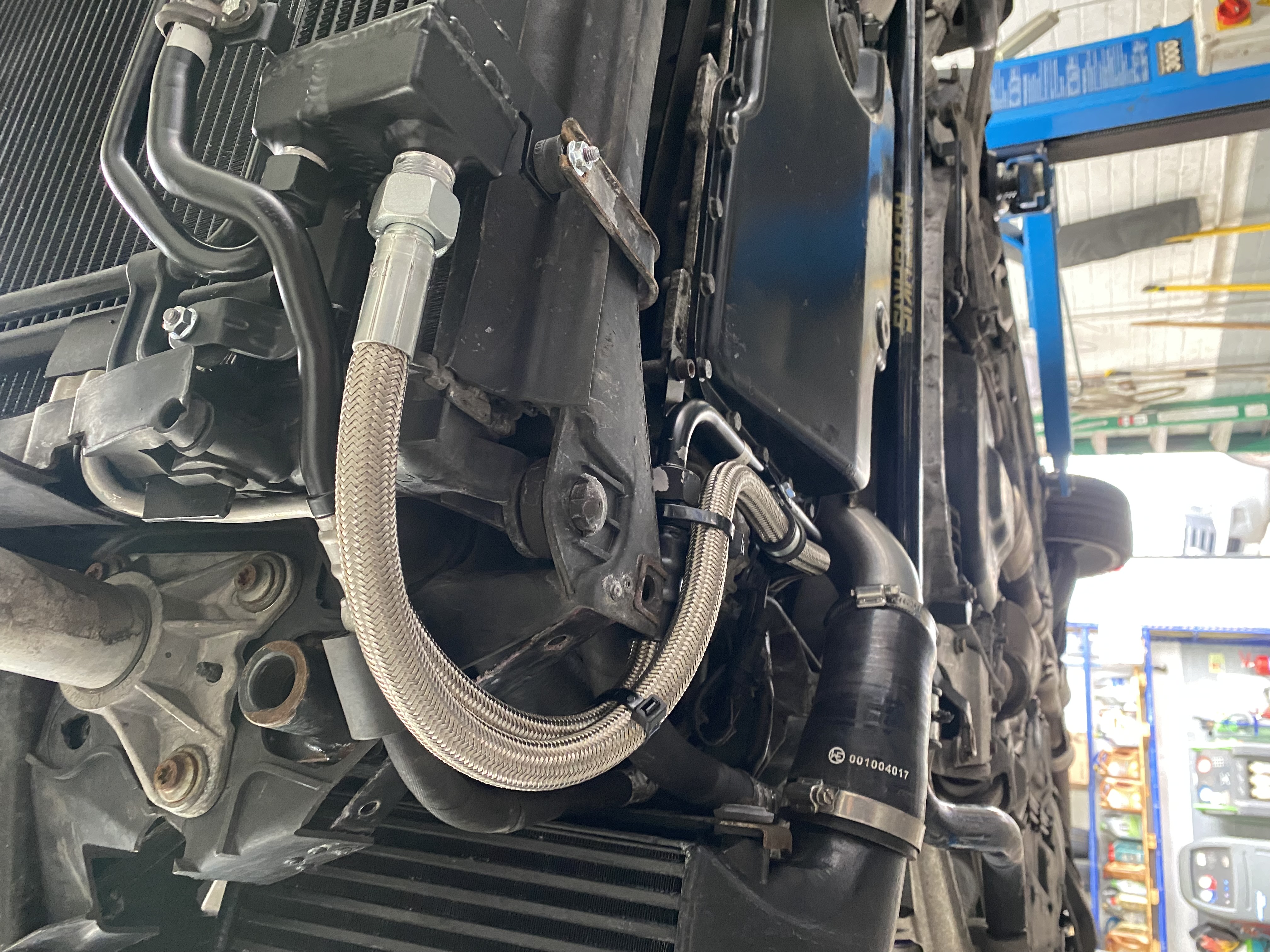

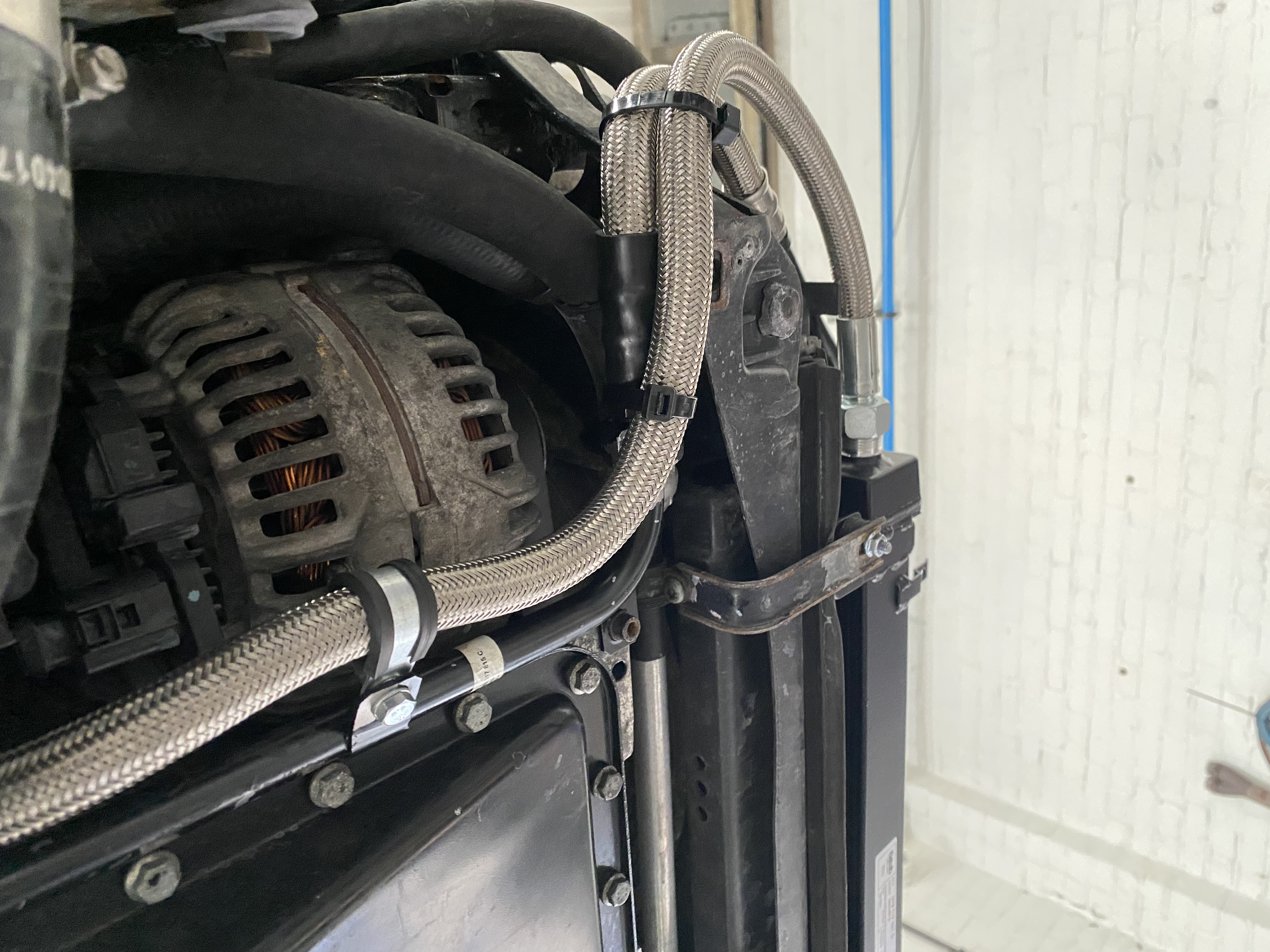

Fingers crossed the oil cooler end comes undone without destroying the thread on the cooler, if it does there’s a good looking secondhand one for sale on eBay at the moment.
Here’s a couple of pics of when I did mine, I managed to get all the pipes from Audi except one which I sourced from RS Carparts Germany and the fit was really good and it came with the fixings to keep it tidy. I know Ricky at Pirtek Watford he’s a good guy and always happy to help

I was wondering if a fully flexi pipe could be used, your photos suggest the answer is yes.

Re: Please identify these rusty pipes.....
Hi Ric
Yes the one I fitted is fully flexible, if I remember correctly the pipe has an angle on the end where it goes onto the oil filter housing. I still have my old ones just in case and also managed to get all of mine off bar one without them destroying the threads but i reckon I could fix it if I had too. I have to say though it is very common for them to seize onto the oil cooler fingers crossed for you. Take a look at the Rs Carparts De website and it will give you a clearer picture

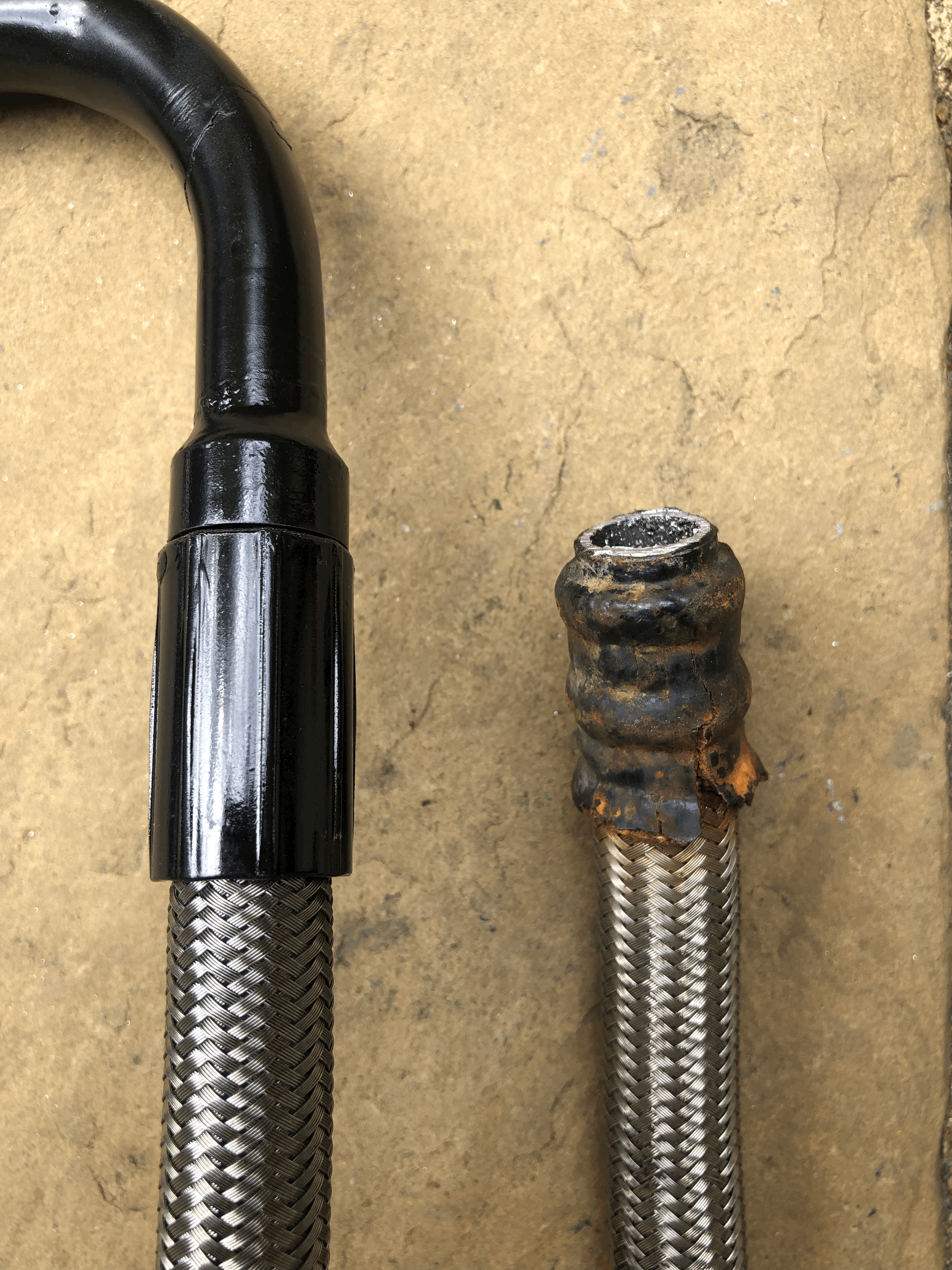

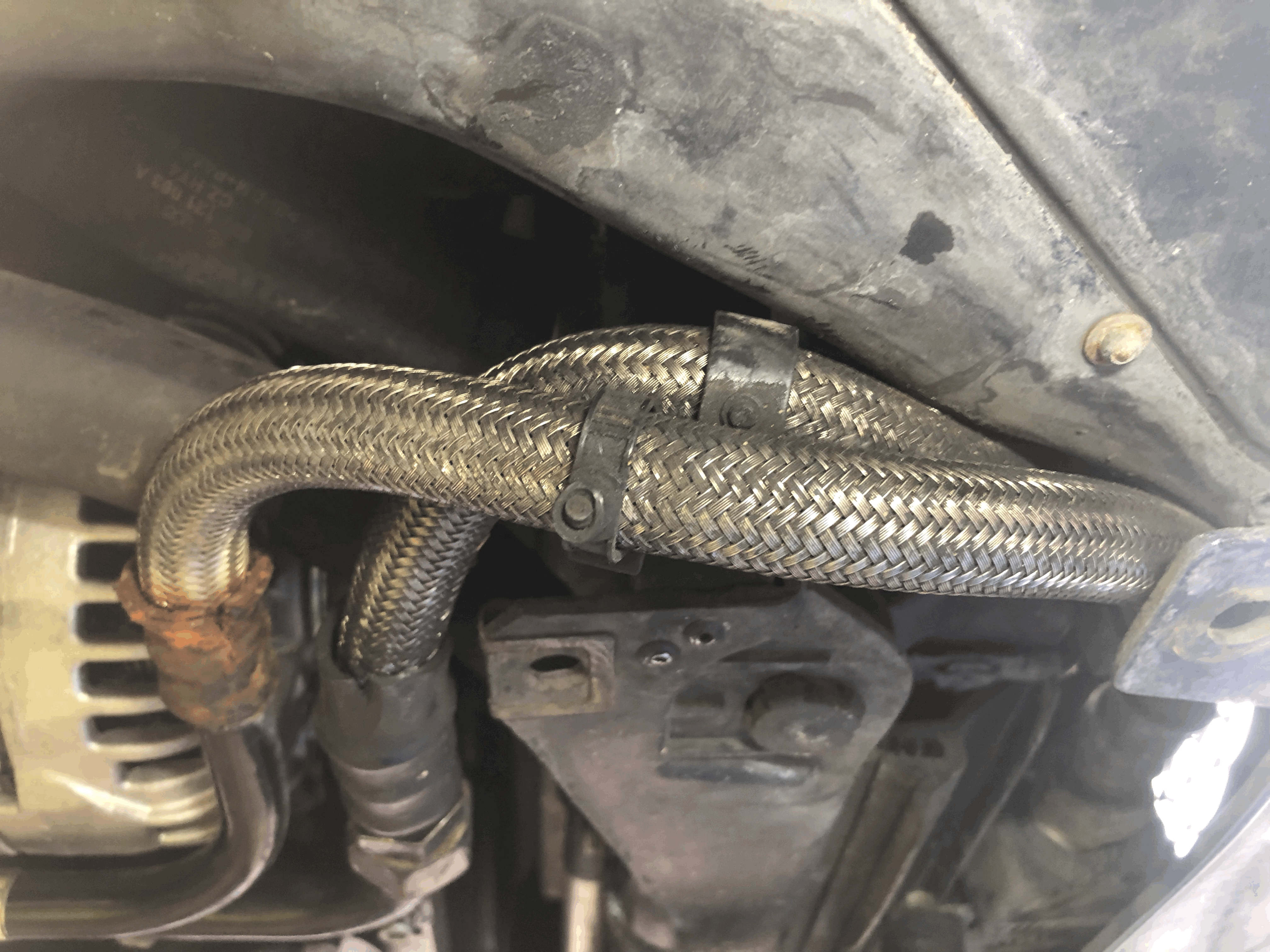

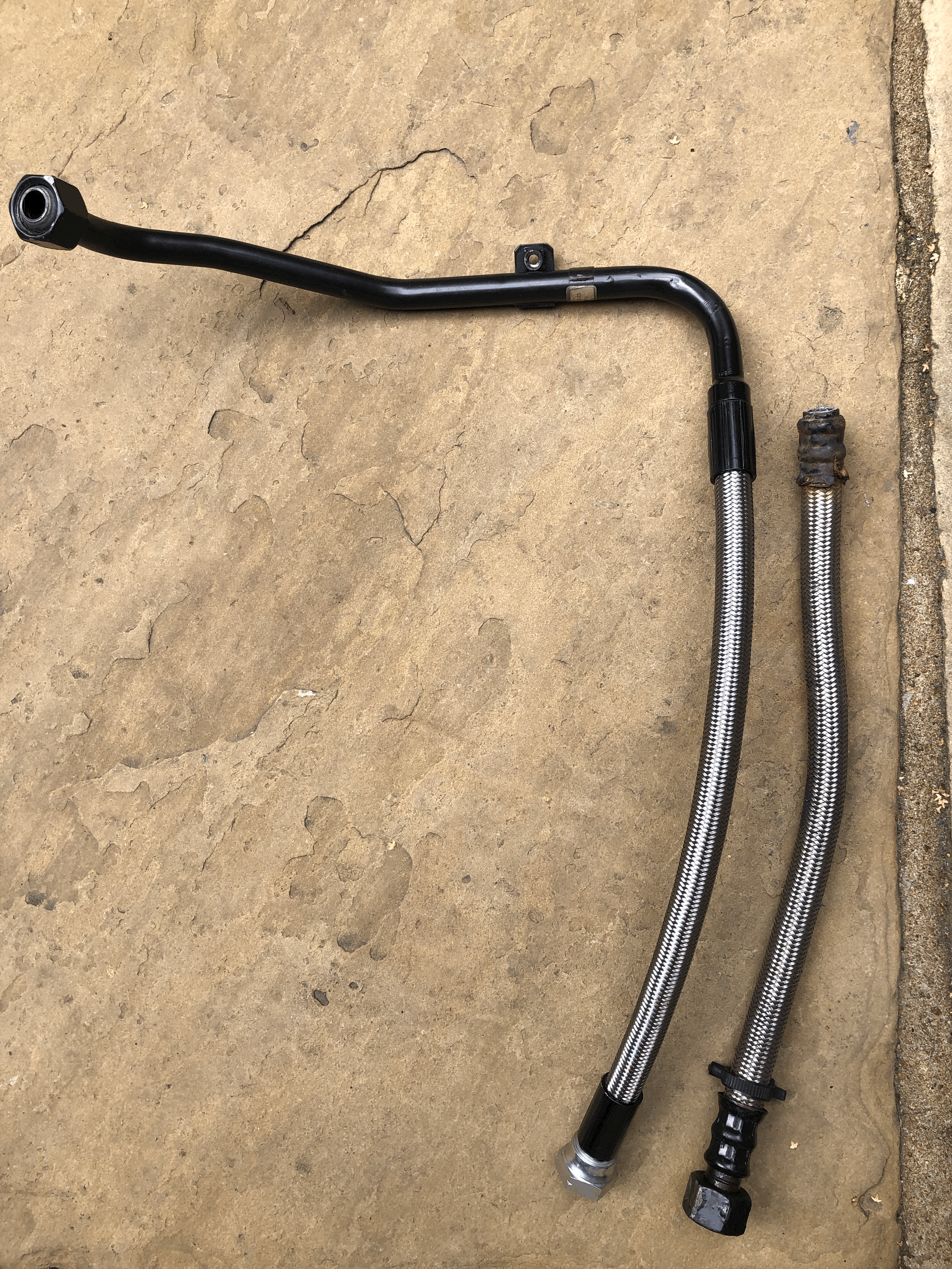

It's looking positive. My newphew (mechanic) got the old pipe off without damaging anything!
Also sent anti roll bar off for powder coating.
Pirtek (Watford) have done a great repair job, attaching new flexi hose to solid pipe ( £106)
For info they say they could copy the solid pipe for approx extra £20 or do whole thing in flexi for approx £140.
Which is similar to RS carparts oem replacement (but without the bracket), so it looks like we have a few options.
Hoping it all goes back together, I'd rather like to use the old girl whislt we still have some summer left!
Was pleased to see that this was the only pipe showing any sign of corrosion. The guys in Pirtek suggested that it might have been caused by water running downfrom the oil filter and getting trapped in the joint, suggested a bit of silicone around the joint??
Thanks one again for all of you who have helped.

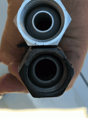

Maybe not the result I was hoping for.
On closer inspection it appears the diameter of the bore on the new flexi is 10mm compared with 13mm on the original, which my my maths means about 40% less area. Unless the oil flows faster I pressume this would be less flow and maybe changed oil pressure, so not sure if it's sensible to use .
Would welcome any thoughs. Thanks.
Back to Pirtek tomorrow and if they can't come up with a better solution, looks like I'll have to order from RS car parts. At least they are back in stock.
