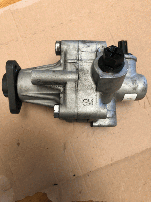

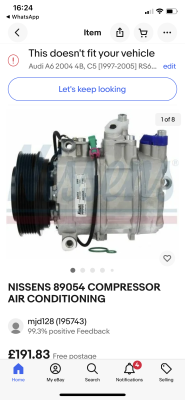

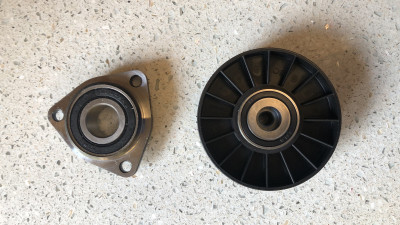

"Can you kindly tell me exactly where the Power Steering pump is located at the front of the engine" ?
Hope these photos help.
I'm not a mechanic but my nephew is and he's done this for me.
Recently replaced (again PAS pump) with TRW one (from Auto doc)
Flushed through the fluid several times until clear ( 5 litres)
Also bearing and pulley ( which were not availiable according to a couple of specialiasts I use !) Note the bearing was fairly cheap but first one from auto doc poor quality, got a second one elsewhere, but not sure it was any better than the oem with 90K miles!
Found bearings on A/C compressor ( just below PAS pump) noisy, and was noisy in cabin too so replaced that ( ignore the doesn't fit your car on screen shot - it does & looks identical).
Also replace the drier. This was a struggle to find, but got one from German ebay. Recharge by mobile a/c engineer - works brilliantly.
Hope this helps - I'll do aseperate post with more info once the car has been road tested,
Power steering pump
bearings / pulley
a/c drier
a/c compressor
pas pump

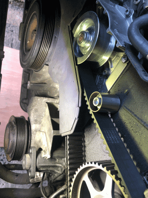

Astrosquirrel
Posts: 274
Joined: Thu Nov 07, 2013 7:03 pm
Re: New RS6 C5 owner car issues please help.
Post by Astrosquirrel » Sat Nov 05, 2022 10:58 pm
I know I'm late to the party but maybe it can help.
Red is the PS pump and green is the ac compressor.
Also, that's how the serpentine belt is routed Image
