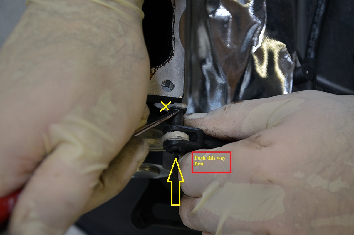

034 Motorsport have a great easy to follow guide on how to fit those arms which also details how to get the shafts out. The arms are supplied with a tool that makes getting the metal plugs in\out easy too. Here is a link, but in case the link dies I've posted the PDF for download. https://www.034motorsport.com/blog/diy- ... -108-z005/
I followed that guide and it went smoothly, but here is some advice:
In step 8 linked below, when removing the plastic dowels\pins that the linkage arms are connected to. The image shows the guy prising it out with a screwdriver. Don’t do this. “Push” them through from the other smaller side, rather than attempt to “pull” them out from the other flat\larger side. The plastic is brittle, and you will break them. Once unclicked and pushed free, then you can pull them out from behind.
https://blog.034motorsport.com/wp-conte ... step_8.jpg Here is an image of the shafts and the plastic arms. The circular silver thing is a cap that goes on one end of one of the shafts in the manifold.

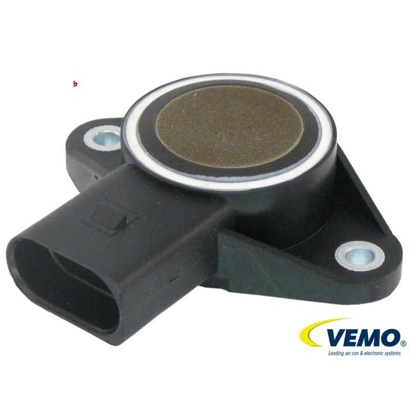

I also replaced both Manifold Flap Position sensors just for completeness. Vemo part number V10-72-1279 are the same part as OEM but with the Audi detail rubbed off. As well I replaced the one-way Vacuum valve that sits under the manifold itself. You can see it here the black and white valve.
Pierburg Valve Part Number 7.05817.00.0 is the same part as the OEM one. Then onto cleaning the actual manifold itself.
