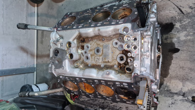

Just a bit of fun. During a conversation with a dealer contact they mentioned that they had a 2021 RS6 in the Shop where the owner had somehow hydrolocked the engine, big puddle was all the detail I could get.
Anyhoo I asked what's happening with the ex-engine and he said scrap. So for a box of Heineken I've got a complete but apparently bent RS6 long block.
I'm looking forward to taking an engine apart without worrying about putting it back together.
The plan is to see if I can do the old engine block coffee table setup. Will post pics of the carnage when I reach it.

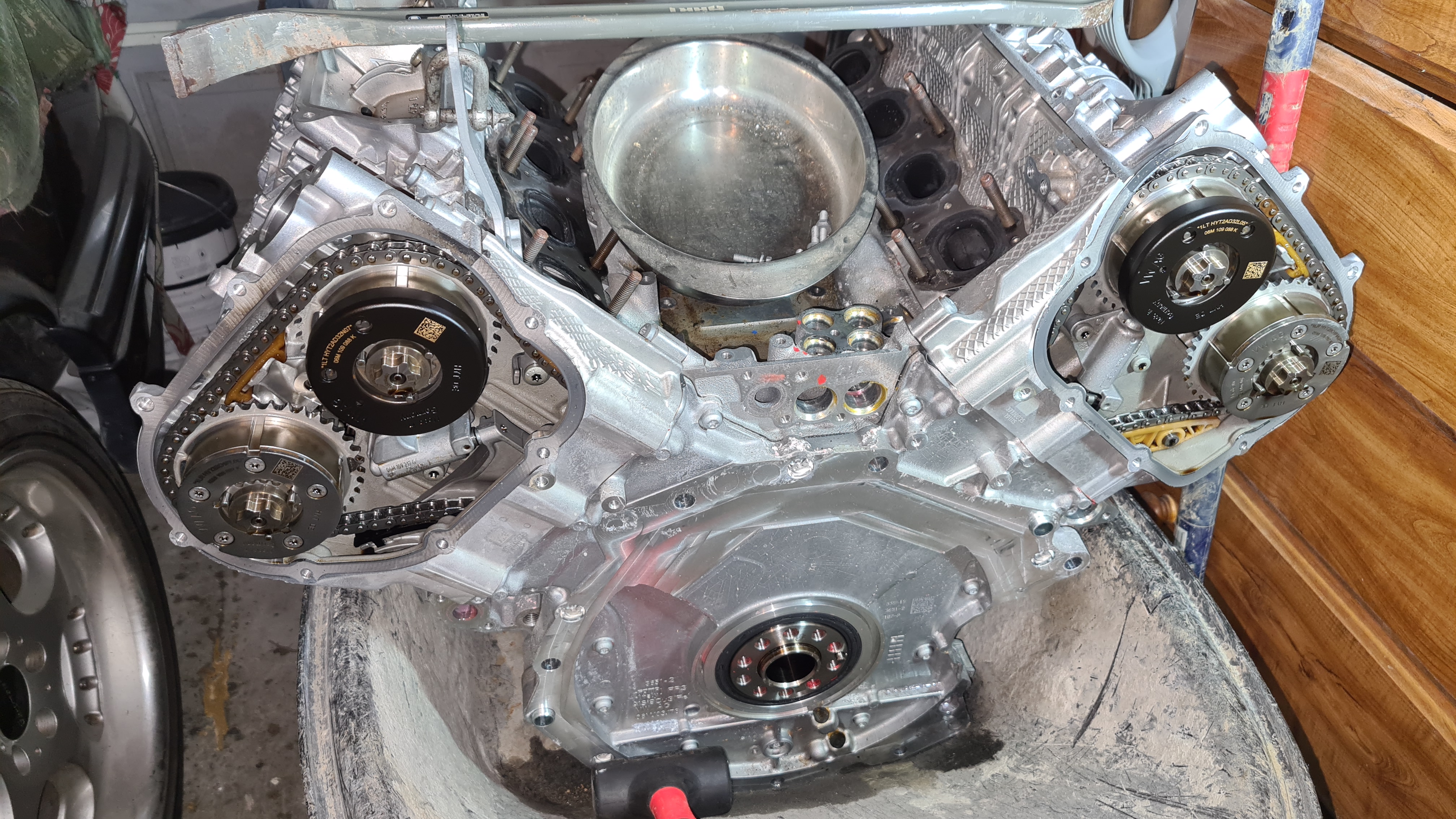

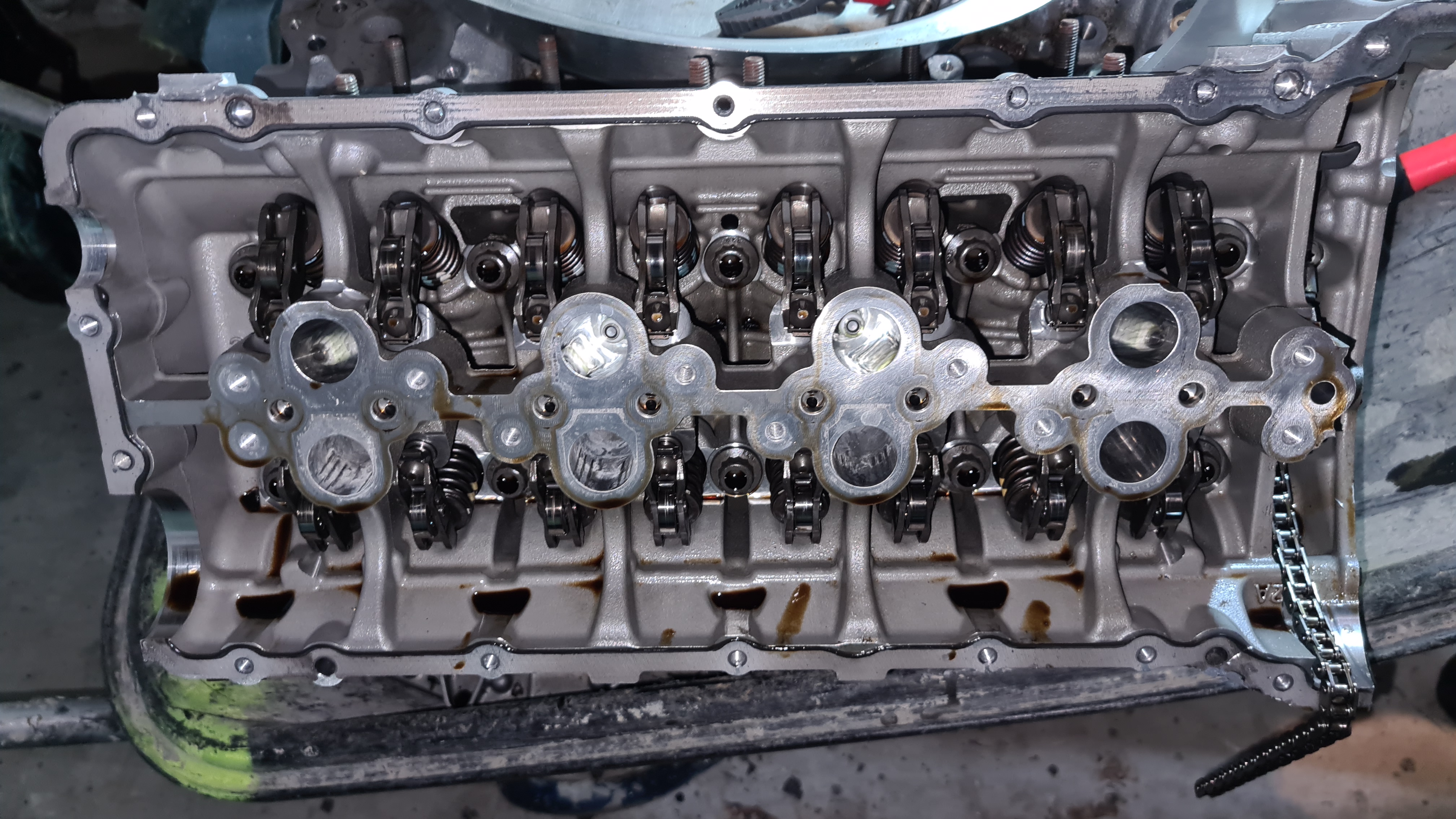

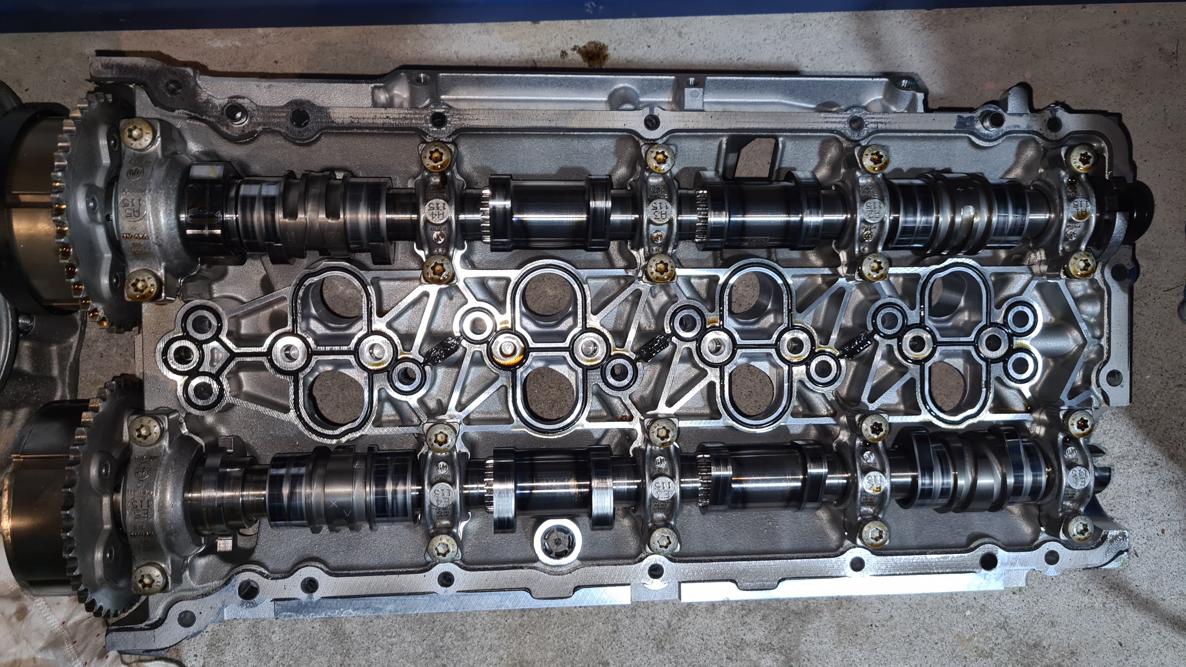

Cracked into the engine. Interesting valve train, no valve covers per se, the valve cover doubles as the camshaft carrier with the cam lobes acting directly down onto a pretty beefy neddle bearing within the rocker arm. "Sir your valve cover has a leak, that'll be $1500 per side to remedy..." F that.
Engine must have been locked up as it wasn't on TDC and with no timing chain master link accessible out comes Mr Grinder. That's just to get the valve cover/cam setup off.

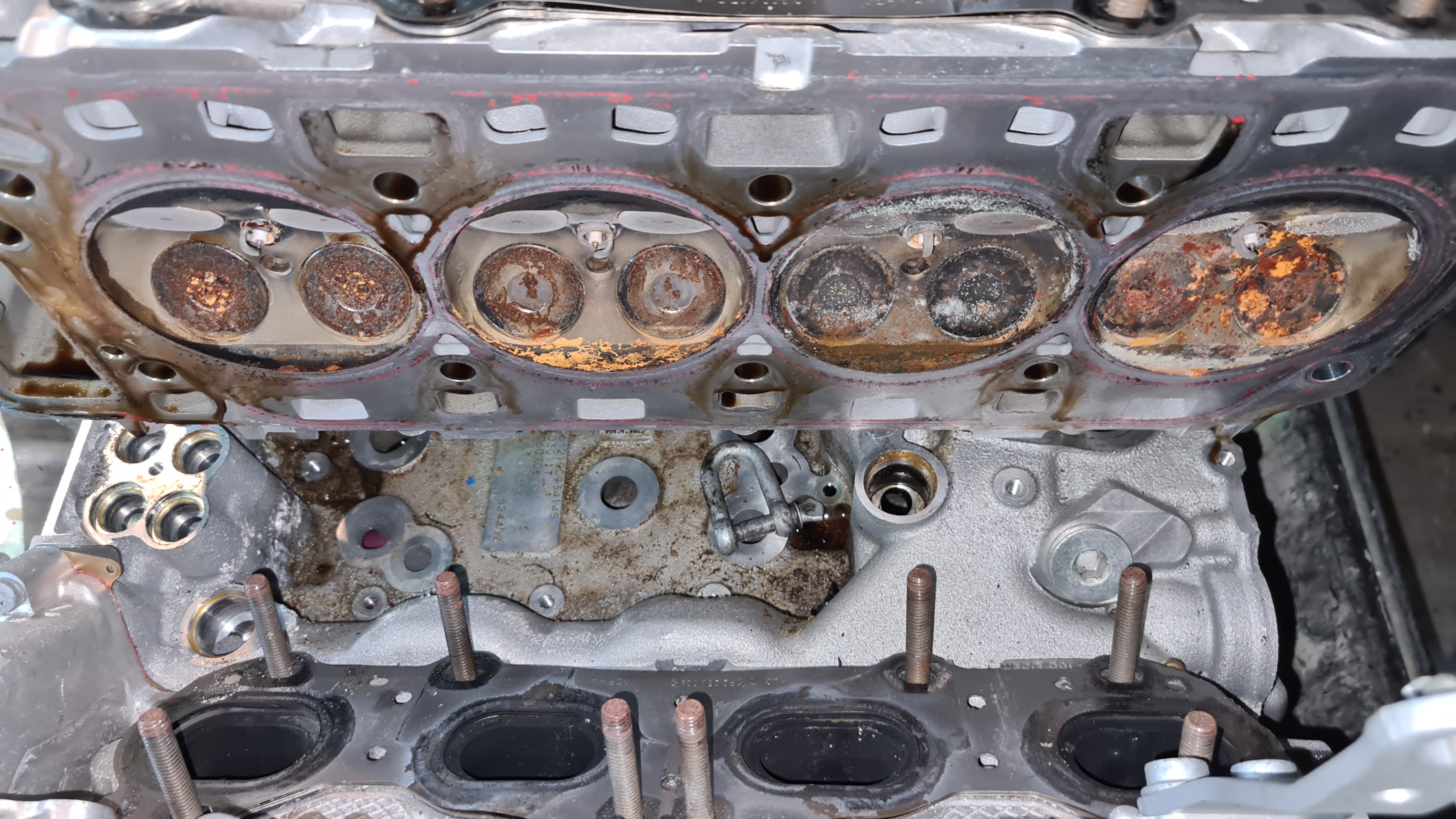

Heads were easy.

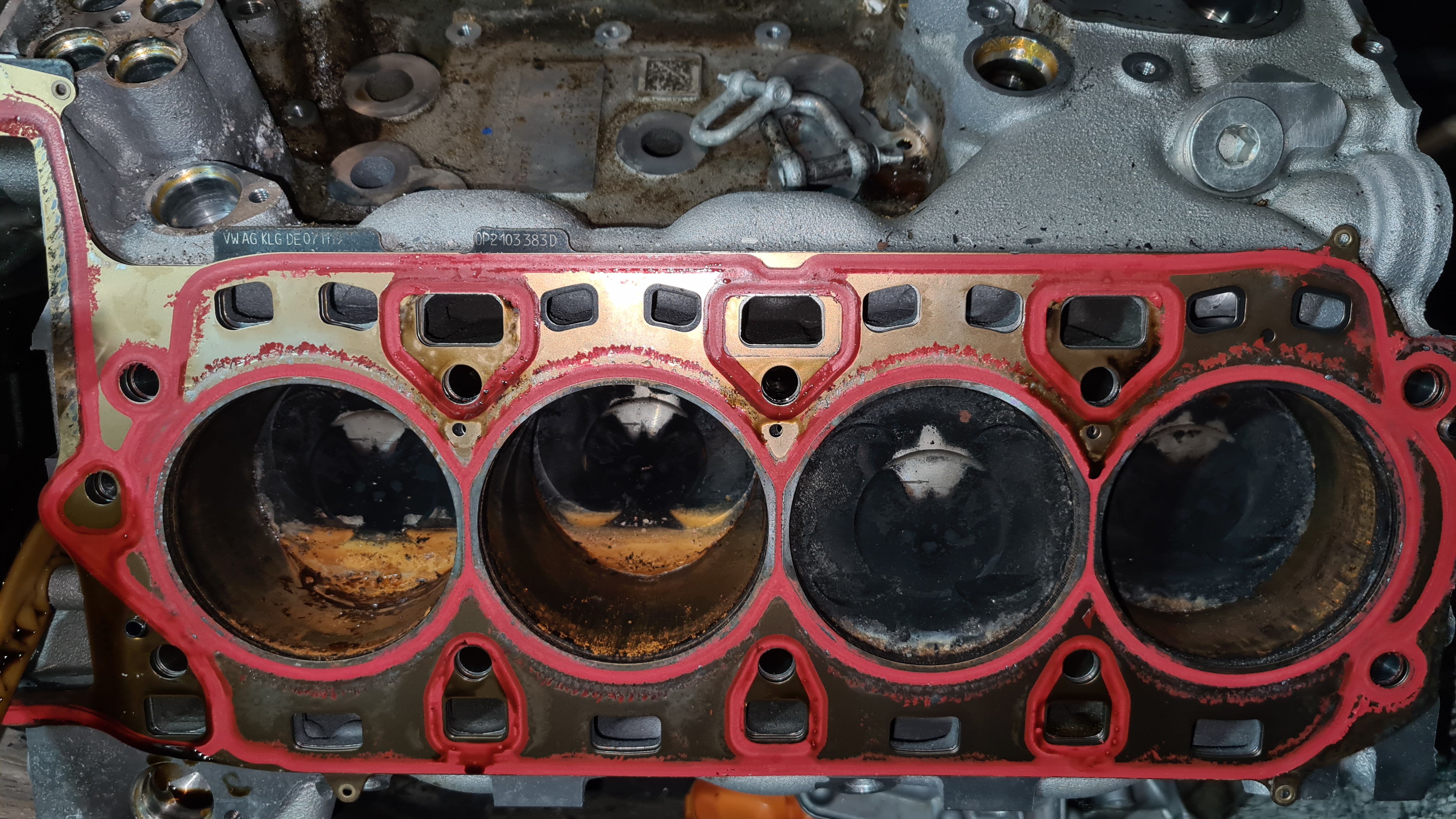

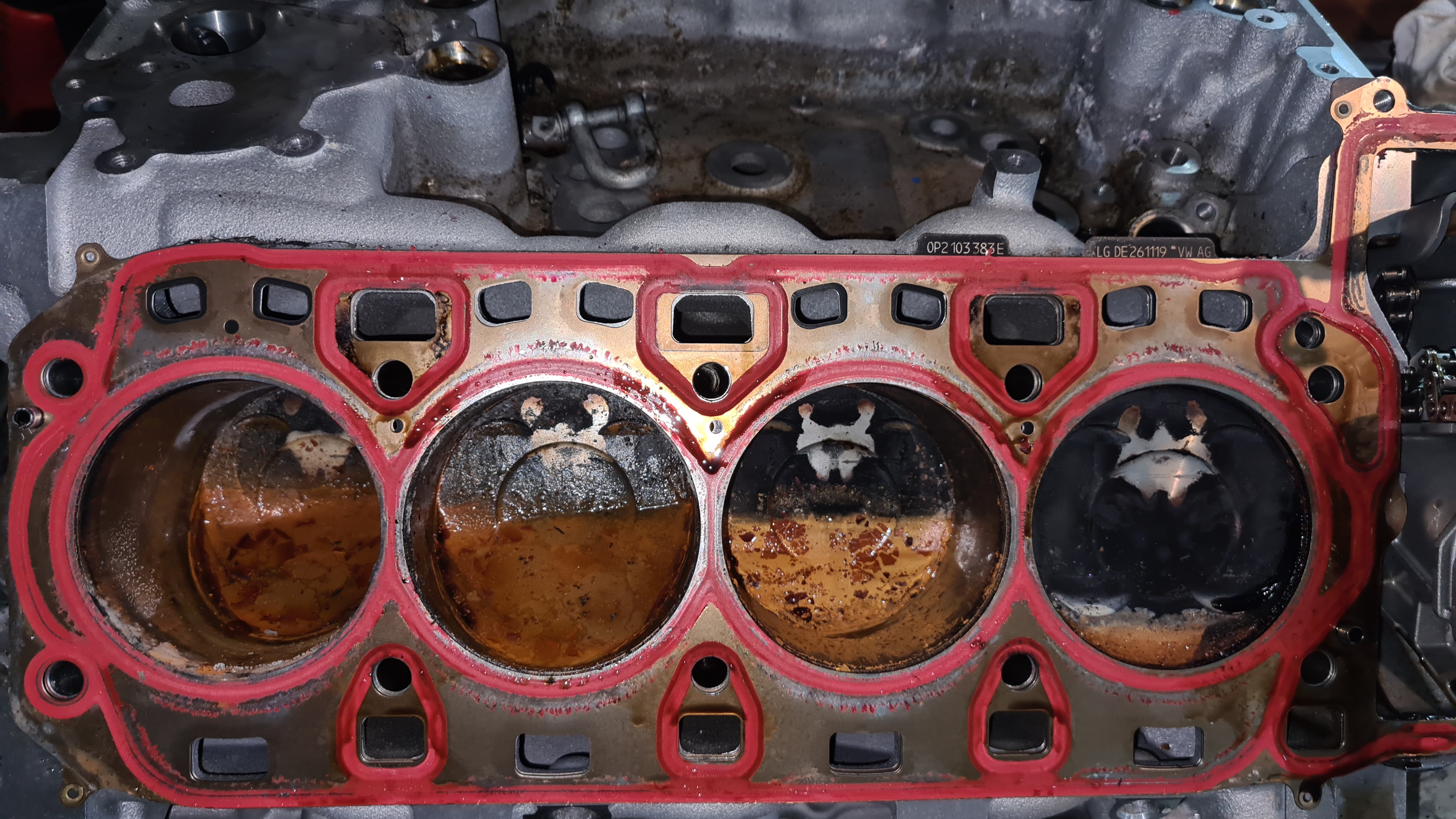

Then I found the culprit. Water indeed found its way into the engine. The last interesting (sort of) detail is that the engine has iron liners, otherwise it looks like a very stout unit. MLS head gasket, with 13 or 14 mm OD head bolts.

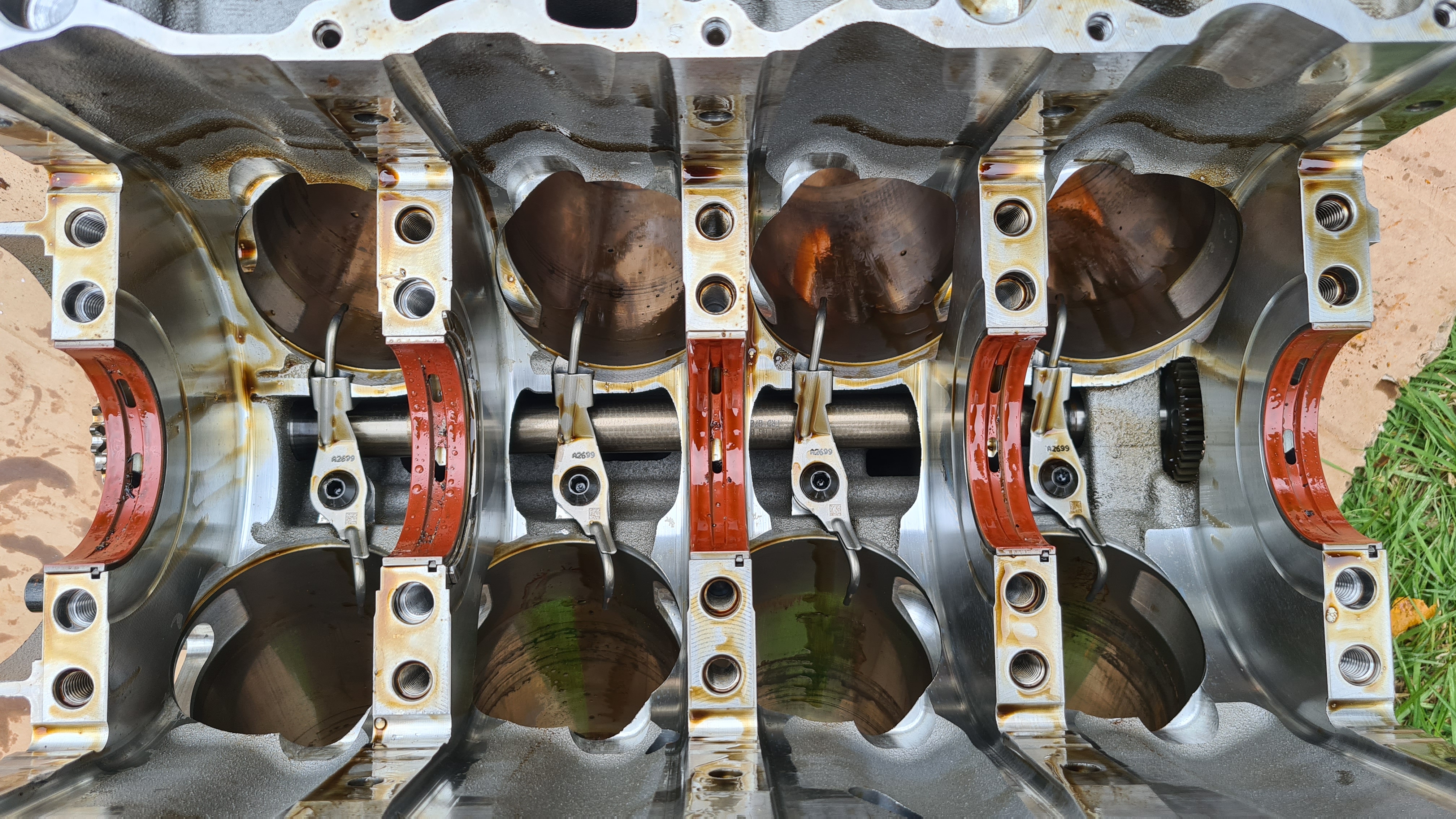

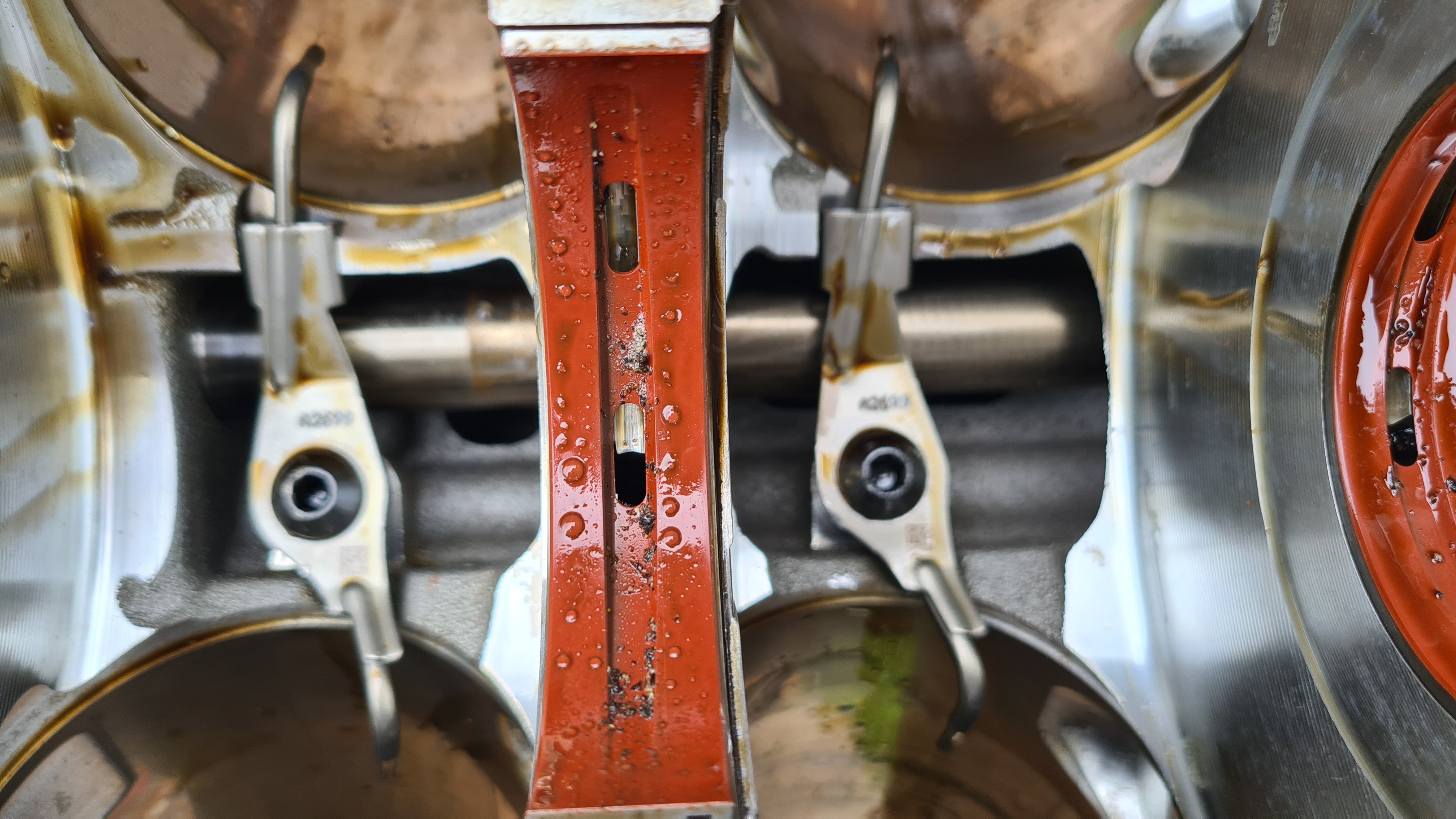

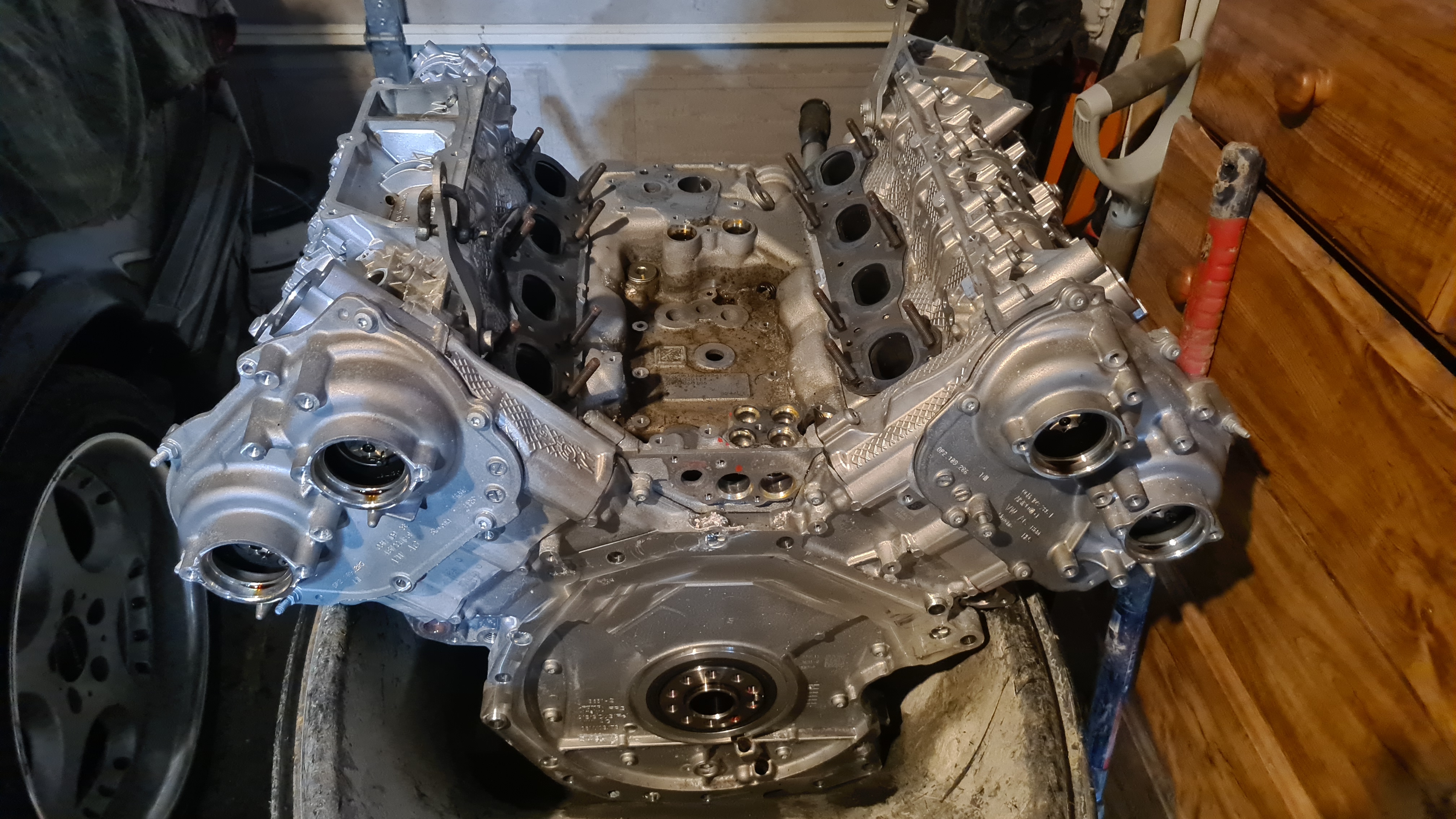

So the engine is fully dismantled I let my boy loose on it with an impact gun. Interesting case. Firstly, any fasteners not significant, like a headbolt, we're all the same which would be awesome if I was putting it back together.
The dealer was vague on the actual cause of the engine replacment but the main points discussed centre around water going where it shouldn't.

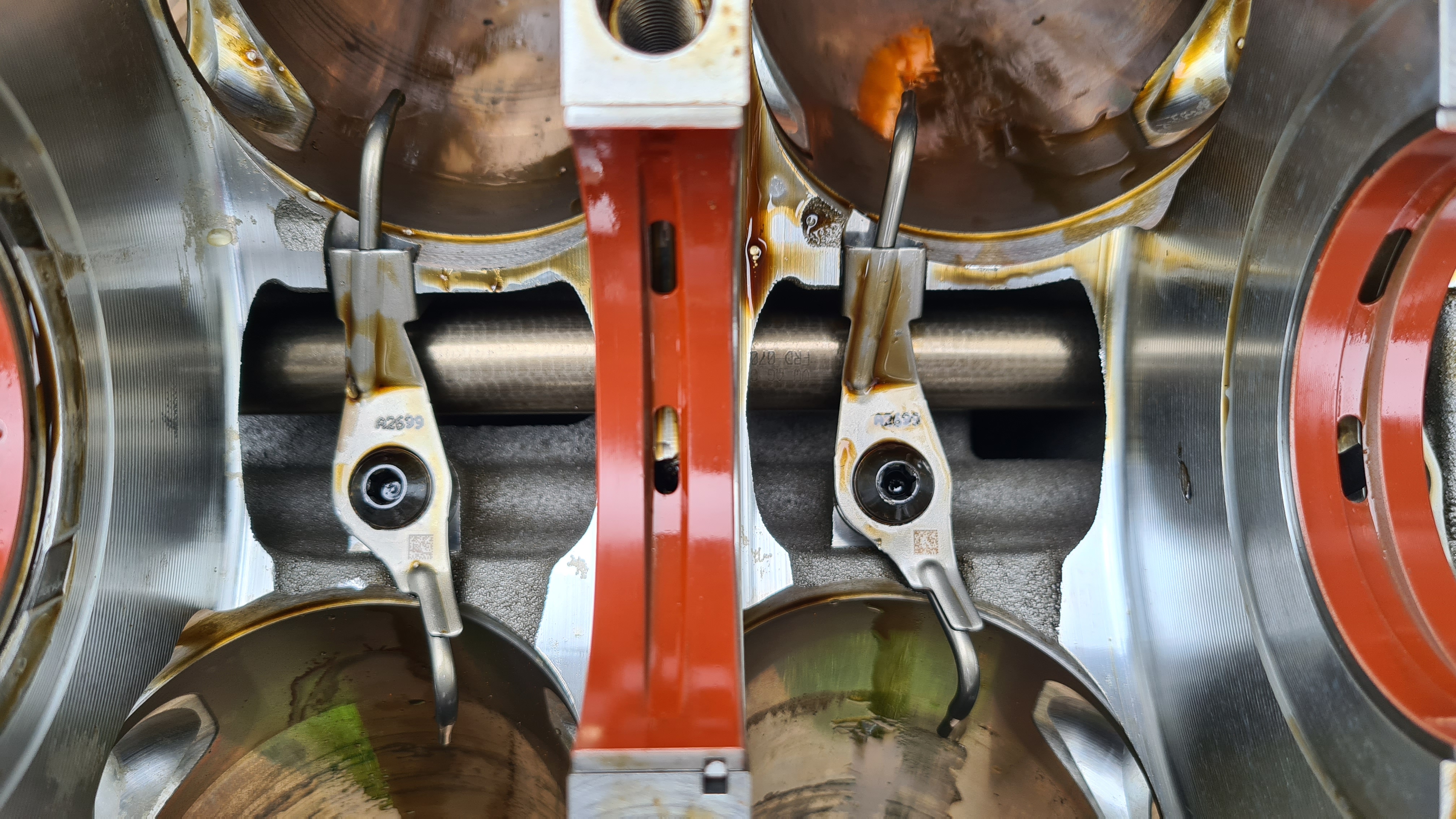

There is no obvious signs of hydraulic lock, conrods "look" straight, but as they're cast with a wavy casting line it's hard for the eye to pick up any major deviation.
Ostensibly everyting looks perfect, oil is a bit darker than I'd expect for a car of this value, but who knows.
What I have found that's not good is the water in the cylinders, sump and detritus in the oil galleries. Most significant of which is flotsam in the crank oil galleries.
It has had a significant flooding, I reckon it went in and then stalled getting stuck in the water for a time, enough time for water to make its way throughout the engine.
Big end bearings show barely any wear, just look at how fresh the main cap bearings are!
The next update will be a closer look at the conrods and close ups.of the gunk in the crank galleries.
