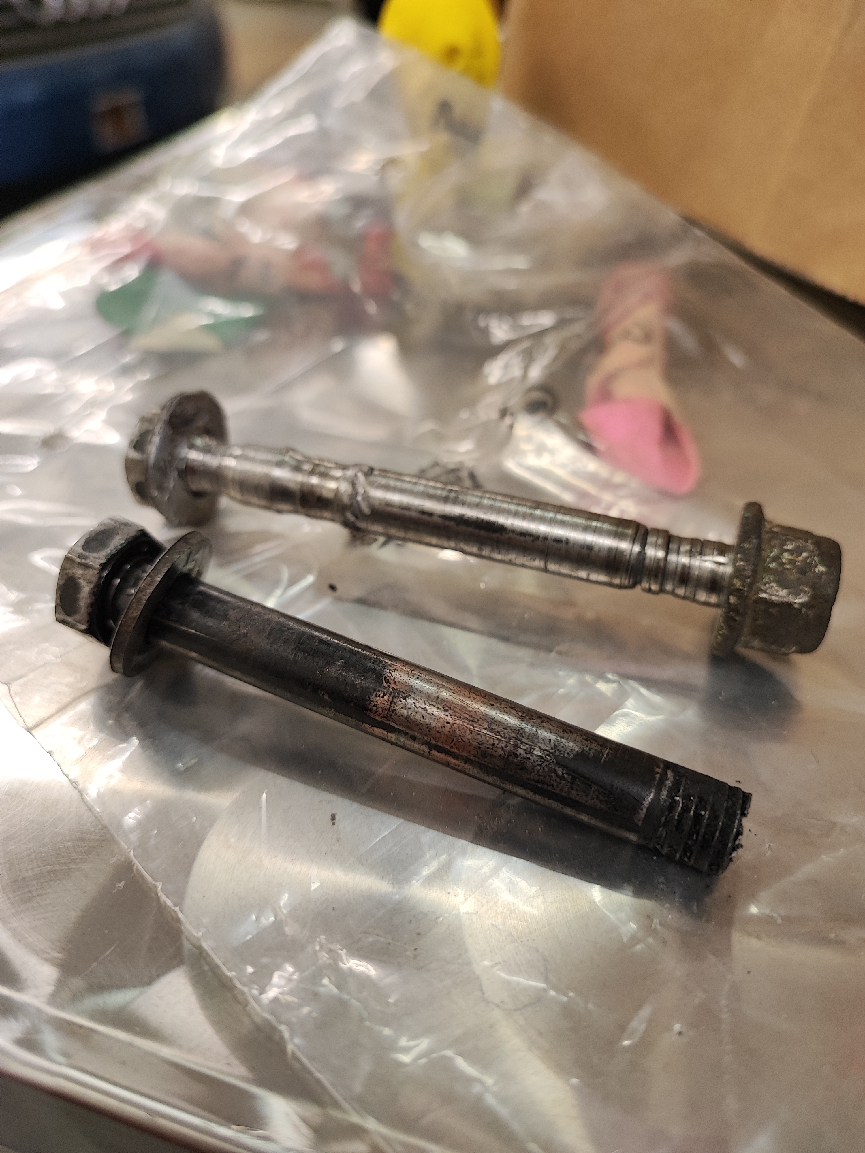

Been having fun these past three days with pinch bolts, stuck control arms and more. Reason?, well:
The other shaft is actually ok but I will replace both in any case.
Here are the pinch bolts... what's left of them.
I will also replace the upper control arms. Found TRW ones at Autodoc. Any recommendations if I should go with something else?
Thank you!
