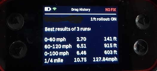

Deffo great grip on the continental sportcontact 7 and gave consistent times on my Racebox
