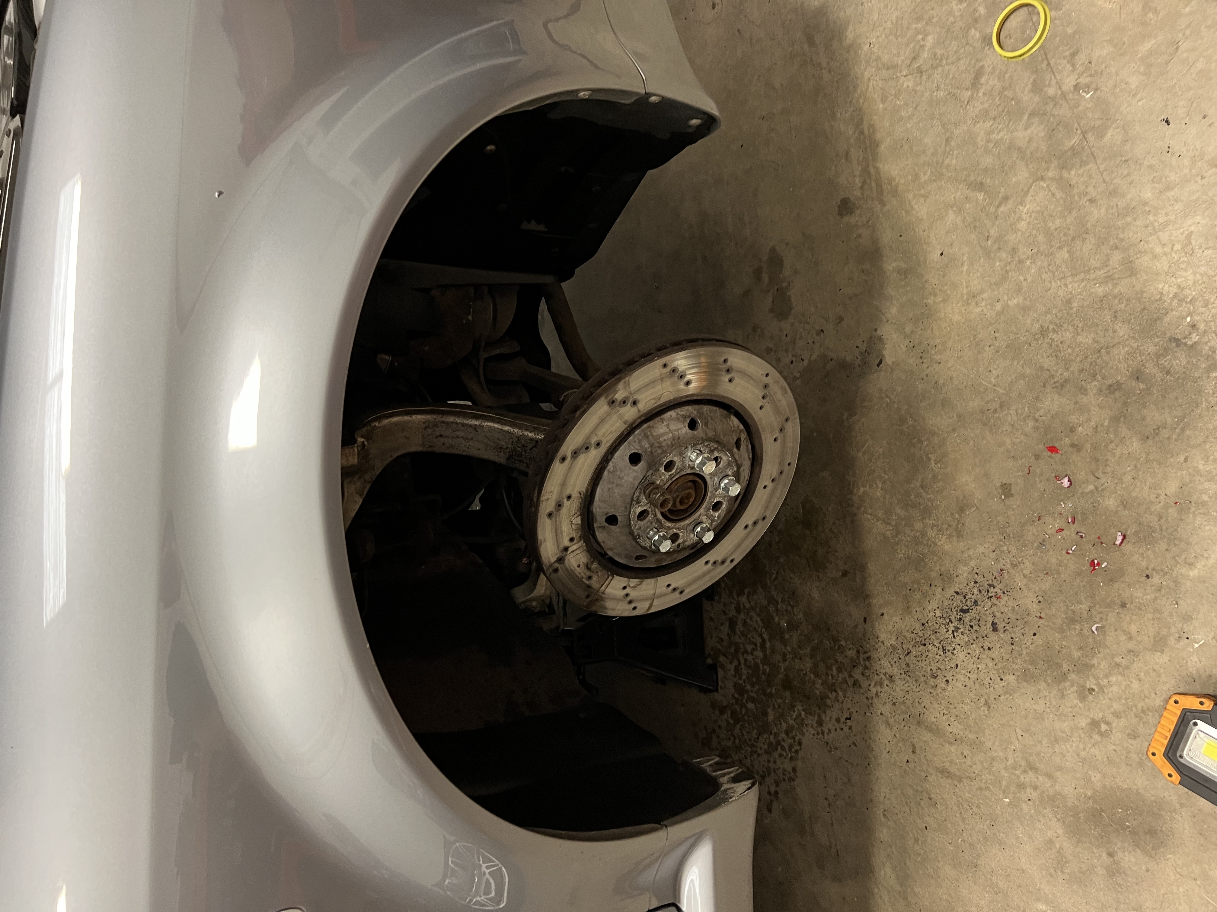

So I had some issues with the caliper bleed nipples around a year back when it was discovered they were seized, I had a garage look at them and apply heat, but they said no joy also, not long after it was due an MOT and passed fine on brakes so it was left for a while
Until last week, short drive to the gym, all fine, leave the gym, now pedal feels like it’s dropping… took the car up to work to inspect and found one of said nipples was leaking, took a spanner to it and was free, weird, but I had replacement ones in the car from back then so tried a new nipple as old were rounded etc, but unfortunately a thread stripped out when doing some bleeding, bastard, almost a free repair on an RS6, unheard of
Anyway, decided they were coming off and getting sent away for a full strip and rebuild with powder coat etc aswell as the nipples need done
Looking a bit sorry for itself here
I am also doing the droplinks whilst im in here, had these for a while so finally getting my finger out

It looks to have Pagid pads in currently, am i right in assuming these are the standard pads or should they have Audi logo on them?
I found these to be quite bad in dust terms, but i have also found at least 2 pistons arent fully retracted, so possible seizing also
