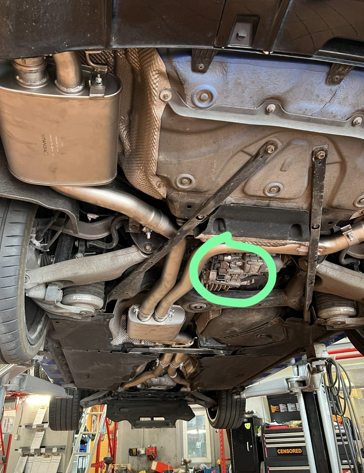

Yesterday I had a new exhaust installed

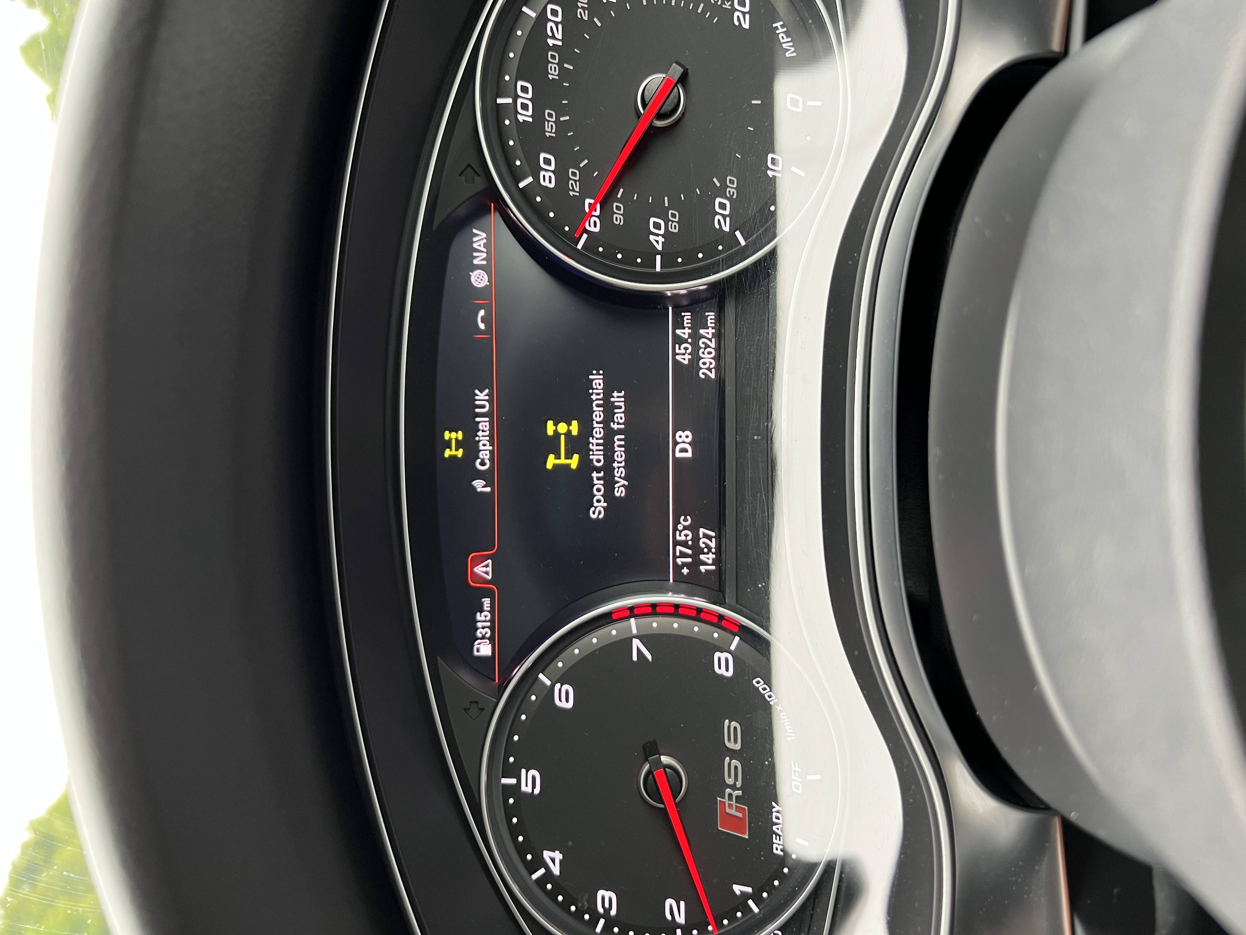

Within a mile of leaving I got a sport differential error pop up on the dash. It goes off when the car is restarted but soon comes back and strangely seems to come on when turning left, for example coming out of a roundabout.
A quick scan seems an oil sender problem. Anyone had this problem as I can only think the garage has damaged the plugs as they are very close to the exhaust?
The old exhaust has signs of a struggle getting it off, dents etc.

Yes they do tend to intermittently fail. Can try cleaning the connector otherwise its a straightforward fix - replace sensor and readapt in settings.
