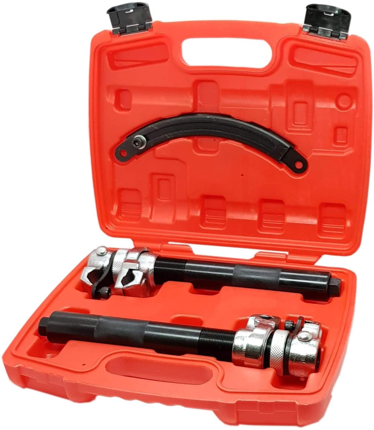

Post by cammmy » Wed May 18, 2022 10:48 am
Nice one, thanks all. I have the normal compressor type as well as these:
Hopefully getting them in will be easier as the new ones are adjustable, so I'll set them to full slam and wind them up after.

Post by Phuketpaul » Fri May 20, 2022 8:59 am
I had one of these sets, threads got stripped second time I used it, not impressed

cammmy
Posts: 247
Joined: Tue Dec 10, 2019 3:32 pm
Re: Replacing Springs with DIY Tools
Post by cammmy » Fri May 20, 2022 6:09 pm
Ah, I have a set of normal style as well should these prove to be crap. They worked fine on the Esprit but I imagine the springs on that are a lot lower rate than the RS.

cammmy
Posts: 247
Post by cammmy » Mon Jun 06, 2022 11:16 am
Okay, so the answer to this is no. You won't be able to get regular style spring compressors in there well enough to fully compress the springs.
