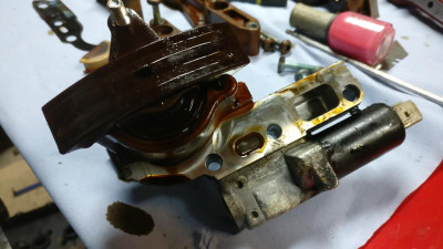

In reality this issue has been around, and ignored, for literally decades on various Audi engines.
e.g. my 2002 build D2 S8 (4.2 non-turbo obviously) has very similar oil strainers built in that are too fine and get clogged. When that happens oil pressure bursts through the strainer and particles of the metal mesh get mixed into the oil. The first "target" in that engine is the chain tensioners which get destroyed along with the engine soon after ......
My engine happens to be being "fettled" right now and the strainers seem to have survived - they have been removed completely now.
Picture below, it's the small oval just below centre, the big "pad" is part of the tensioner and is also in good condition though now replaced. And this is after it's all refitted on Bank 1 with a new pad (Bank 2 is usually less at risk, but is next):
