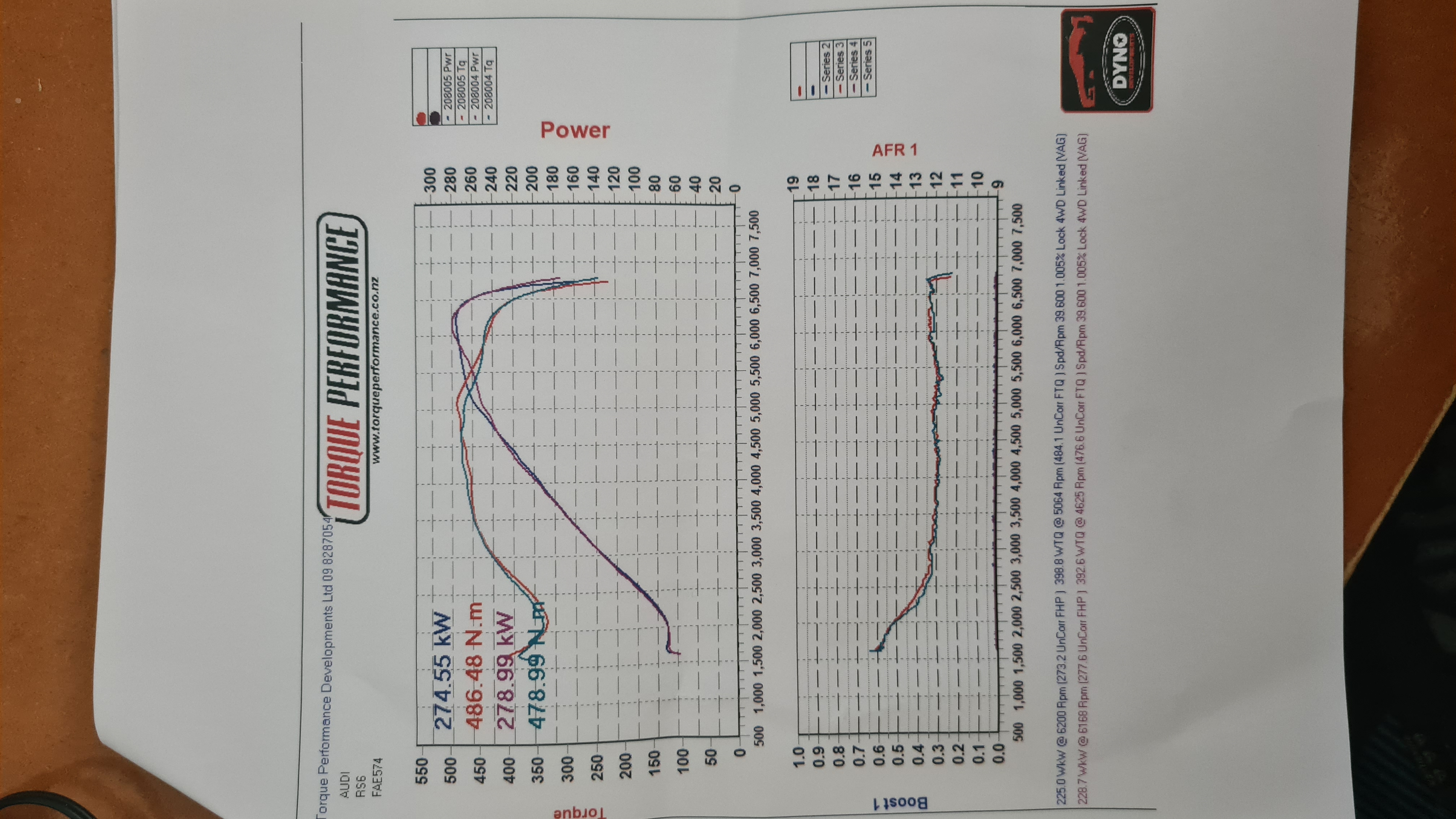

Just had the dyno session. A little perplexed and somewhat disappointed. Disappointed about the figure and that due to the covid restriction level I wasn't able to be there to log key sensors like boost pressure. The Shop wasn't able to connect to the car properly to get to the measuring blocks. They tried 3 scanners one of which was a Rosstech. They could get into identify and scan but not to the measuring blocks...
Even at 25% PT loss I'm missing ~20kw, 20% should have the car putting out ~264kw. Anyone know stock wheel Kw numbers on these cars?
It was a warm day 28c and humid. But the runs were done with a non-heat soaked engine. Power runs were just as the oil temps got to ~75-80 degrees.
If this wkw figure is real, bummer need to get a tune done. If not, this thread will begin my quest to hunt down and destroy (replace then destroy) whatever is causing the loss.

First thing I would do is go for a drive and log your boost against rpm. My torque peaked at 3000 rpm whereas yours looks more like 5000. It's suggestive of the car struggling to make full pressure, but could be anything or just mapping related given the temp. How long had the car been running before the dyno run? Was the ATF up to temperature?

What's that "boost" graph? What's it showing and what are the units?
Re: Who nicked my kilowatts?
Hi Shop, 278kw is the adjusted crank output, it's putting out 228 atw. So the dyno Shop is using an 18% pt loss. Bottom graph is the afr at the tailpipe, should have boost there too but they weren't up to figuring out where to get the boost reference from after they couldn't link into the ecu.

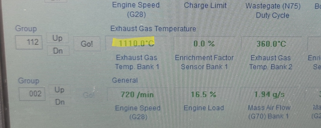

What sensor fault popped up, sensor 1 P1455 G235. Cleared and will double check later.
If the egt was bung, any ideas as to the symptoms it would cause? No MIL/CEL lights on dash.

Faulty EGT could reduce in reduced power / incorrect mapping for the conditions. Lots of sensors are used to optimise fuelling, EGT being one of them.

While in there with the measuring blocks I see a couple of questionable numbers. Mass air flow and phase position.
For mass air flow, what's an acceptable difference and what (if both a wrong) is a 'normal' reading?
Phase position, similar questions to above. Block 94 Camshaft Adjustment, showed me System OK results for both banks. Block 90 was showing/flicking (@ idle) between -0.5°KW and 0°KW adjustments for both banks.
Neither component or area are giving any codes. Only engine codes I have are rhs engine mount and the egt code.

Wow. I think your manifolds would be close to getting slagged.
/Possibly map might be upping fuelling to lower exhaust temps. Not really sure.

Yeah, phase position looks out of spec. Let the fun start...
As for the MAF readings, the one you've highlighted looks good. It's the other one that looks low. Might have a small leak somewhere. Need to log up the rev range.

Damn. Bank 1 is passenger side (RHD) yeah? I've recepts for the cam tensioner being done on the drivers side, and it is new going by its appearance when I was sortng out an oil leak.
Guess I have to retime the engine, I'm assuming a bad tensioner should throw a code?? If I'm not getting a code it could be the chain or tensioner pad? Faaaaark it all.
Hopefully this weekend I can do some runs logging the 12 sensors in that last pic. Perhaps replace the combined maf signal with ignition timing.

Check your groups 90-93 for the cam timing. See what dephasing values you get when you go over 3000rpm.
If you are on the original EGT sensors you might be able to re solder the joints in the Black and Brown boxes and fix it.
