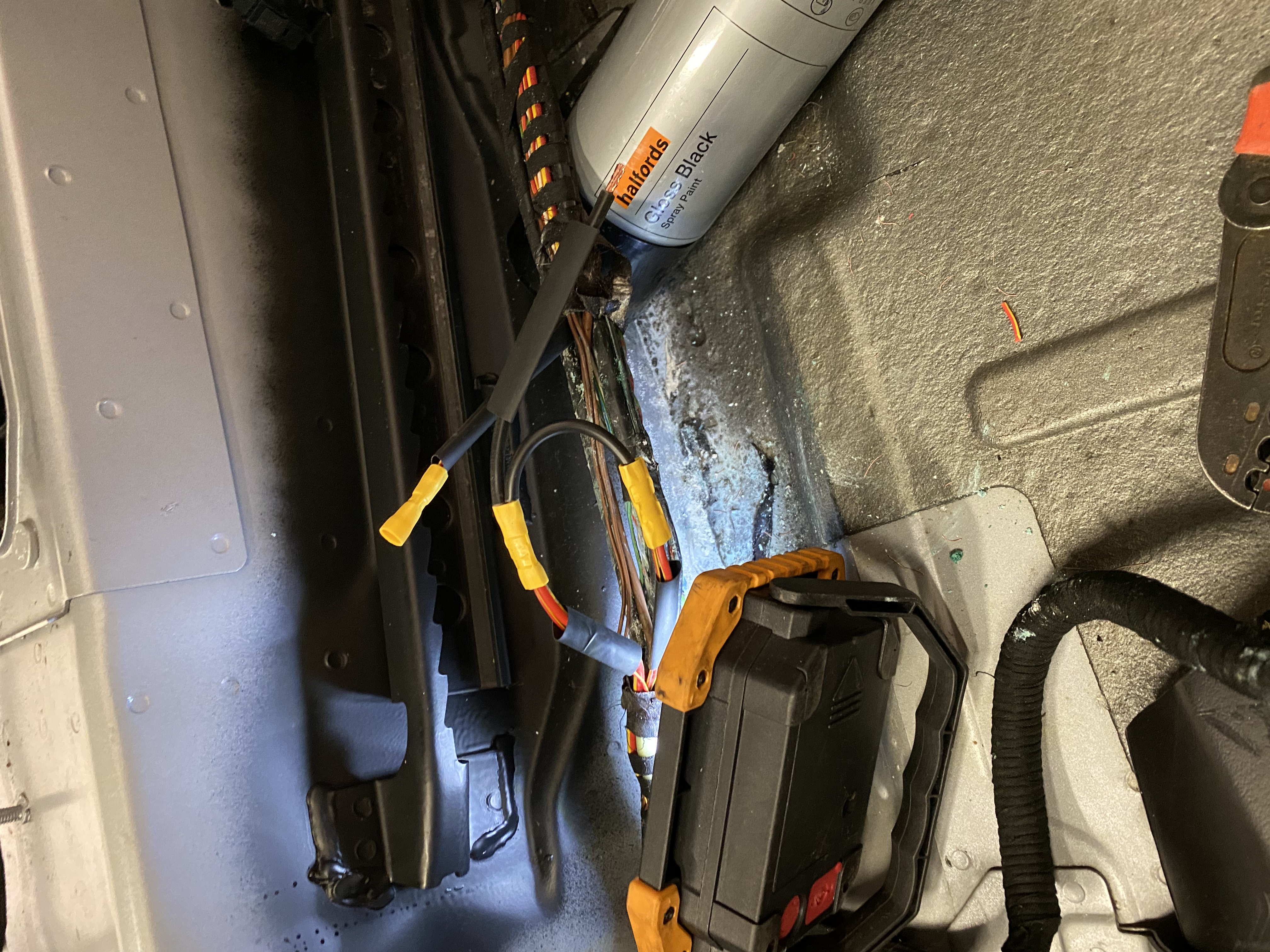

Today I had to re-do the failed Audi connection when the stereo initially went some months back, it’s probably a blessing in disguise as I struggled with the seat in last time so had the room now to make a better job of it
Some heat shrink once crimps were installed
And tied back into the original loom ready for carpet to go back in this week
