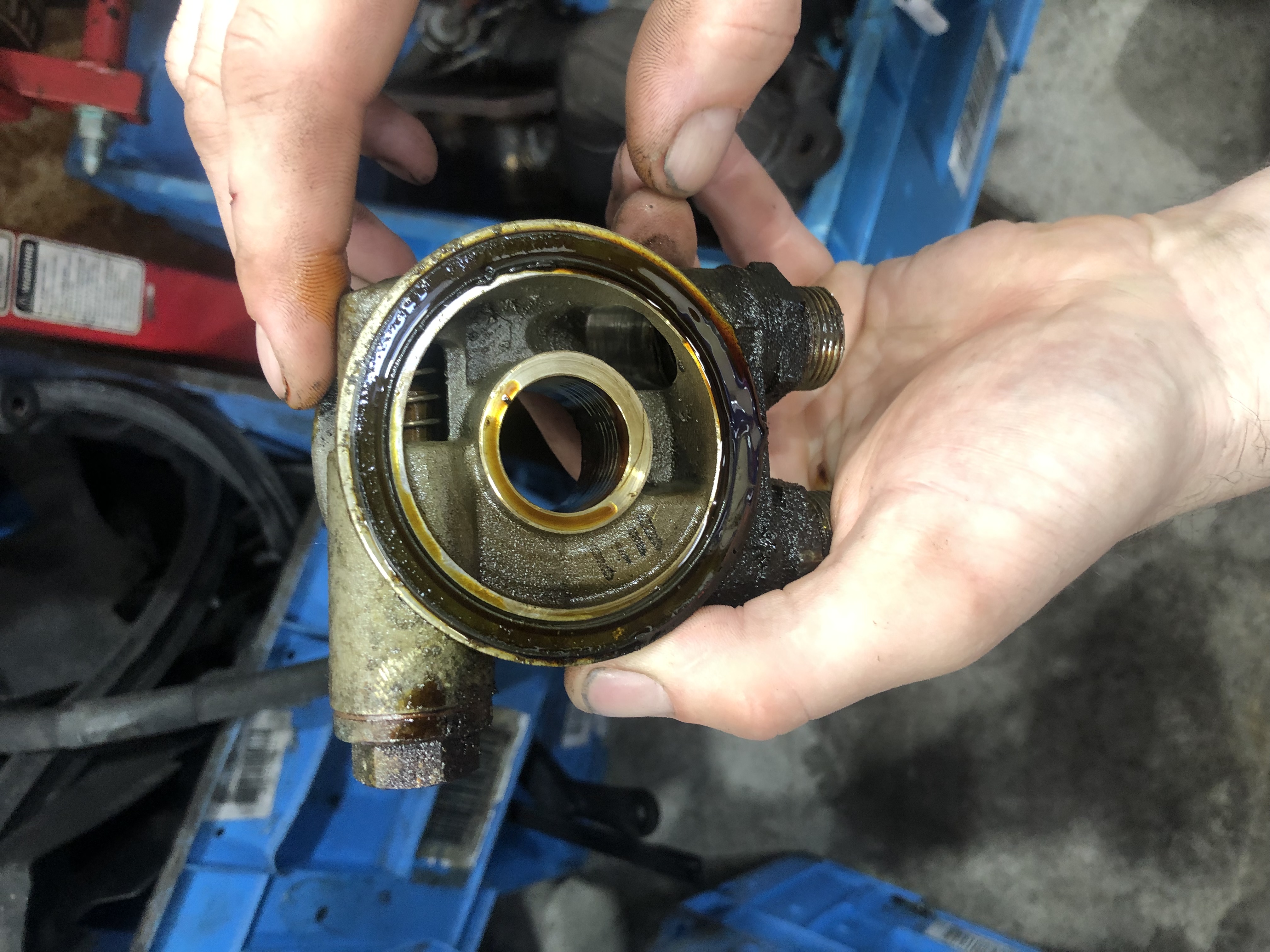

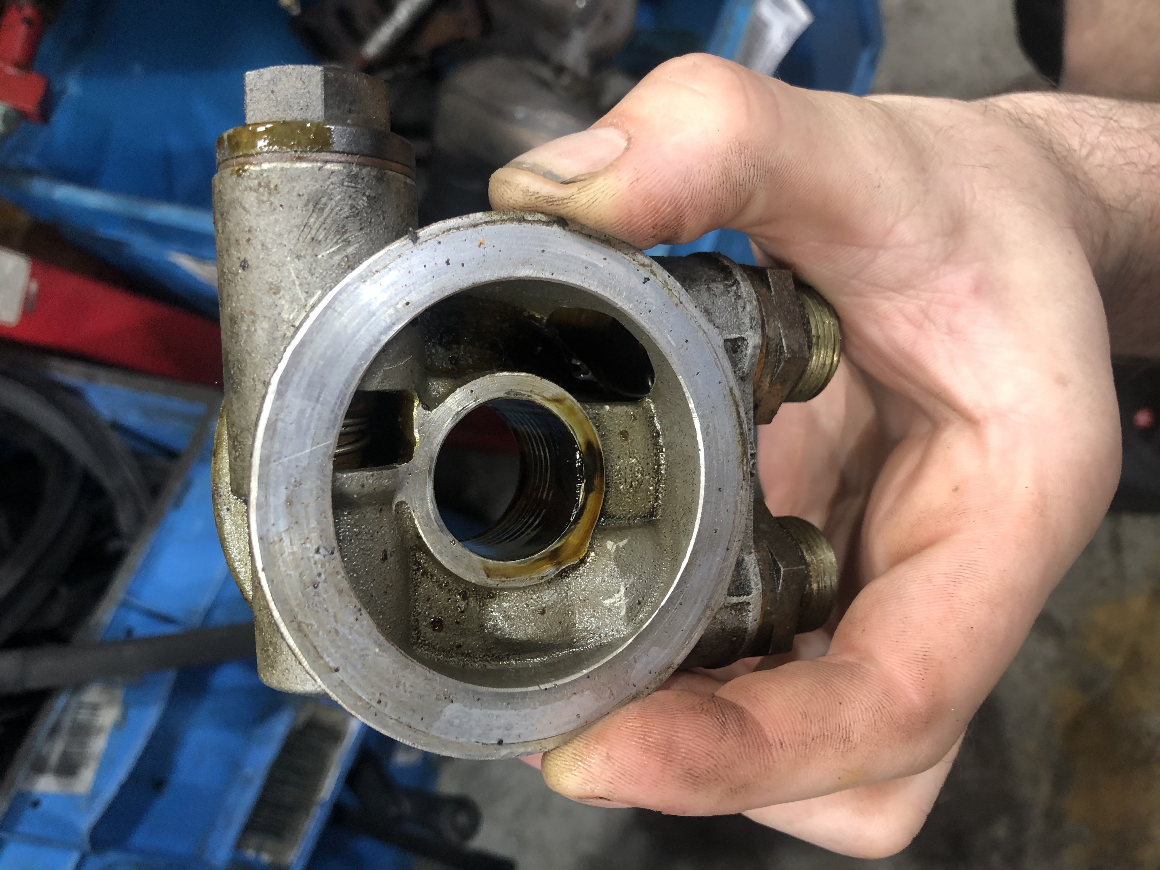

Shopp I cannot answer that in case she sees my response. Needless to say I recently replaced all my suspension.
Still at unit 20. The two main leaks have been cured.
1) Oil filter sandwich plate oil seal.
2) Turbo oil drain pipe again (But still have a very slight weep).
Oil filter sandwich plate copper washer which is NLA (on the thermostat side) below the top bolt on the bottom photo.
Or top right if you enlarge the photo.
Anyone got a spare washer or a complete sandwich plate for sale.
The washer thickness is critical size apparently as it impacts on the thermostat operation
All 4 cv boots done.
Just replacing the rear pdc sensors.
Then heading home.

Post by Shoppinit » Thu Sep 02, 2021 2:19 pm
Hard to believe that a small difference in the thickness of that washer would make any difference to an imprecise thermostat like that, but I'm sure Unit 20 know what they are talking about. I bet the thickness tolerance on the manufacture of those copper washers is around 0.1mm anyway.
What I would do is remove the washer, measure its thickness. Then source the next thickest standard crush washers. So if, for the sake of argument, that's a 22mm OD washer with a crushed thickness of 1.3mm then I'd get a washer that was 1.5mm thick and then tighten the thermostat until the gap is the same, using feeler gauges.
Worst case, you can file down the thickness if necessary, but I bet Audi just picked a standard washer for this application.

Post by Steve2003rs6 » Thu Sep 02, 2021 2:36 pm
Thanks for the good advice Ben.
If all else fails I will have it removed and cnc one.
All depends how bad the weep is.

Post by Shoppinit » Thu Sep 02, 2021 2:47 pm
If you machine one then make sure it's annealed.

Post by Steve2003rs6 » Thu Sep 02, 2021 7:05 pm
That takes me back to my apprentice days !
Yeah will do cherry red and quenched iirc.
Lovely drive there and back.
Christine loves me again ?

:shock: That sounds like a recipe for case hardening.

Post by Steve2003rs6 » Thu Sep 02, 2021 7:33 pm
Hi Ben. Is that not right.
So it must be heat up to cherry red and allow to cool then.
Think I am slowly going senile since retirement.
Lee did a great job on the car. On it all day til 15:00.
She really is driving beautifully.
Will be interesting tomorrow morning and see if there are any drips on the drive. I am hoping that there isn’t any.
To be fair lee had the car running for 40 mins whilst the car was in the air. Everything was dry. So fingers crossed.
