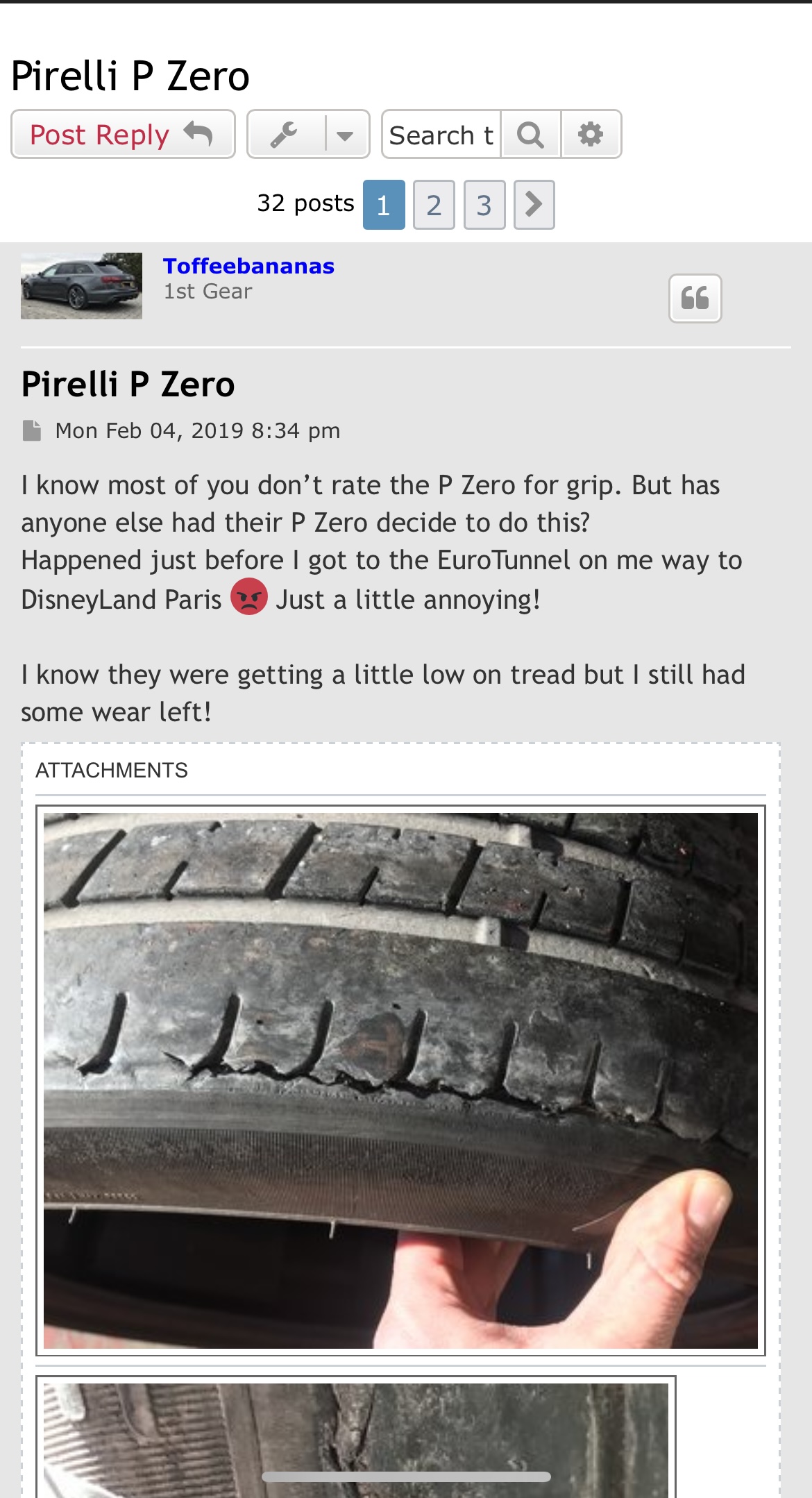

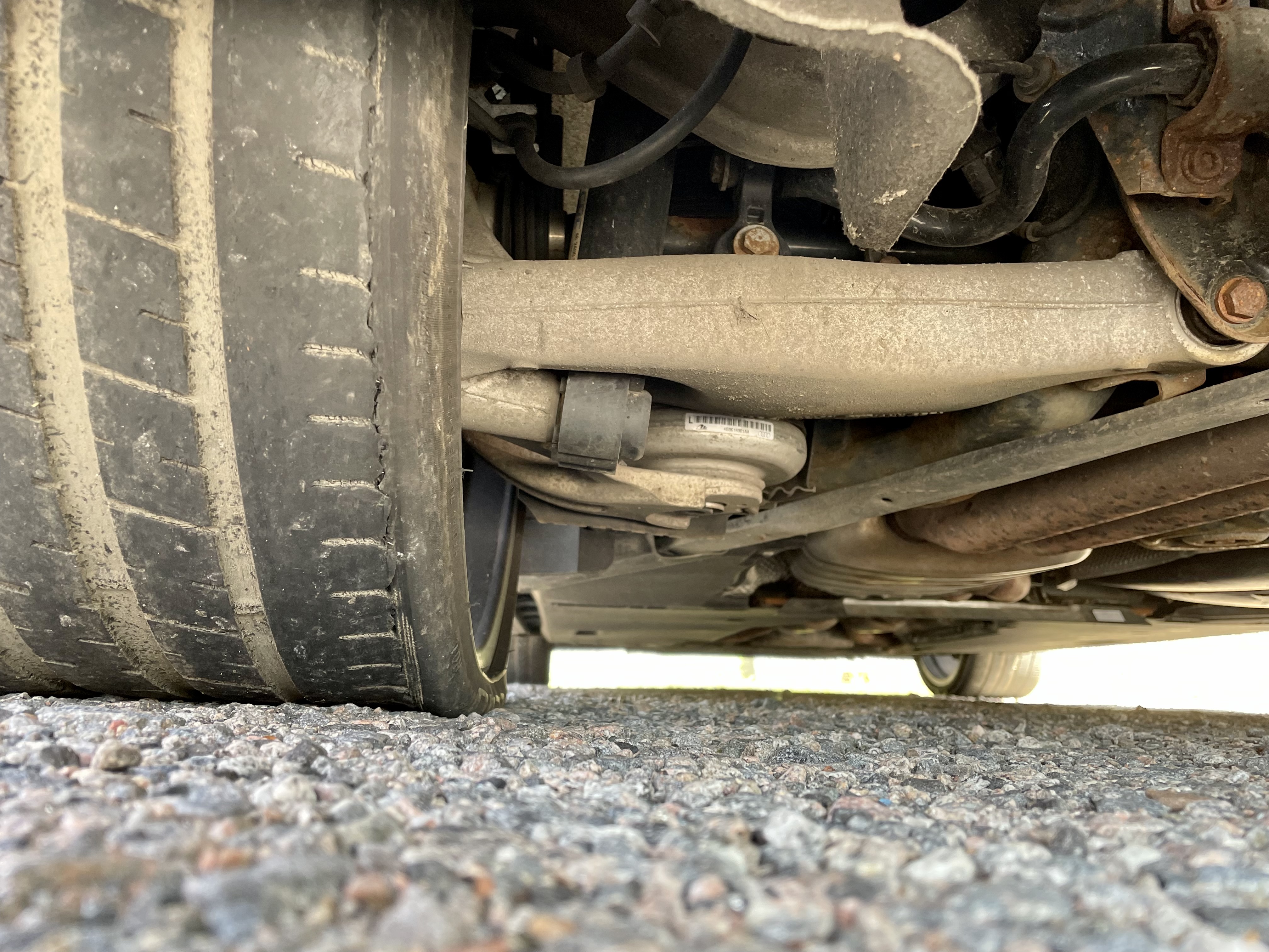

Last weekend I was out a drive with wife and baby and suddenly 10psi on nearside rear, I pulled over and the inside of the tyre was through to the canvas/thread and the tyre wall had split.
Not what I was expecting as the outside and middle tread looked fine.
Recovery truck later and the mechanic pointed out all 4 were showing thread on the inner edge.
4 new Perrelli P Zeros (£1000) later and all good but this could have been a different story if one had a blow out at motorway speeds.
I’m booked in to have the geometry looked at as it is obviously running too much negative camber.
Lesson learned, always check the inside of your tyres aswell.

Or it could be you drive regularly over speed cushions while straddling them along the centreline of the car - that will rip up the inner edges of all four tyres if you do it often enough - and, if you go over them at speed, that can push your alignment out, too, further exacerbating the problem.

But, somewhat ironically, the picture you posted is *exactly* the type of damage done by speed cushions, and not tyre alignment. Look at how the wear indicators are even across the tyre and the inner shoulder is chewed up; if that was a camber adjustment issue, the wear would be tapered across the width of the tyre and you wouldn't see the tearing of the rubber on the edge.

I had the exact same issue on my Alfa. Low tyre pressure warning when doing about 80mph. I slowed down and pulled over the first place that I could but the tyre was already <beep> at this point. These were Michelin PS4Ss. This is a common issue for lowered cars that have no camber adjustment. Being aware of this from previous experience Ion my RS4 and RS6 amongst other cars I checked regularly and had a new set of tyres waiting to go on. I thought I had another few weeks before needing to swap them but still got caught out.
Anyone with lowered cars please check the inside edge regularly. When mine went I still had 6-7mm of tread on the outside edge and toward the middle so a normal quick check wouldn't have shown the issue.
