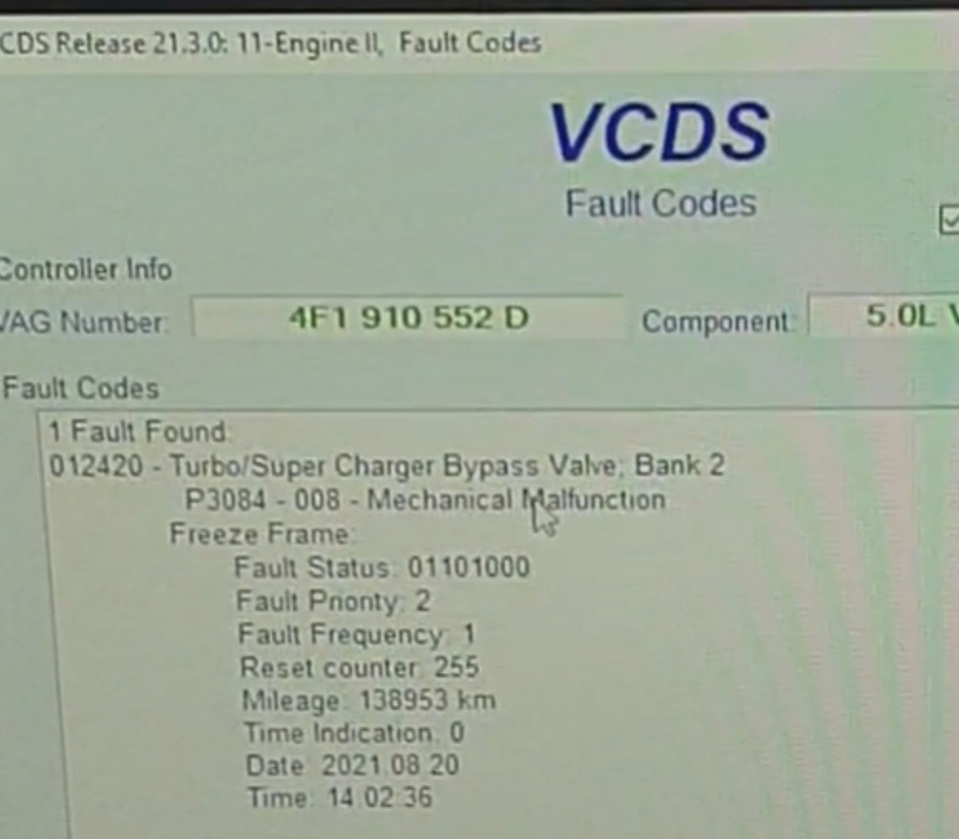

Can anyone shed any light on what the attached photo is telling me, any help.or advice would be great the BV's move freely in the airboxes and the vac lines appear to be ok.
Has anyone else had this code?

https://p3084-audi.autotroublecode.com/
This is all I could find at the moment. I suspect perhaps looking at any vaccum hoses around the diverted valve on bank 2 side?

If we are talking the diverted valves at the bottom of the air boxes (and to be honest, the error could equally refer to the wastegates?) then I think it’ll be a physical problem with one valve or the other. The code refers to a specific side, but both valves actuate off the same solenoid and have a common supply line.
On my car a diaphragm failure on one side caused a vacuum leak that stopped both valves from working. I got a P2261, boost pressure control mechanical malfunction error in that case as neither valve was operating.
The valves can be checked with a cheap vacuum tester like https://www.ebay.co.uk/itm/Hand-Held-Br ... 635-2958-0
A good valve will hold vacuum and you can see it actuate. I ended up replacing the failed valve with a forge motorsport valve, there’s a guide on here somewhere.

Hi BobBobson I've done all the vac line checks today and also the diaphragms and all ok so must be a solenoid, I have also fitted the 2 Forge BV valves today, will refit it all tomorrow and do a test run. Thanks for the reply.

Hi, its a real fault i have cleared it several times but the car flutters like crazy under hard acceleration, no power as such, you can hear air being dumped, drives lovely at low speeds but the issue kicks in at motorway speeds mainly.

I suspect that the fault is pointing at a wastegate actuator rather than a recirculation valve.

Hi Jim, yes that's what I am starting come to terms with, might just be tye N75 valve as the turbos were only redone about 2 years ago, still can't get to that valve easily.
