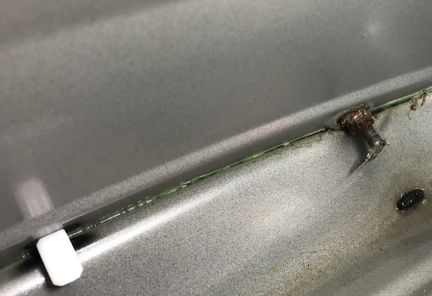

Right, it looks like it's coming in through the aluminium trim strip at the bottom of the tailgate:
Wonderfully, Elsawin says that the trim can't be removed without destroying it.
I don't fancy attempting to get these nuts off anyway:
I'm going to have to have a think about the best way to sort this leak. In the meantime, it's going back in the garage to think about what it's done.
For anyone trying to remove the tailgate trim, *don't* rely on Total Technik video. It's for a boggo A6 and doesn't talk about the sun blind. Plus the one he's using is basically hanging off anyway. Not only that but I was pulling my hair out waiting for him to get to the point. Anyway, this video explains it better and also talks about what I suspect is my problem: failed adhesive:

Hi Ben. At least you found the leak. With your skills I am sure you will find a remedy !
Translucent silicon ?????
A big pain that the trim is so hard to remove with rusted bolts and double sided tape.
Really good how to video. Hope when you get it off you don’t have the same rust problem. That is if you are taking it off. Probably less of a headache if you can devise a in situ remedy.

I'll put a bit of silicone on the inside for now. Haven't got time for a proper fix. It can wait until I do. It would be a different story if the car didn't sleep inside.
