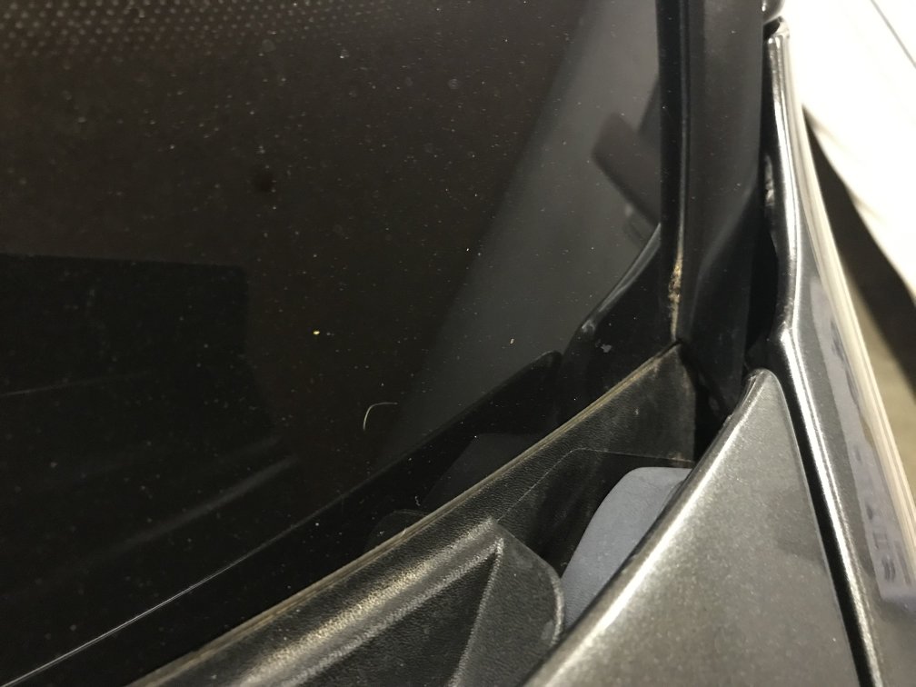

Just a before and after photo

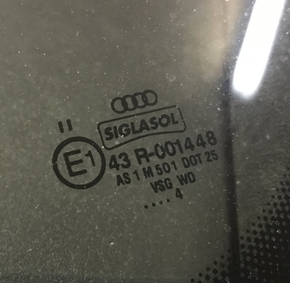

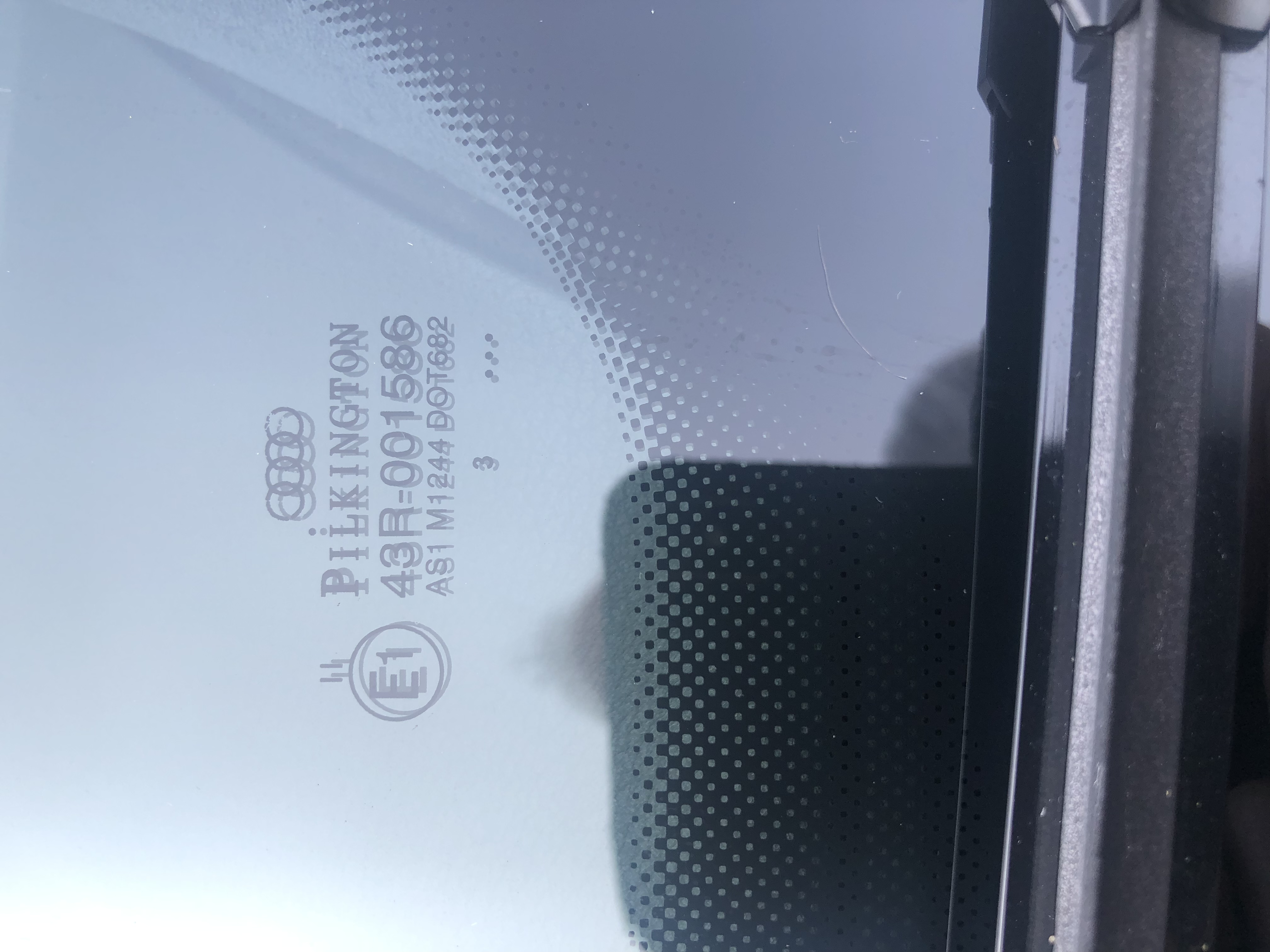

Ric. My crap one was supplied by auto glass.
Correct one should be as the photos.
Suggest you compare the above pilkington photo and part number To the intended screen BEFORE they install it.

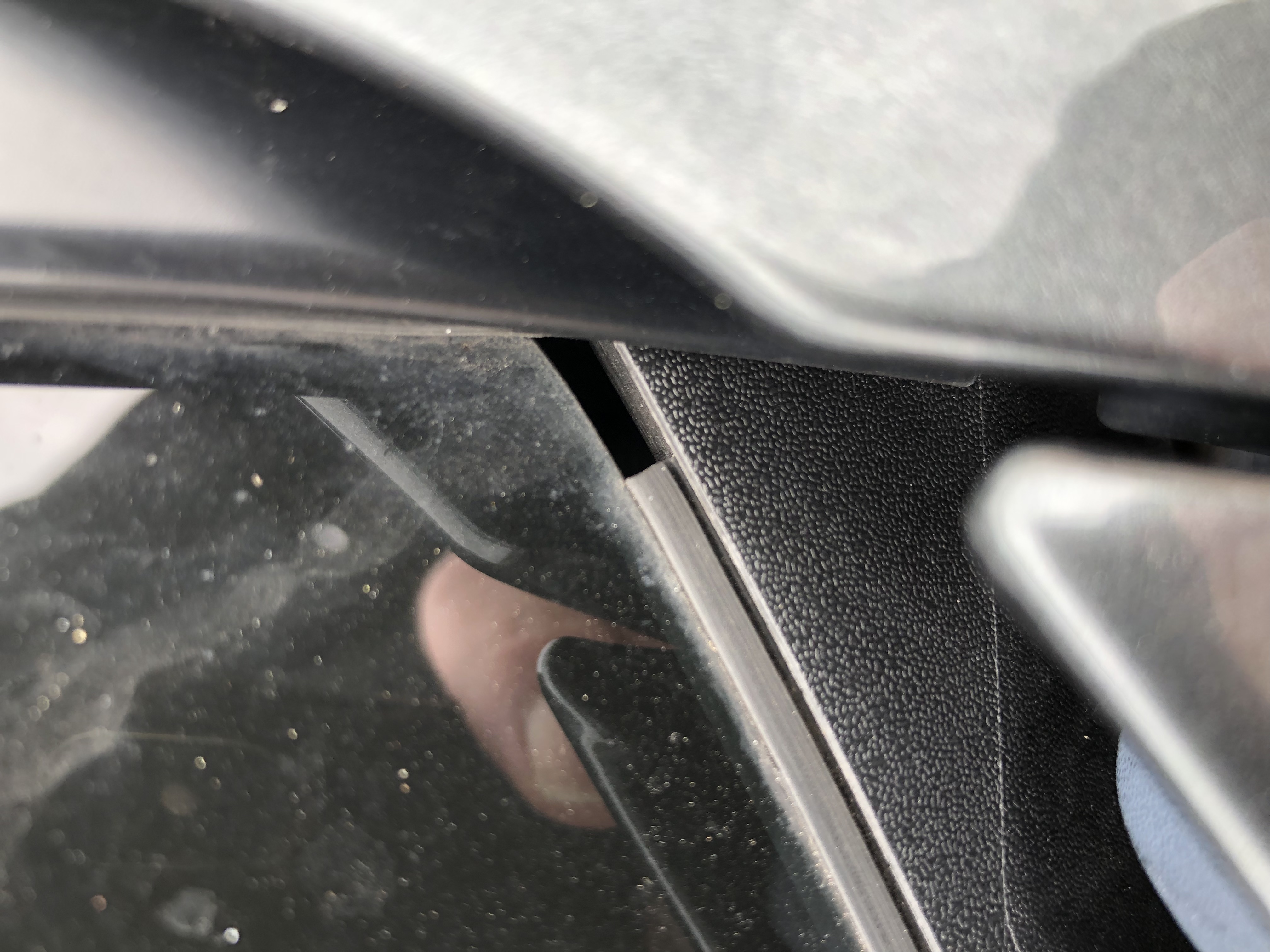

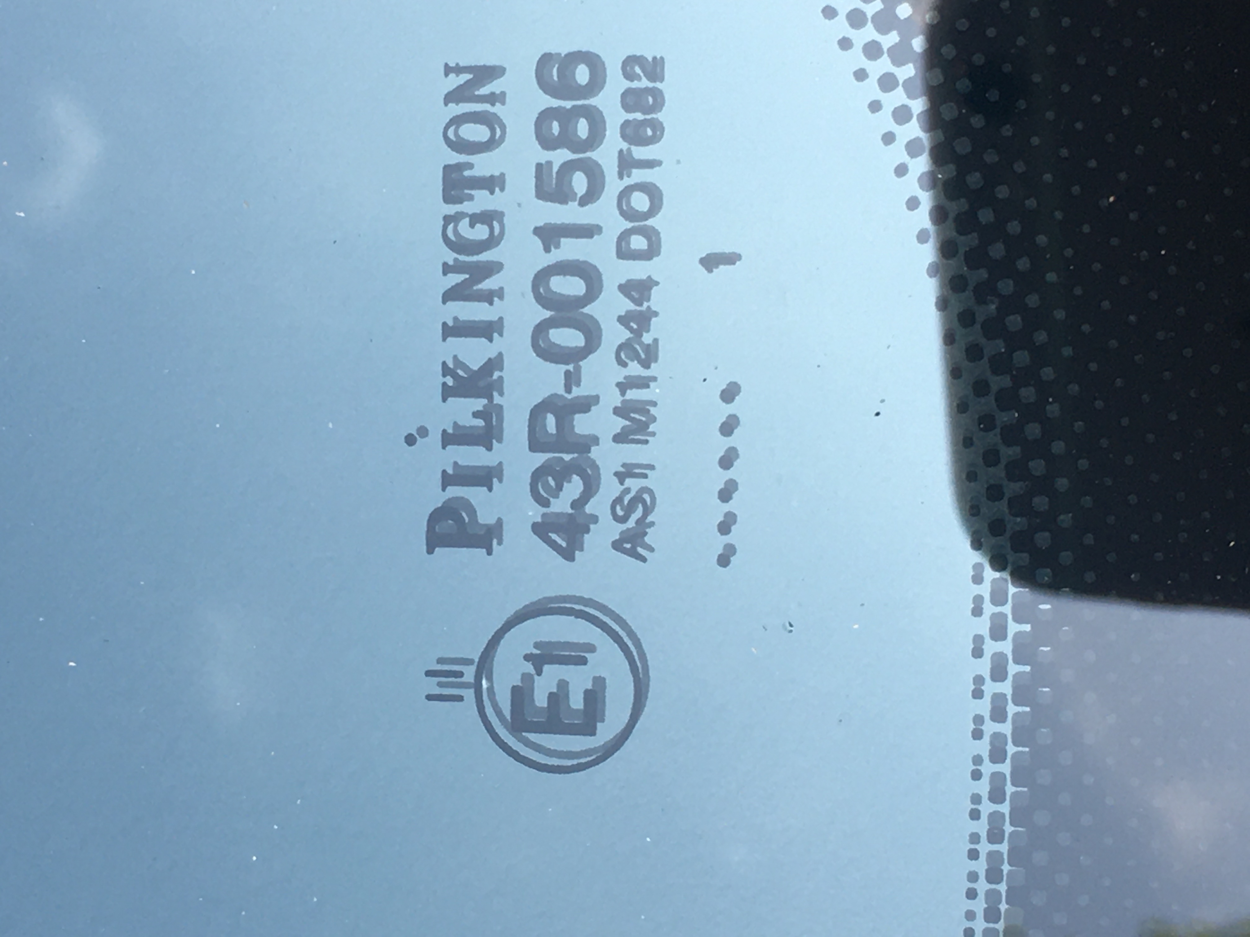

Was pleasantly surprised - seemes Auto Windscreens got it right. (saving final judgement until it rains ) Actually they were very helpful. They get their glass from Pilkinsons.
Unfortunately I wasn't able to there when new screen went in, but model numbers same as Steve's Audi one, the screen which came out was not oem ( must have been replaced before I got it 11 years ago) and had a slight gap at bottom right, but under the trim. Never leaked as far as I know.
Saga (insurance) would not agree dealer supplied screen, but for a £75 excess I'm not bothered about missing
Spot the difference between Steves audi supplied glass top
Auto windscreens supplied middle
Old non oem that was replaced bottom

Nice result ric. Pleased it went well. And yes screen part no the same so you would expect it to be oem.
Agree the bottom picture shows what happens when the incorrect screen is installed with gaps.
Ric the 4 Audi rings etched on my windscreen cost me £100:00 for each ring compared to your screen.
Weirdly I still feel it was good value.

Greg. Mine was from Audi last year.
The one Ric bought was from auto windscreen’s.
Both were made by pilkintons and both screens had the same part number etched on the screen.
I would try auto windscreens first. It was a lot cheaper than audi for what seems like the same screen.
Good look mate. Let us know how you get on.
The above photos also show what it looks like if you get the wrong screen with big gaps at each end.

Re: Leak

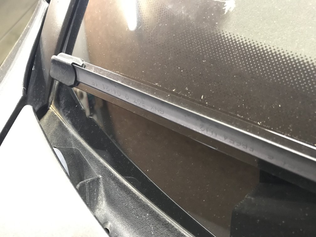

Gents, apologies for the stupid question.
In steves Audi screen picture with correct install i do not see the rubber seal that looks short at the outer edge at the bottom of the screen. Is this just the photo or does this seal get pushed fully into the scuttle panel with the correct screen?
Many thanks..... as I can see that seal on my windscreen.
Steven
Steven

Re: Leak
There is no seal at the bottom edge of the screen.
The plastic water deflector sits in front and behind the bottom of the screen.
The gaps at each end in the above photos are due to the incorrect screen being installed. Not deep enough to meet with the deflector.
Hope this helps Steve.
Ps I initially thought that the plastic deflector was too short. As it gives that impression. Not so. It was the screen causing all the problems.

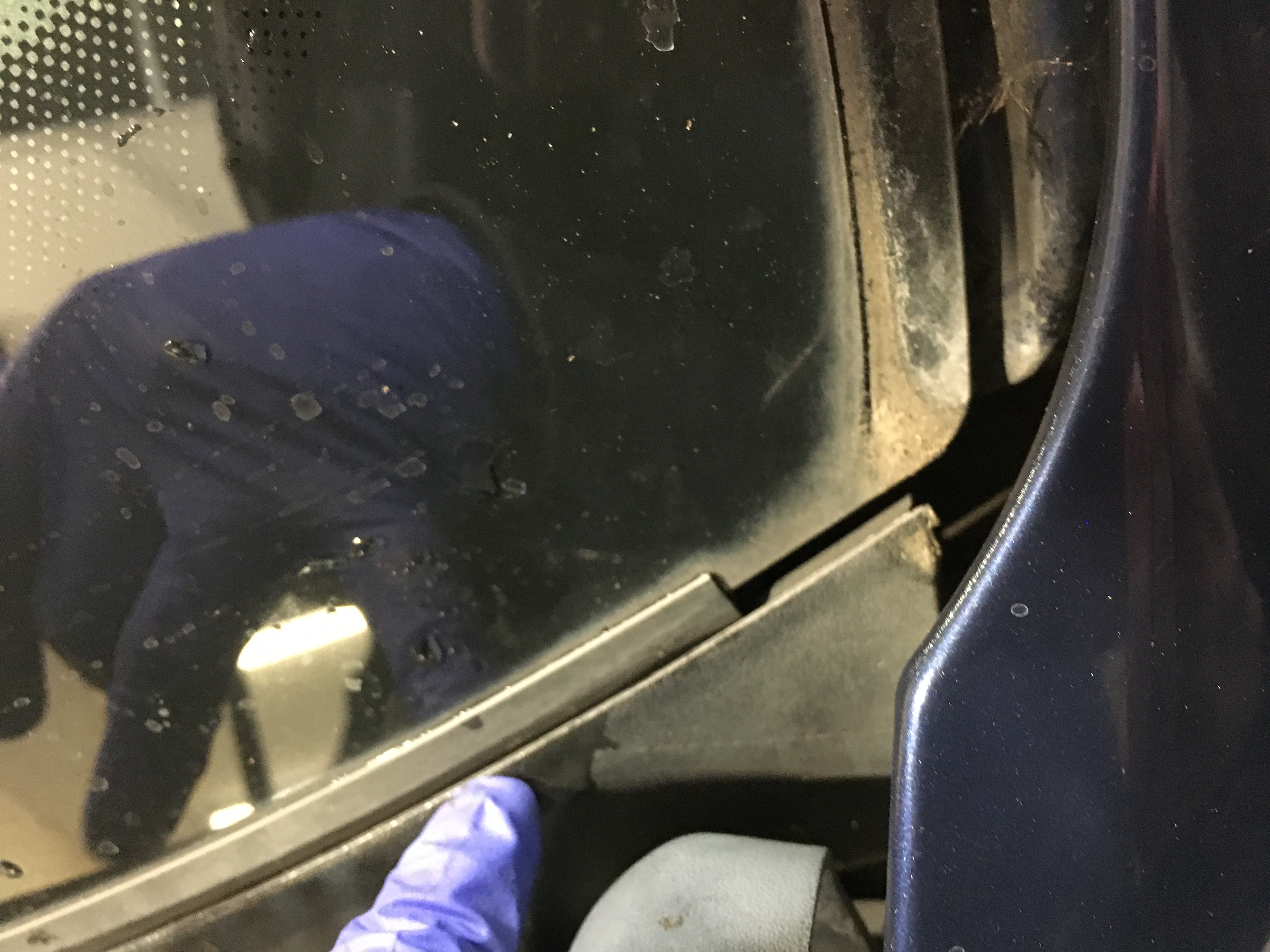

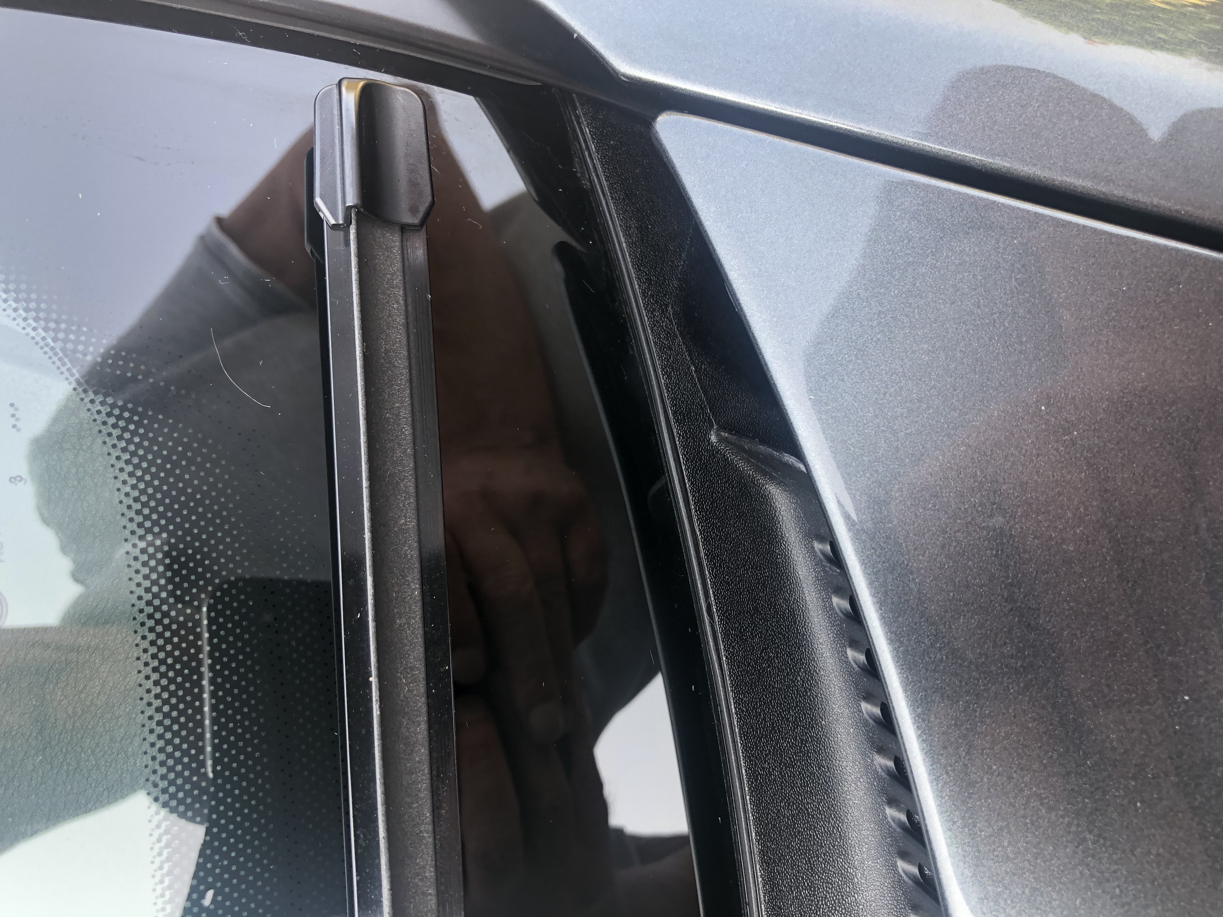

Re: Leak
This is what mine looks like:
