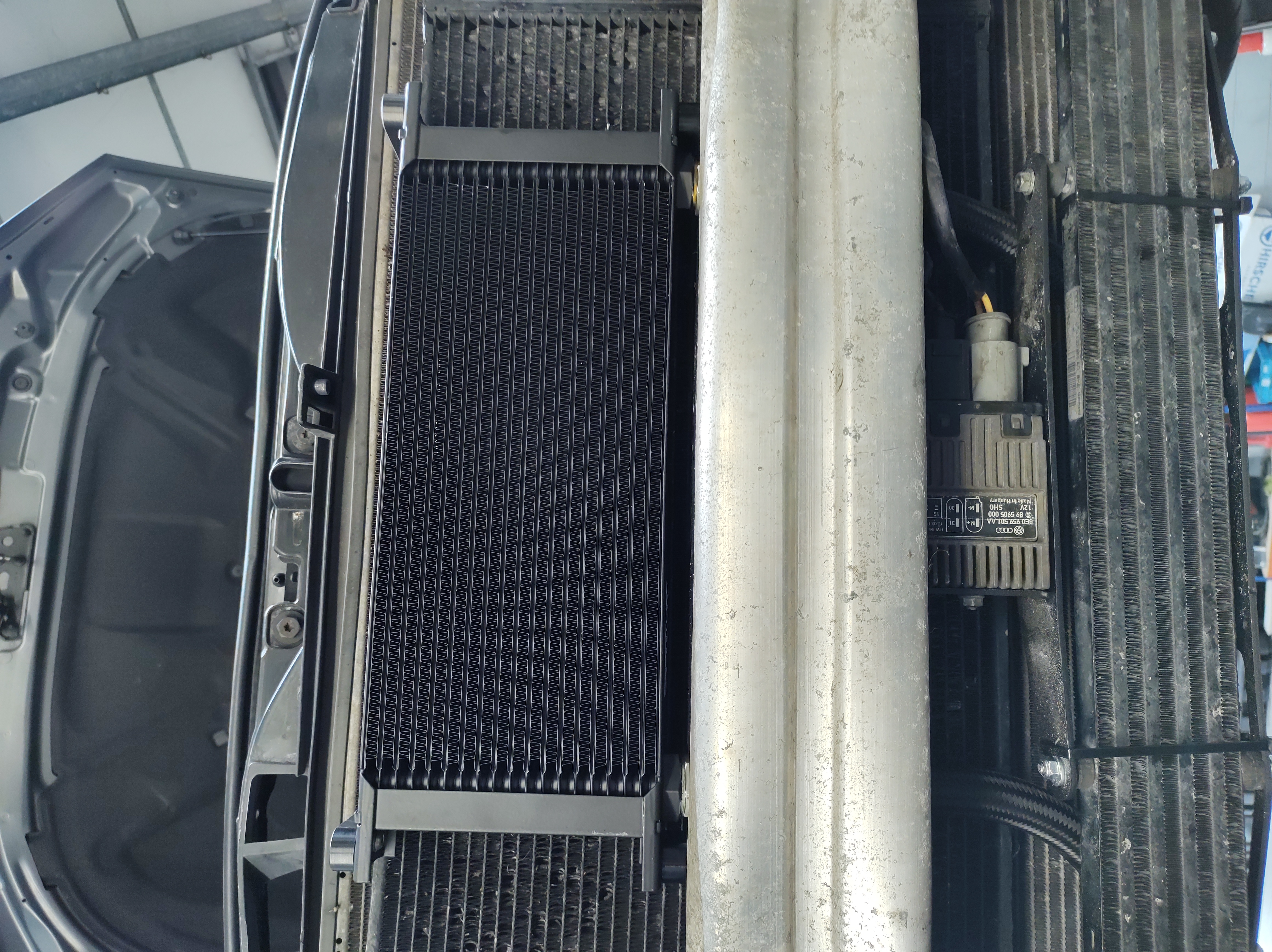

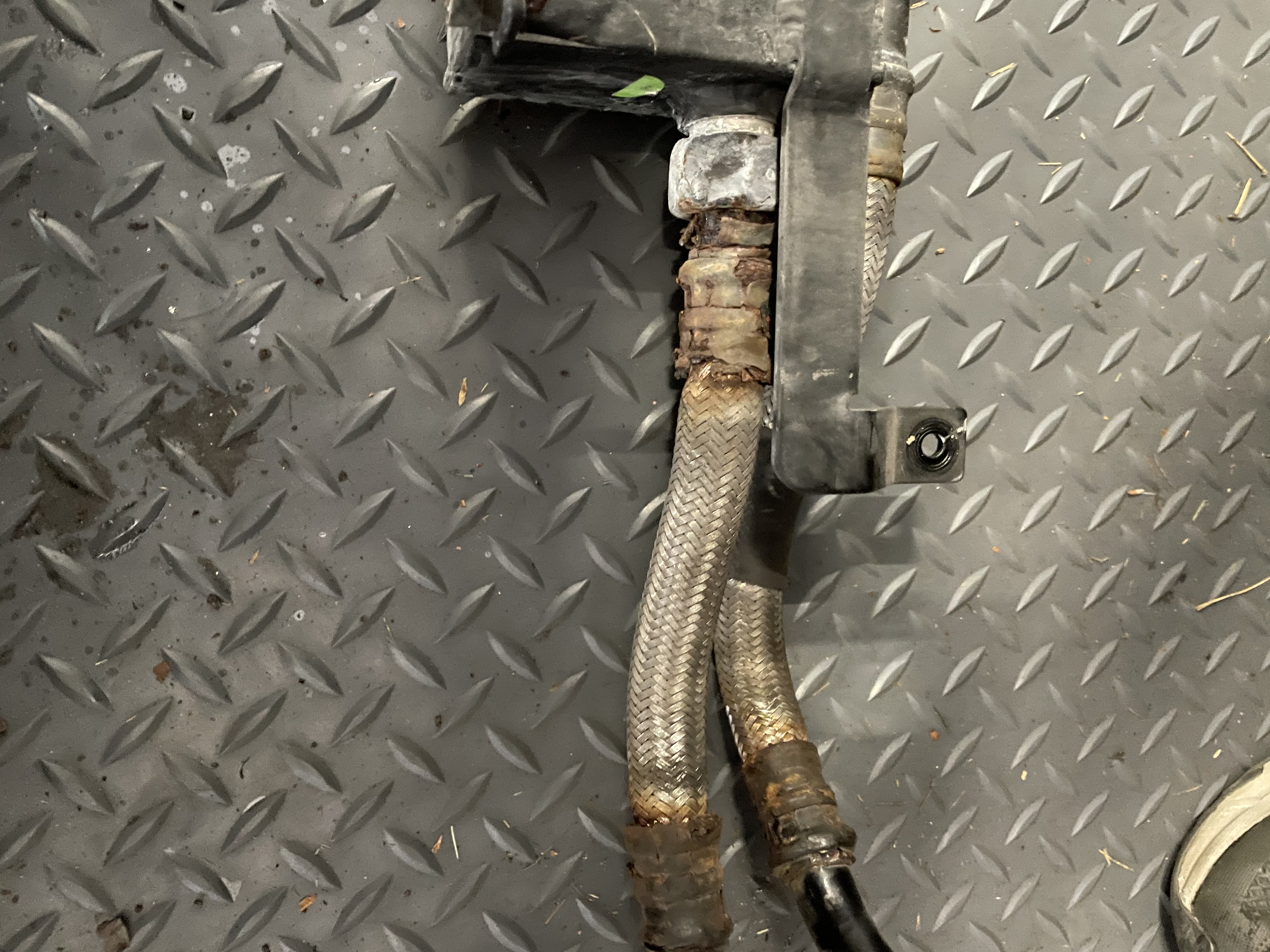

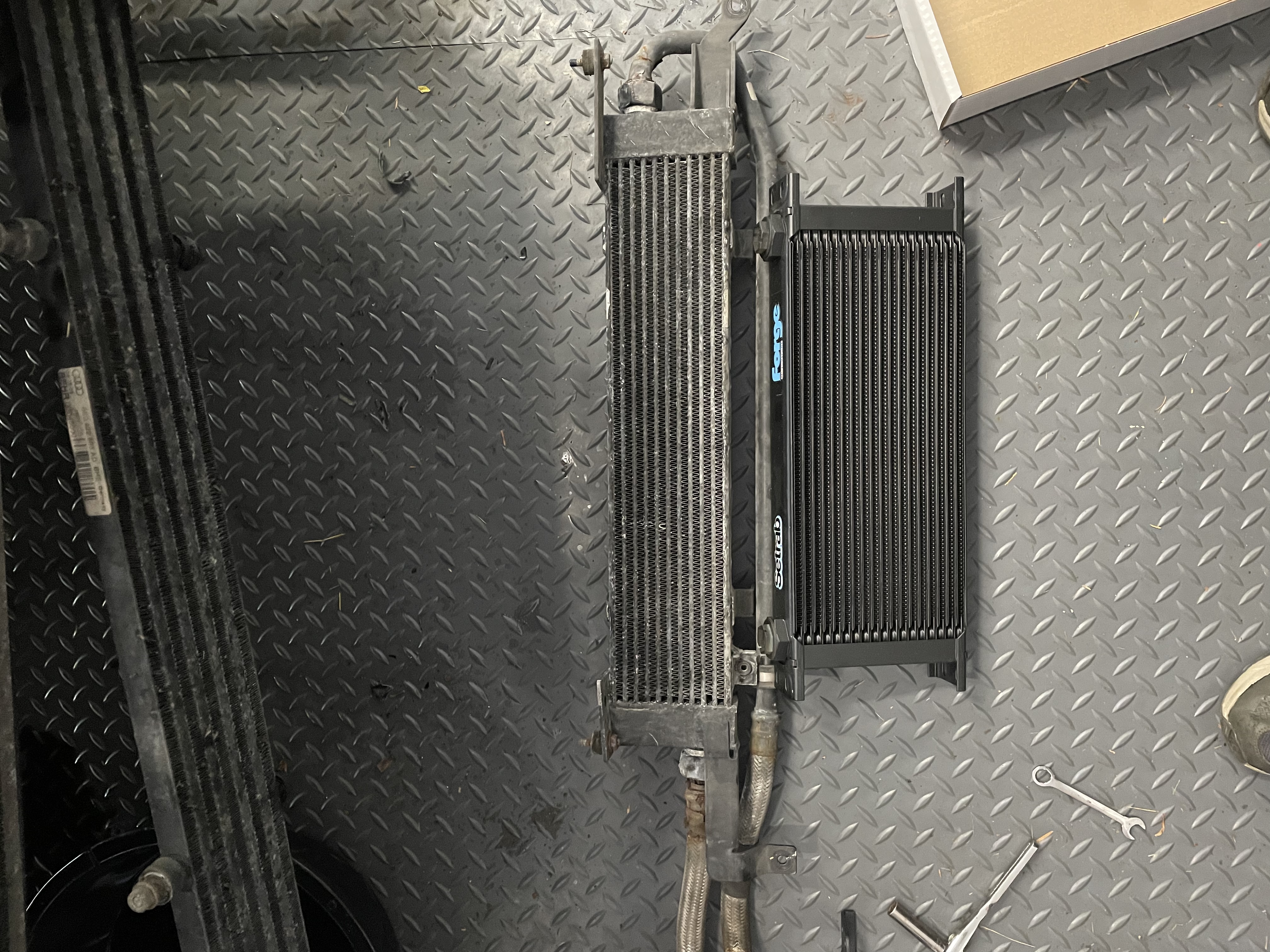

Just fitted the new Forge oil cooler kit, superb quality kit and easy to fit. Performance wise it seems to keep temperatures down a little better than the OEM cooler it’s marginal as the standard cooler does a decent job, definitely brings the oil temp down faster after a good blast. Only issue I had was the old cotton reels to the PAS cooler were knackered- replacements are easily sourced. The OEM cooler lines were 95% rust/dust so looks like I caught it just in time.

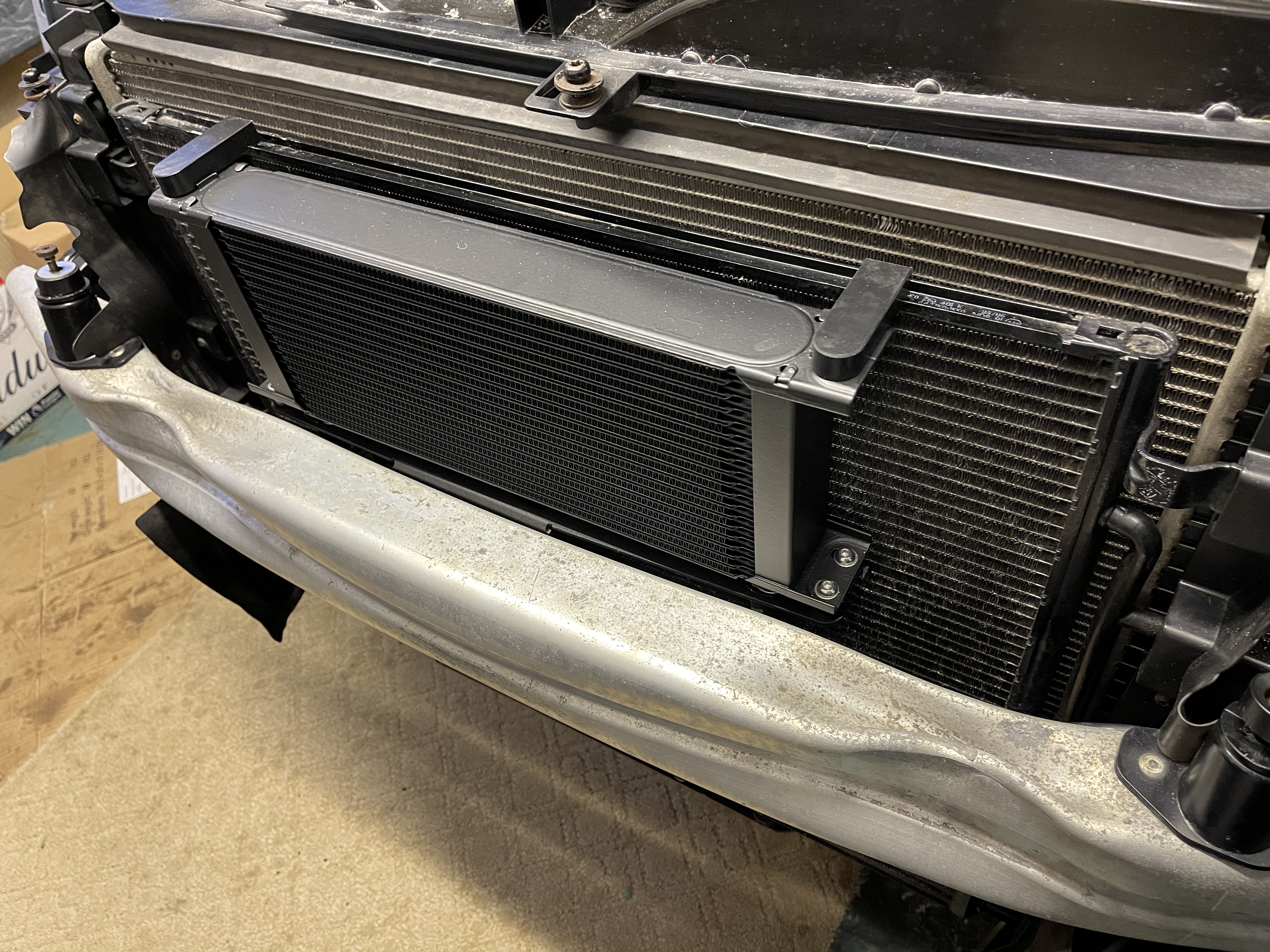

I've had mine done in the last couple of weeks. My cooler/pipes weren't too bad but had been on the car 7yrs or so. So far very happy with the Forge kit
