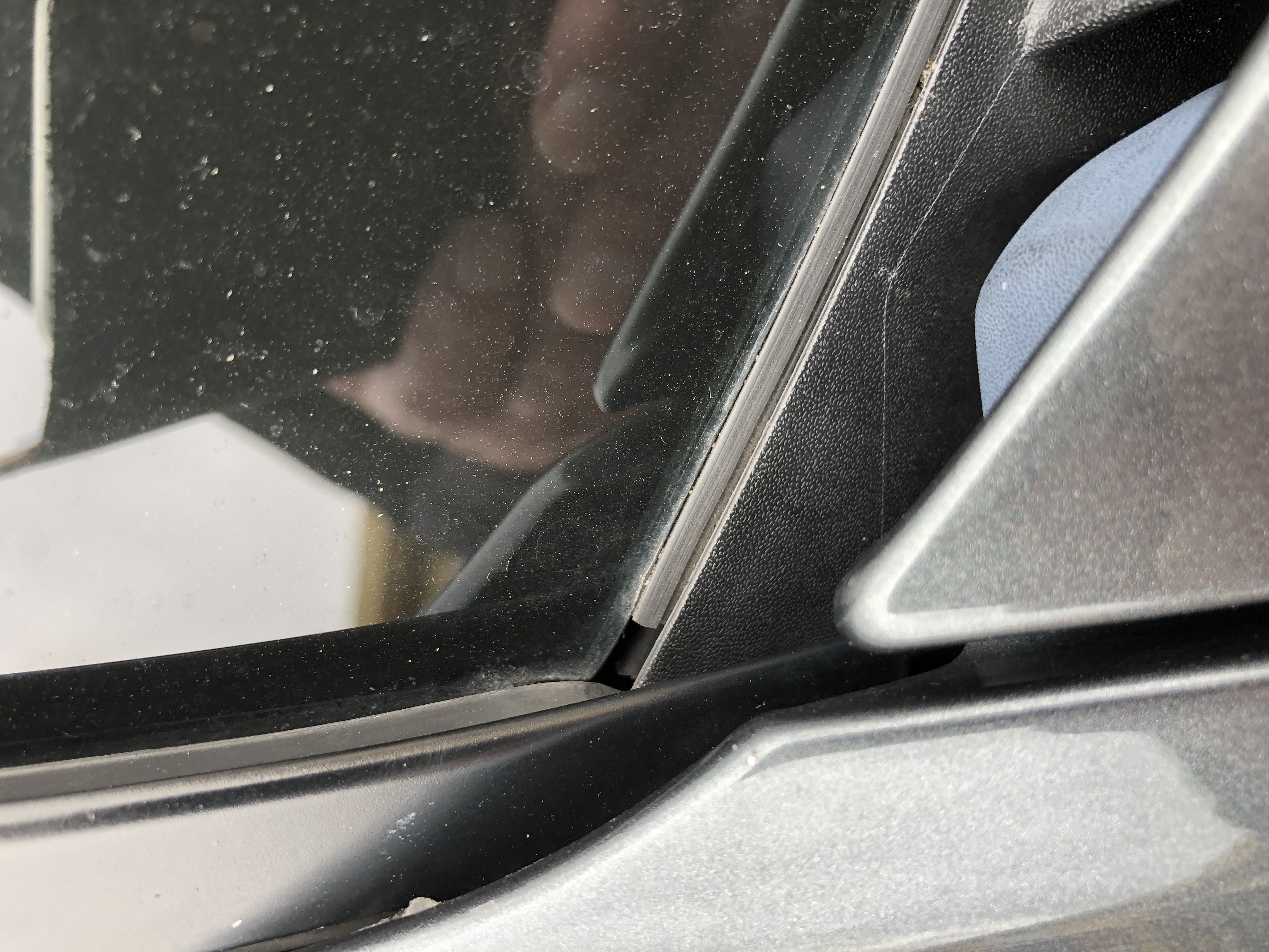

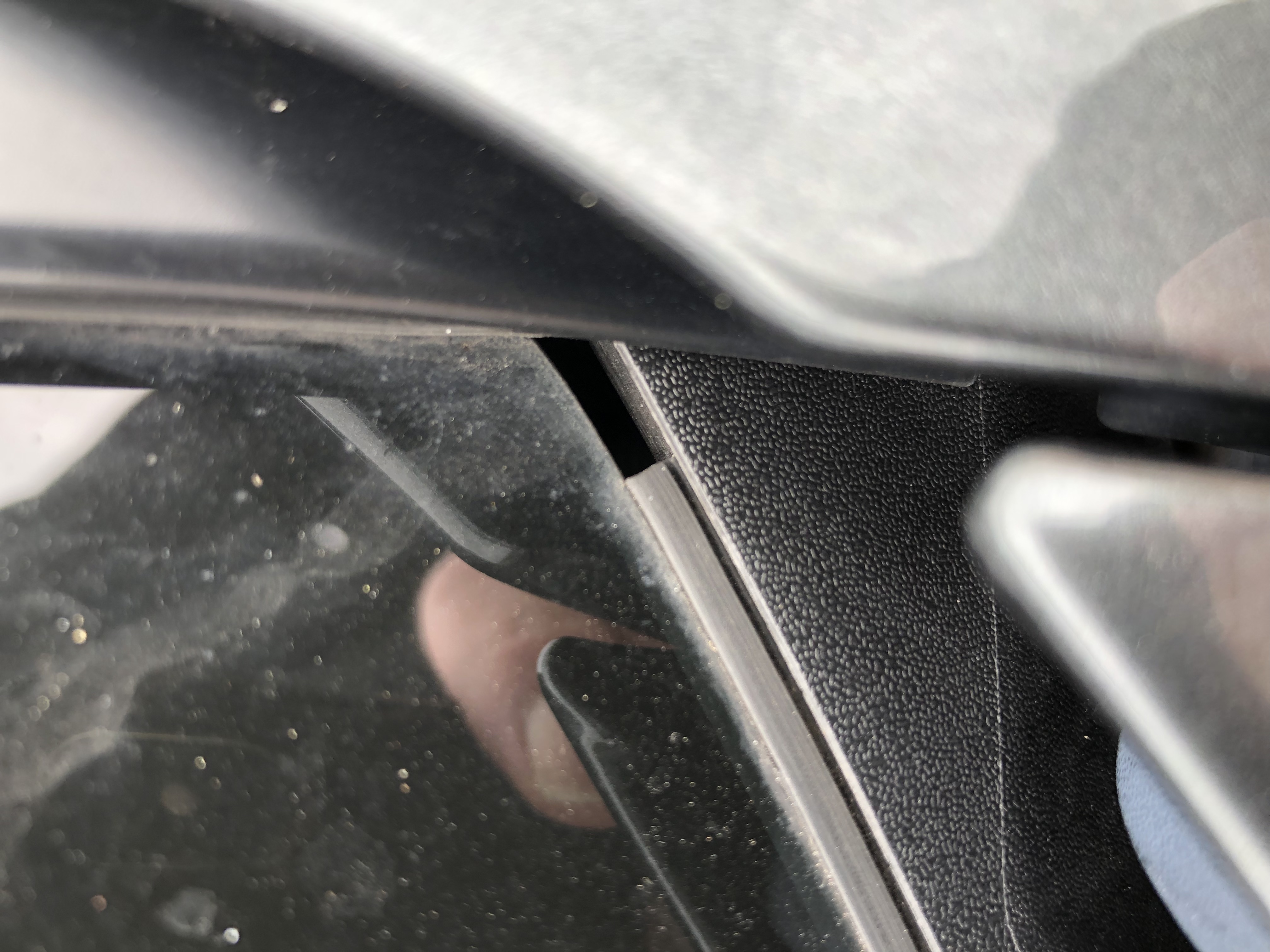

About half inch gap each side.
Tap on the photo to turn it the right way up.

Re: Leak
I am wondering if it’s the water deflector thats too short. It was supplied by my local AMD.
Or is it the windscreen that’s too short.
Would love to get to the bottom of this.
With my original screen and deflector. I never had a gap at each end.
Re: Leak
I reckon it's the deflector seal. IIRC the deflector on the screen I measured looked like it was too long for the bottom edge i.e had an allowance for trimming.steve2003rs6 wrote: ↑Sat Jul 03, 2021 1:26 pmI am wondering if it’s the water deflector thats too short. It was supplied by my local AMD.
